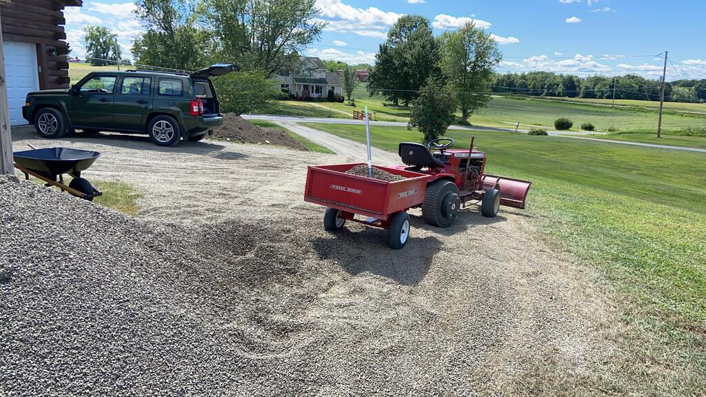

Reddart 207 #7 Posted August 23, 2020 Got ‘er done. My neighbor with a 100+hp New Holland tractor with a bucket loader helped me out a bit this morning by moving some of the pile down the driveway, but was very satisfied with my C101’s performance. 3 3 Share this post Link to post Share on other sites
