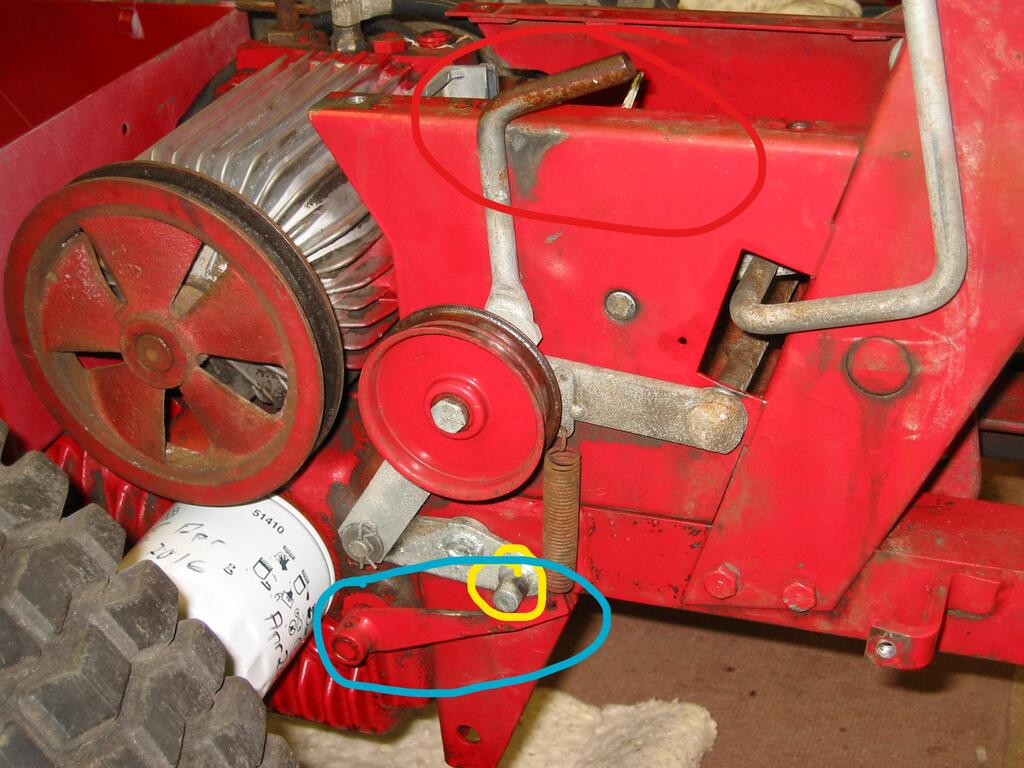

When you look at her as you pull the engage lever up (red circle) make sure the parking brake arm (blue) moves and goes back when you lower the engagement lever.  Also look at the bottom of the pin (yellow) The brake arm can wear a groove in the pin so it doesn't move the brake bar as far as it should

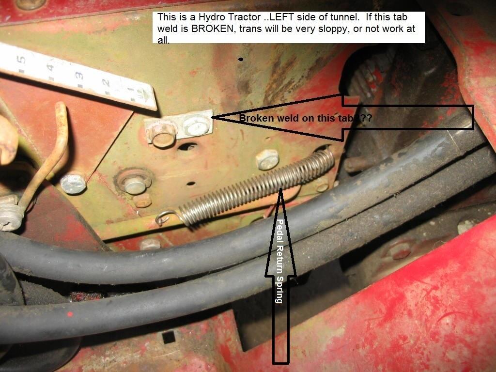

My comment:  With the Parking Brake lever DOWN, pushing the motion control lever forward / back should cause the tractor to move in that selected direction. If not, then I would first suspect that the Friction Control Rod TAB Weld may be broken on the left side of the Hoodstand...it may look like this:  (NOTE...this pic also shows how to replace a broken return spring with an external fix.)

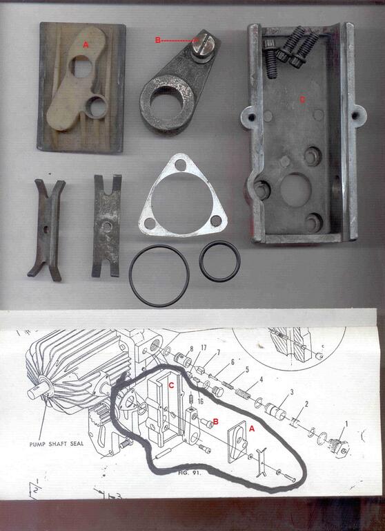

So many things could be wrong:  Broken weld on tab as I mentioned, wrong belt, missing or worn-out control linkage involving the Parking Brake Pawl (pfrederi), or something with the Cam & Follower..(A and B.)...  they often wear out.  OR... Maybe a broken frame plate.
Look at the frame where it bolts to the transmission...under the tractor.  VERY often this plate is cracked or broken and that will lead to many issues...must be fixed.
