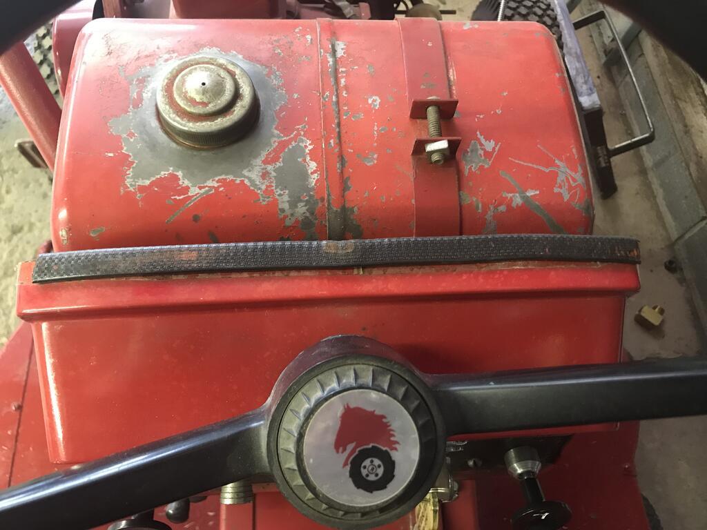

JAinVA 4,629 #4 Posted August 15, 2020 (edited) You can also use car door edge protector. It comes ready to apply,is inexpensive and comes in a variety of colors.The front edge of the black hood has a red door guard section applied.It is a little faded from the sun but still does the job. Edited August 15, 2020 by JAinVA 3 1 1 Share this post Link to post Share on other sites

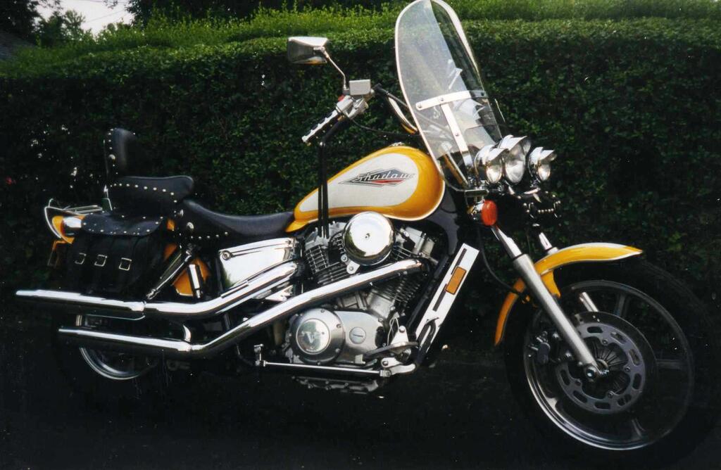

D_Mac 9,034 #12 Posted August 28, 2020 I use door edge guard for a lot of things. I buy it in a big roll. When I had my bike I wrapped both fenders, the gas tank, and the edge of the windshield with it. Looked great and lasted forever. If you look close on the picture you can see it. 1 1 Share this post Link to post Share on other sites
