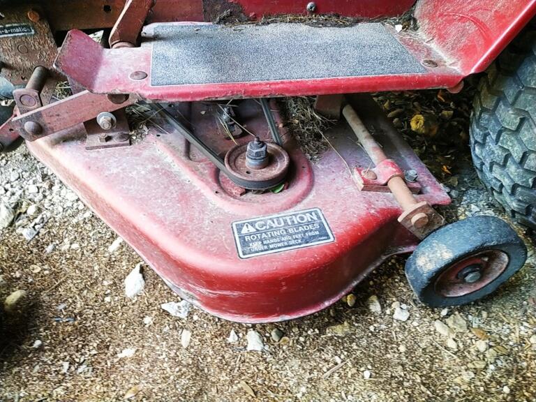

The blade drive sets up an awful howl when engaged, it seems just a matter of time until the end is near.
Also, with my last mow in higher grass, I was experiencing some significant belt slippage from the blade(s) drive
1) can anyone help me identify my mower so I can get replacement bearings and/or pulley bearings for the blade drive
2) Is there any sort of tension adjustment for those blade drive belts?  I can't seem to find any reference to that section of the mower in any of the online documents I've found

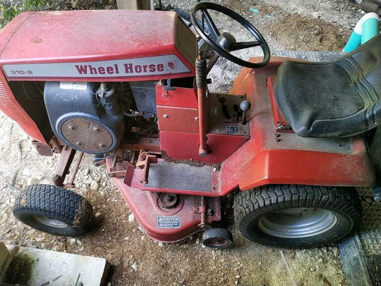

That model number would be for a Murray.  You have some sort of "Frankenhorse"  Post a couple pictures so we can help you figure out what you really have...
phil auldridge

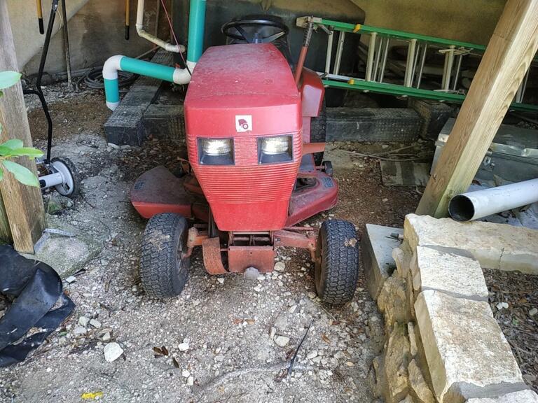

Here are pictures of my Wheel Horse, er  Murray?  Any assistance will be appreciated
I pulled up parts diagrams for the Murray model sticker I found underneath the seat (supposedly a 1999 model), but I don't believe that is the mower I have.  The Murray has the gear shift on the left side fender, discharge on the left, and 2 blades.  My unit has center shift under steering wheel, 3 blades, and discharge on the right.

pfrederi
Looks like a 310-8  Where did you see that Murray model #??
Look at the silver stickers on top of teh engine shroud Should have a Kohler Model Spec# and serial ##
310-8 with K series Kohlers are from 1985/86
1985 Parts manual for your tractor is here
pfrederi
Deck appears to be 36: Rear discharge  maybe 05-36MR03
