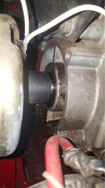

Hi members,
looking at picking up my first red tractor this weekend, but the owner has discovered and disclosed what appears to be a leak behind the "brake drum" which is just behind the PTO clutch. Photo shows oil pooling at the bottom of the drum.  Looks like seal 253-44 could be the culprit.  I'm guessing this is a relatively easy fix, but if you have done this or have expertise/advice to share, I'd love to hear your thoughts before I make a deal.  Thanks!

7443 is the CR/SKF replacement brake shaft seal at your local bearing and seal supplier for the transmission.
I don't see a brake drum in your picture. Looks more like the front of the engine.

Thanks Garry.  I’m going by the name as shown in the parts diagram. (Actually, it’s listed as “Drum - Brake” ). You are correct that it is indeed in the front of the engine, on a shaft that connects to the PTO clutch. Looks easy... hoping I’m right!
