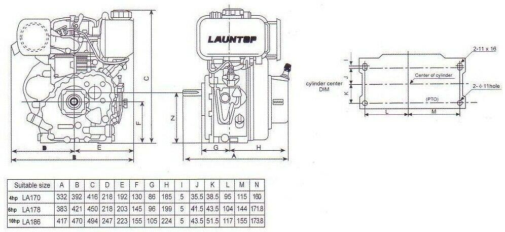

samurayycam 2 #106 Posted May 21, 2022 (edited) On 8/4/2020 at 10:29 PM, Dan.gerous said: I have been thinking about converting one of the C125's to a diesel to take advantage of the fuel on the farm and just a general update for one of the machines. There are a couple of posts on here about similar conversions, but was interested to know if there is a near plug and play replacement for the Kohler 301. What sort of output shaft would be required - I presume the length would be fairly crucial as would be diameter to be able to take the existing pulleys/PTO. Not interested in stupid power, figured a 10hp Diesel would be sufficient to replace the existing unit, and keep it air cooled for simplicity and package size. Found these at a great price, I appreciate they are cheap Chinese rip offs, but might be worth a punt: https://www.westbankwholesale.co.uk/LA186F1E-10Hp-ELECTRIC-START-DIESEL-ENGINE-REPLACES-YANMAR-L1001 If you find it on Fleabay you can get the engine external dimensions which are very similar to the Kohler. Roughly the Kohler is 45cm high x 28cm wide x 45cm deep. The Chinese unit is 49cm high x 33cm wide x 47cm deep - it would easly fit in the engine bay without the shaker plate. Would it be difficult to wire it in? Seems to me that so long as I can get the drive shaft lined up and the pulleys to fit that it shouldnt be a huge project....or am I being overly optimistic? Thoughts appreciated, just thinking about it at the moment but it might just be worth doing - be nice to not have to mess around with spark plugs, coils and condensers - especially as at the moment having issues with these on my latest aquisition! I'm thinking the same thing after the gas hikes. I will be following the thread. Thank you. Edited May 21, 2022 by samurayycam I forgot to say thank you. 1 Share this post Link to post Share on other sites

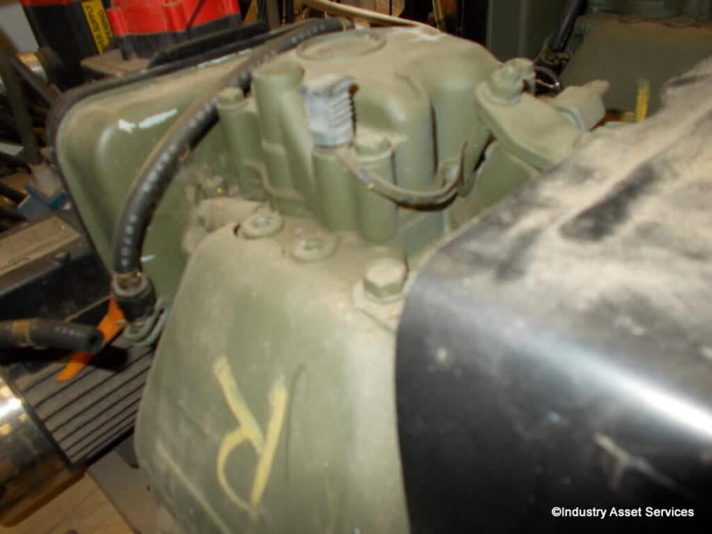

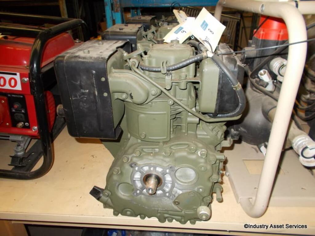

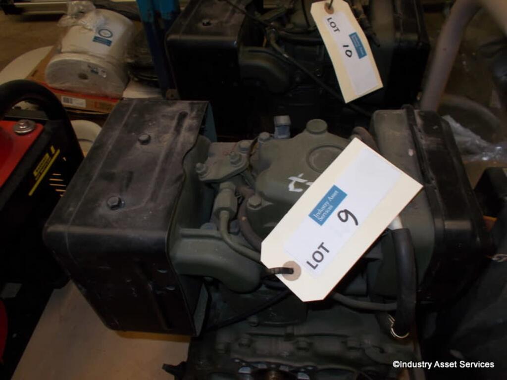

Dan.gerous 2,696 #108 Posted May 24, 2022 (edited) YES!!!!!! Finally got an engine.....err well two of them actually Not sure if they are the 7hp or 10hp models though. It was a gamble at an auction. Two unused Yanmars for £140 each was worth the risk. The world's second longest project after @ebinmaine Super, super, super happy!!! Edited May 24, 2022 by Dan.gerous 2 3 Share this post Link to post Share on other sites
JoeM 7,924 #109 Posted May 24, 2022 sure resembles the clone I used. 1 Share this post Link to post Share on other sites
Dan.gerous 2,696 #110 Posted May 24, 2022 (edited) 59 minutes ago, JoeM said: sure resembles the clone I used. Be interesting to see, must be a capacity stamped on them somewhere. These were the ones listed as Yamahas, which are in fact Yanmars unless I'm mistaken. Hopefully pick them up on Friday, it's about a 9 hour round trip. Edited May 24, 2022 by Dan.gerous Share this post Link to post Share on other sites
Dan.gerous 2,696 #111 Posted May 24, 2022 Wonder why the military remove the ID plate? Share this post Link to post Share on other sites
JoeM 7,924 #112 Posted May 24, 2022 6 hours ago, Dan.gerous said: Wonder why the military remove the ID plate? maybe? The clone was 10hp 1 Share this post Link to post Share on other sites

Dan.gerous 2,696 #120 Posted May 28, 2022 Well.... Back home after yesterdays trip, but sadly it was a gamble that didn't pay off. The engines are the smaller ones - need to do a bit more research but I think they are about 4-5hp. Devastated, but its not the end of the world. Will have to get them back up for sale and see what I can make, they are the sort of thing that might power a small cement mixer or generator rather than a garden tractor. Going to mope about the place for the rest of the day, had been expecting to be doing fun stuff like measuring up for mounting holes etc Back to the drawing board! 1 Share this post Link to post Share on other sites
