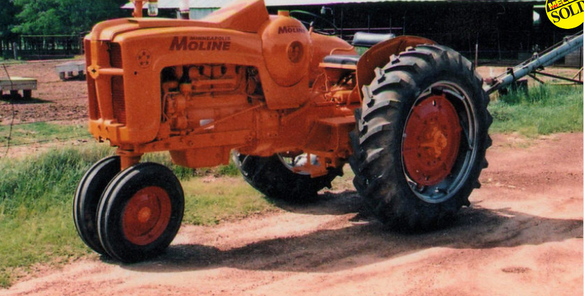

Now if your friend is doing this tractor as a show n tell piece, for simplicity I would suggest a row crop style axle and steering using an orbital steering motor.
Personally I think his old Toro would look good as a Row Crop.
This Minneapolis Moline is good example.

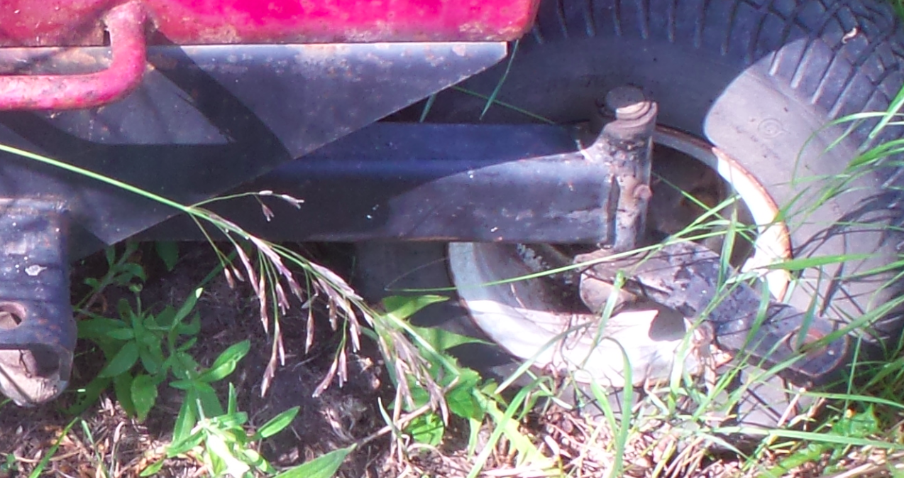

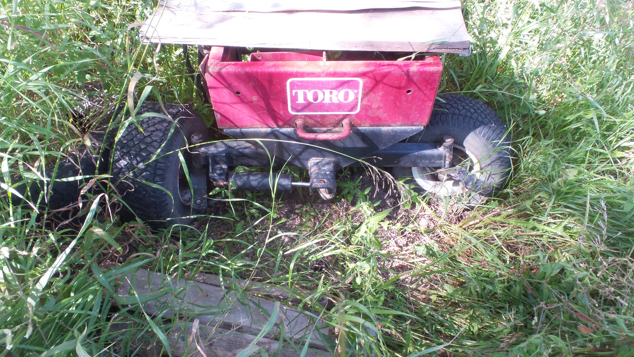

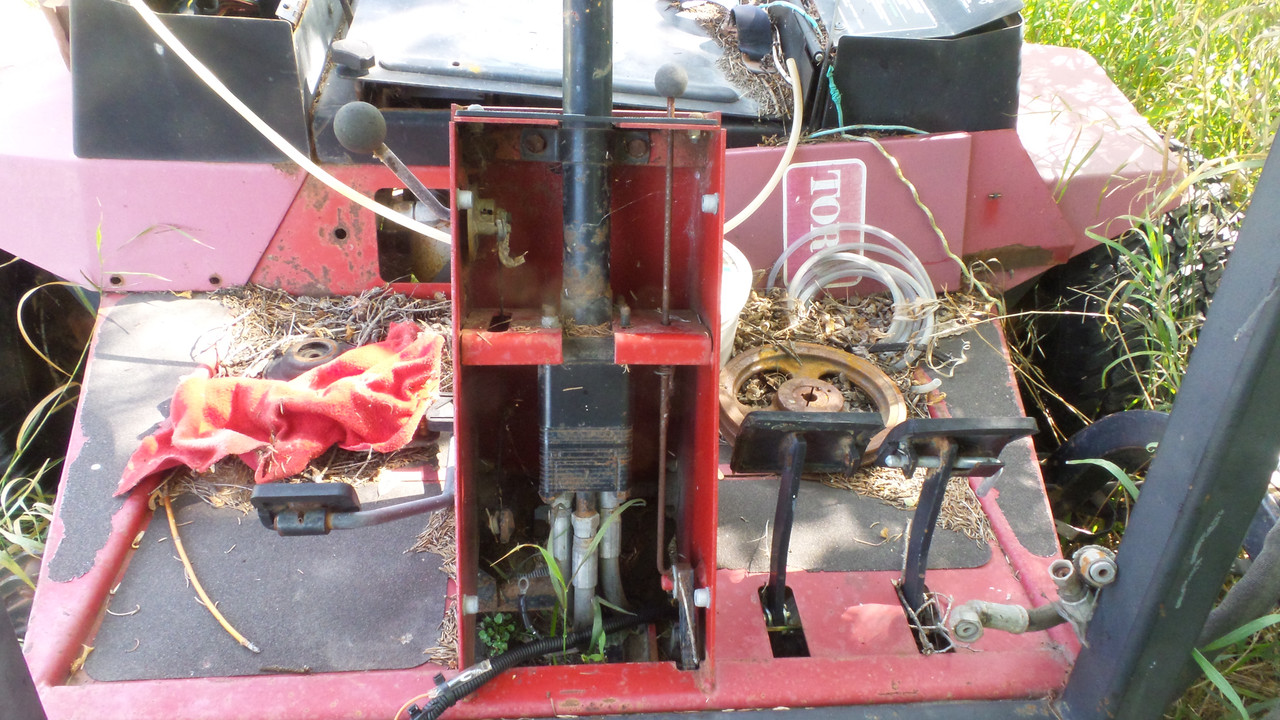

bc.gold
My Toro, with orbital controlled power steering.
In the last image you can see the seam where the two halves of the axle were welded together,

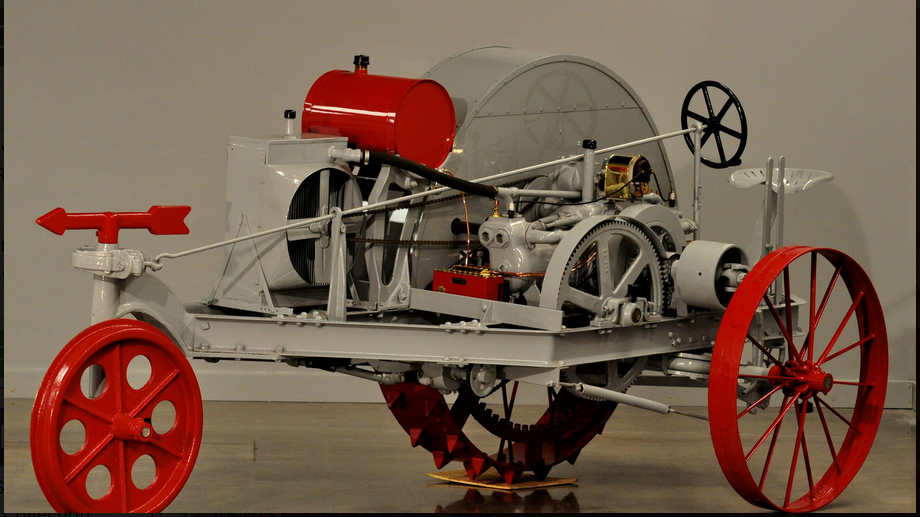

Interesting history, the Bull Tractor Company and the birth of Toro
