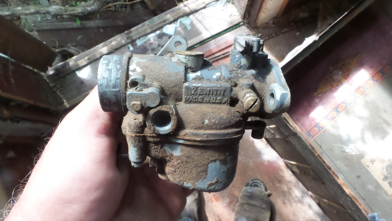

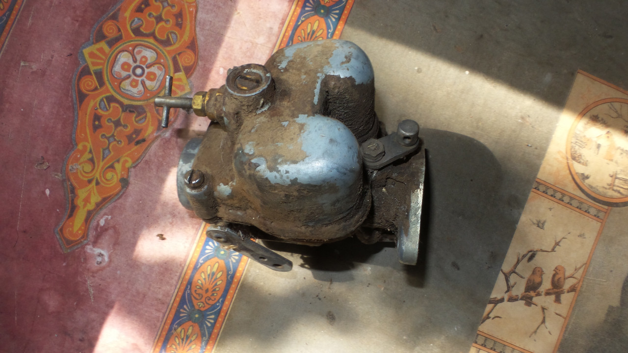

bc.gold 3,403 #1 Posted July 27, 2020 Not sure what it came off of but with that cable connector to operate the throttle my guess would be a very old chainsaw. 3 Share this post Link to post Share on other sites

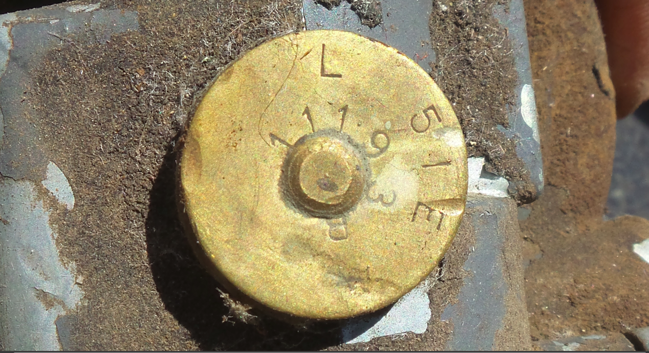

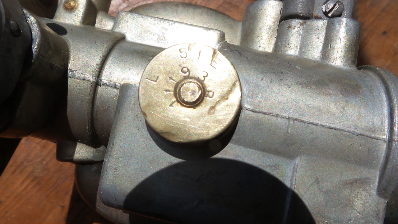

bc.gold 3,403 #2 Posted July 27, 2020 Numbers on the brass button identify this carburettor to fit Wisconsin BKN & AKN engines p/n L51E, L-51-E. Type 87BE Model 87 1 Share this post Link to post Share on other sites
Stepney 2,350 #3 Posted July 27, 2020 Almost 110% it's off an old Wisconsin.. have to check the numbers actually that may be the exact one I'm looking for. Check out a Wisconsin AKN. 1 Share this post Link to post Share on other sites
Stepney 2,350 #4 Posted July 27, 2020 You beat me to it. Yep thats it. You should find that the 'cable' eyelet is actually a small fine thread. I have a Marine inboard BKN and all that remains of my carb are two little ears that once held it to the block.. apparently someone decided the carb made a nice grab handle. 1 Share this post Link to post Share on other sites

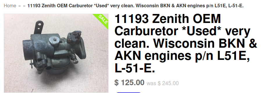

bc.gold 3,403 #5 Posted July 30, 2020 (edited) On 7/27/2020 at 6:59 PM, Stepney said: You beat me to it. Yep thats it. You should find that the 'cable' eyelet is actually a small fine thread. I have a Marine inboard BKN and all that remains of my carb are two little ears that once held it to the block.. apparently someone decided the carb made a nice grab handle. L-51-E. live on fleabay, $10.00 buy it now. Oops, has cracked flange. Edited July 30, 2020 by bcgold Share this post Link to post Share on other sites

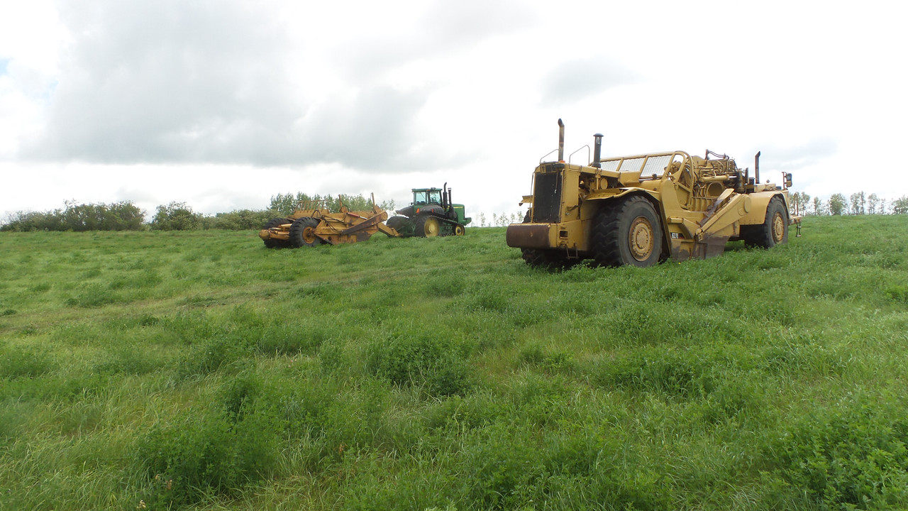

bc.gold 3,403 #6 Posted August 2, 2020 The hop vines are growing up the side of the old farm house which is destined to come down to make way for new lots, the heavy equipment has been moved in to level the land. Share this post Link to post Share on other sites

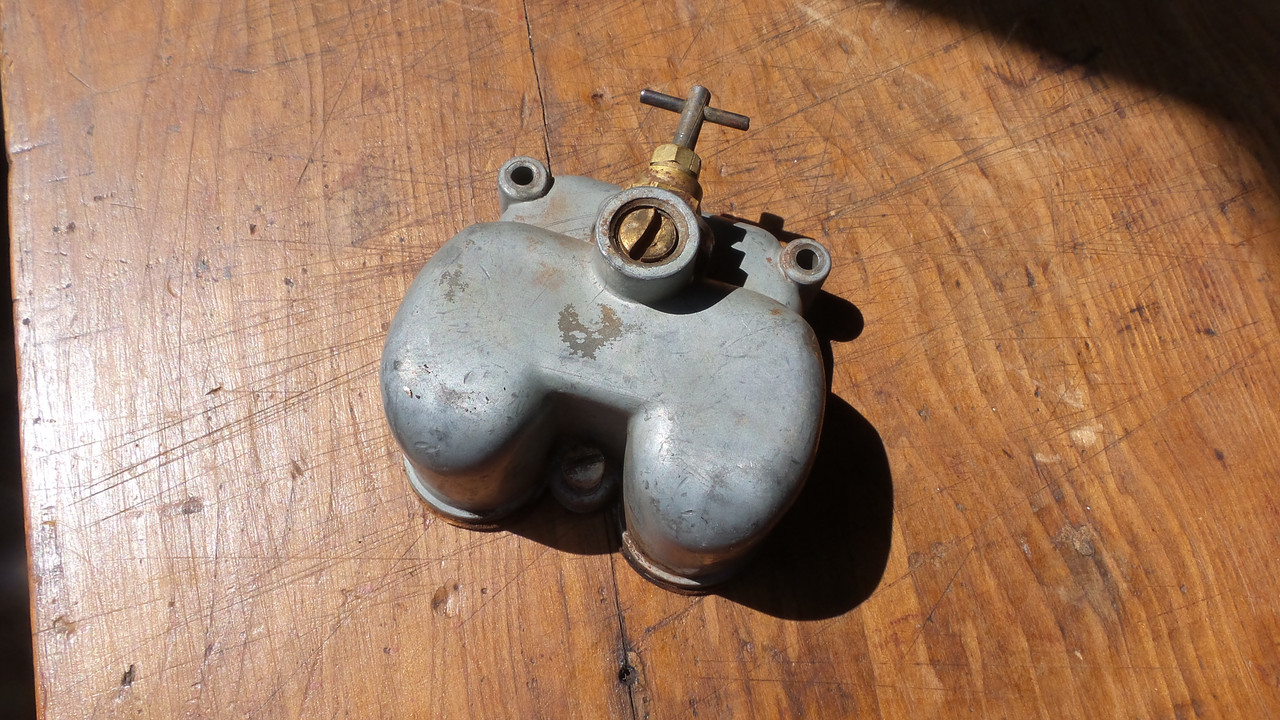

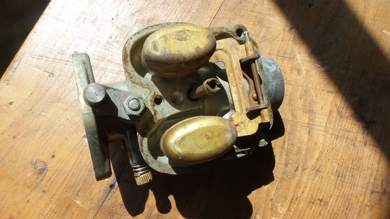

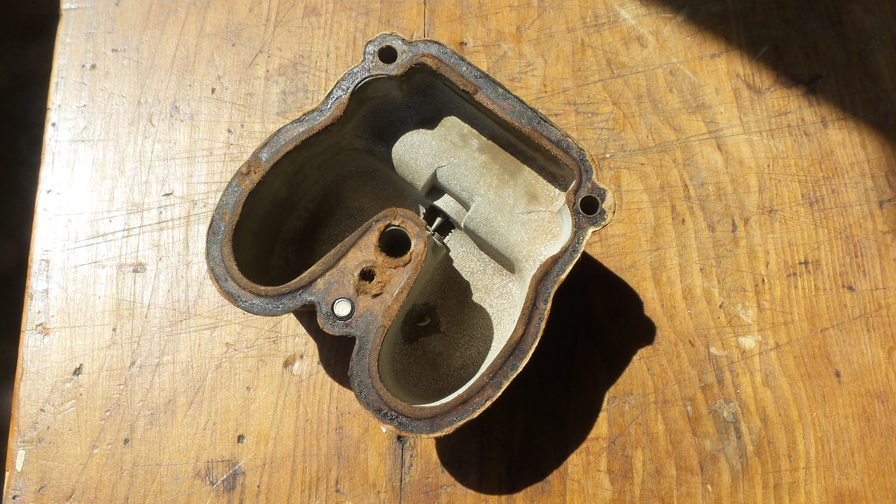

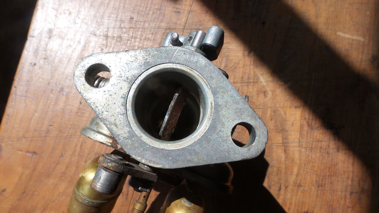

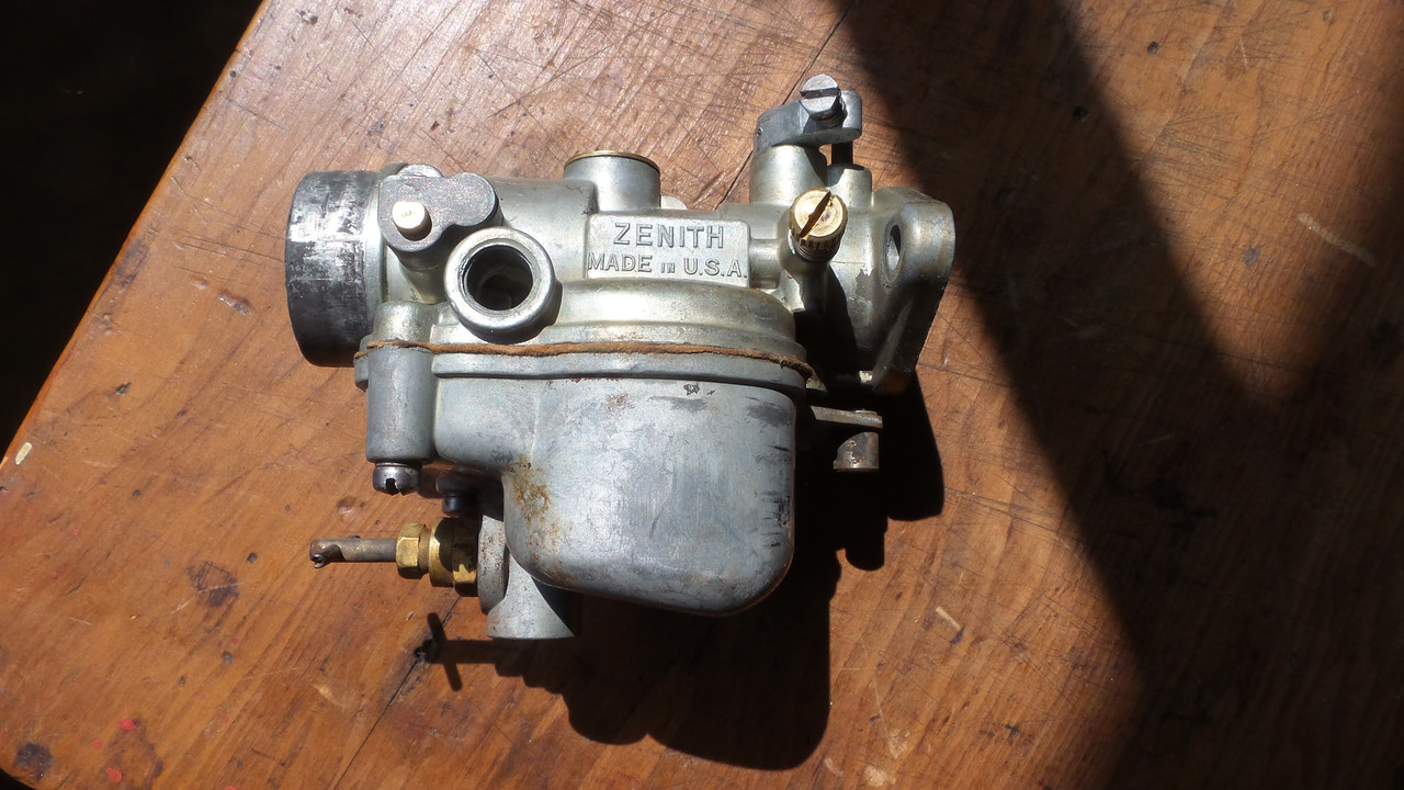

bc.gold 3,403 #7 Posted August 2, 2020 Zenith cleaned up and inspected for cracks and stripped threaded holes . The choke and throttle body shafts are nice in their bores and move freely, no cracks or stripped threads. What I did find odd though is the location of the float needle valve being positioned over to one side. Share this post Link to post Share on other sites
