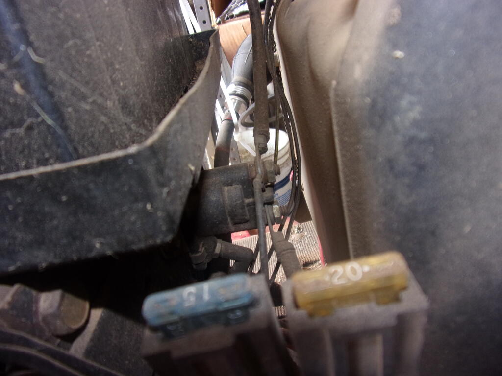

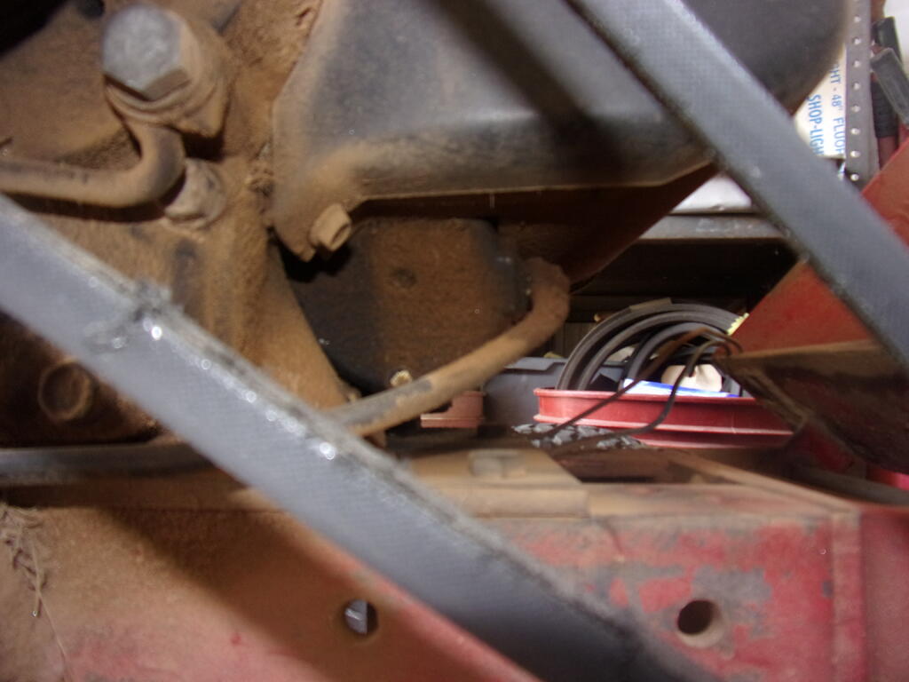

sc halfback 1 #1 Posted July 25, 2020 I sound stupid but I can not find the starter and solenoid on my 417A two cylinder kohler. On my two 417 A when I start it a loud noise comes which I think is the solenoid staying engaged.Is this common on all old kohler or just the two cylinder kohlers. Any help would be appreciated....schalfback Share this post Link to post Share on other sites
Ed Kennell 39,286 #2 Posted July 25, 2020 The solenoid is under the battery and the starter is under the front cyiinder. 1 Share this post Link to post Share on other sites
