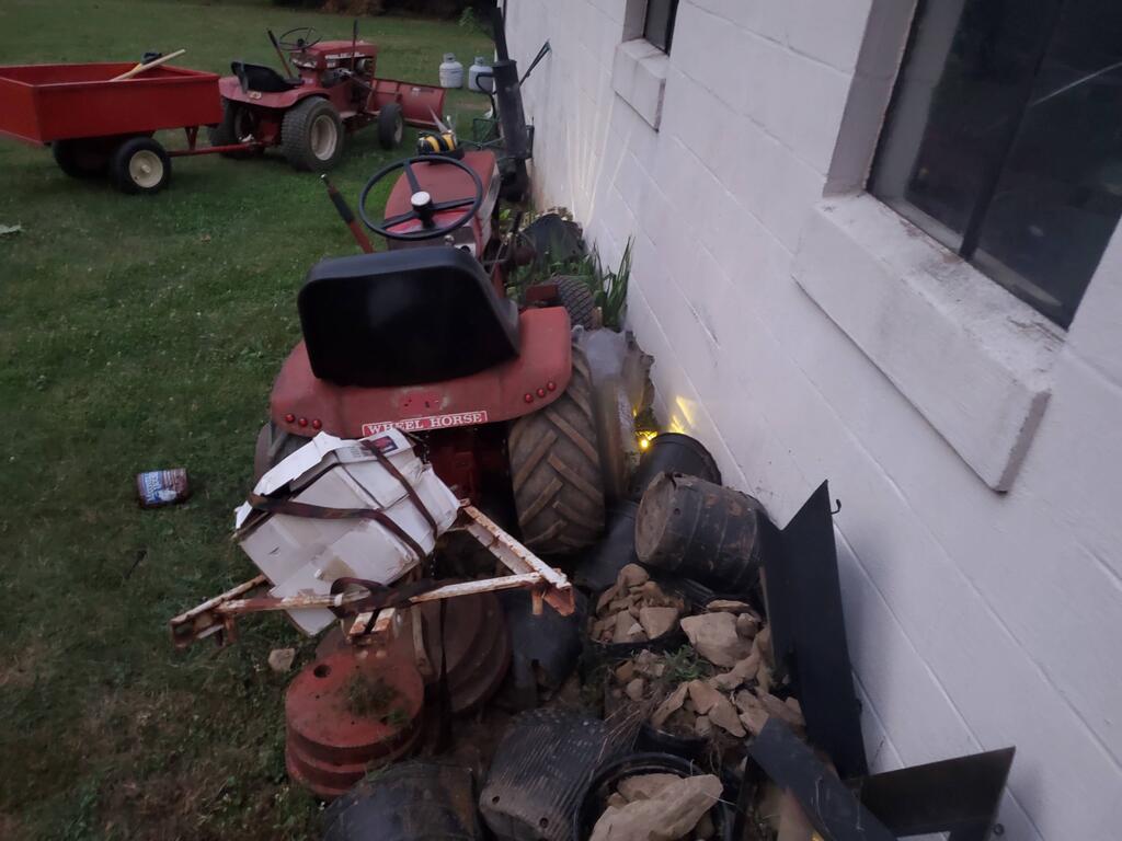

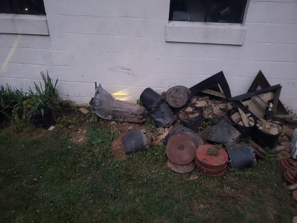

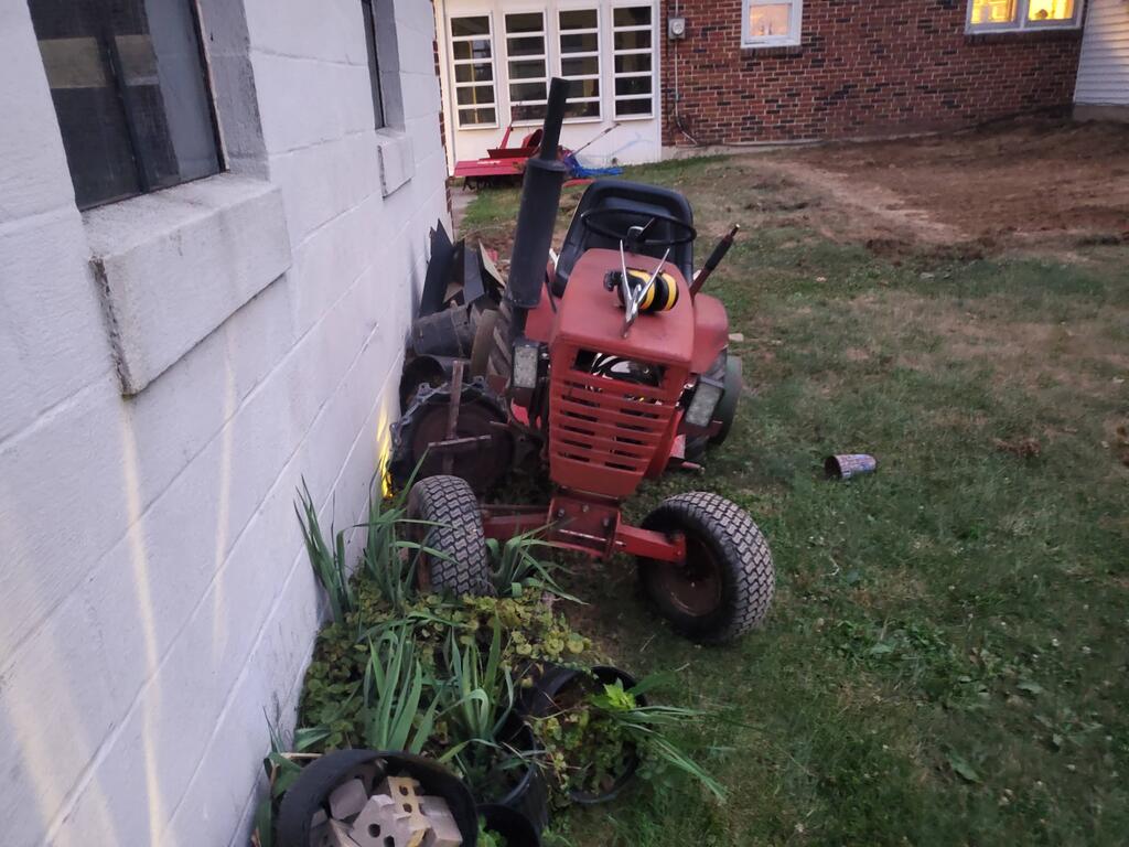

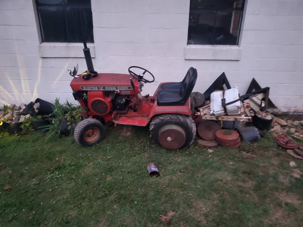

ArturHawk 195 #1 Posted July 25, 2020 Today I had one heck of a near miss. Now that i have my cultivator attached, I thought I would disturb some dirt. After realizing 5 tines was too many, I downsized to a single tine and added some old car rotors (white boxes for weight). When I'm done making a mas of the yard, I'm ready to switch to my other horse and plow the upset dirt (i'm regrading the yard). I decide to throw the horse into high gear and it nearly bucks me off! Front tires lifted 1-2ft off the ground, and i happened to be facing the garage. Fortunately I "steered" off the wall (see the black mark on the wall) and shut the engine off before anything but a couple flower pots (and a crappy garden cart) got crushed. So, my question is this: What can I do to not wheelie in any gear Low 3 or higher? My other horse jerks forward, but the worst is going to high 3 and even that is just a "chirp" before taking off with the wheels never leaving the ground. Thanks! I was going to post this in the "what did you do to your tractor today" thread, but this felt more like a "what did your tractor do to you today" topic. 1 1 1 1 Share this post Link to post Share on other sites

953 nut 63,003 #10 Posted July 25, 2020 (edited) SO, the swan on the hood started flapping its wings and took flight, is that what happened? Looks like the automatic transmission there saved you from going even further. A new fabric wrapped drive belt should be a big help. Edited July 25, 2020 by 953 nut Share this post Link to post Share on other sites
squonk 44,860 #11 Posted July 25, 2020 Set all that stuff on the ground on your hood and strap it down! 1 Share this post Link to post Share on other sites
