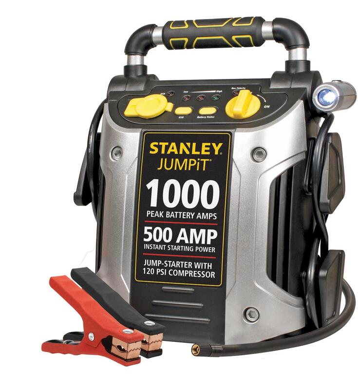

wallfish 17,495 #12 Posted July 20, 2020 Batteries stay in the workers all the time A jump box makes short work for moving, short rides or short use for the rest. Just clamp it on and go! Has it's own charger so it's always ready to go. And you can pump up a tire if required too but it's slow 2 Share this post Link to post Share on other sites
TC10284 111 #13 Posted July 20, 2020 54 minutes ago, wallfish said: Batteries stay in the workers all the time A jump box makes short work for moving, short rides or short use for the rest. Just clamp it on and go! Has it's own charger so it's always ready to go. And you can pump up a tire if required too but it's slow I actually have one of that exact same model! I do use it for short runs and just letting them run, and pumping up tires. I'm looking for something that will fit into the tractor and can use the tractor to mow with or work with, but quickly swap it out to another tractor or connect to a battery maintainer. Share this post Link to post Share on other sites

DennisThornton 4,771 #19 Posted December 23, 2020 On 7/20/2020 at 6:50 PM, wallfish said: Batteries stay in the workers all the time A jump box makes short work for moving, short rides or short use for the rest. Just clamp it on and go! Has it's own charger so it's always ready to go. And you can pump up a tire if required too but it's slow I use mine a LOT! I keep in inside, plugged in, warm and ready at all times. Highly recommended! 1 Share this post Link to post Share on other sites
