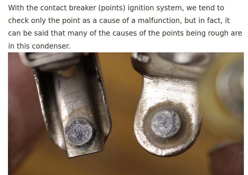

WHX?? 57,808 #2 Posted July 20, 2020 Try replacing the condensor. If that is bad it can cause the points to arc more than they should. 2 Share this post Link to post Share on other sites

bc.gold 3,406 #9 Posted August 2, 2020 On 7/20/2020 at 9:18 AM, WHX24 said: Try replacing the condensor. If that is bad it can cause the points to arc more than they should. Right on the money, full article here. Share this post Link to post Share on other sites
