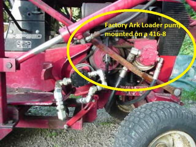

Hi, does anyone have a ark loader on a 520 and if so? Where does the pump attach to? I have the loaded on a 314 and the bracket will not work.

How about posting a picture of what you have?
Typically the pump mounting bracket will attach directly to the engine block in front of the PTO. The other pump in the pic is an addition for a hoe but the loader pump can be mounted that way as well
