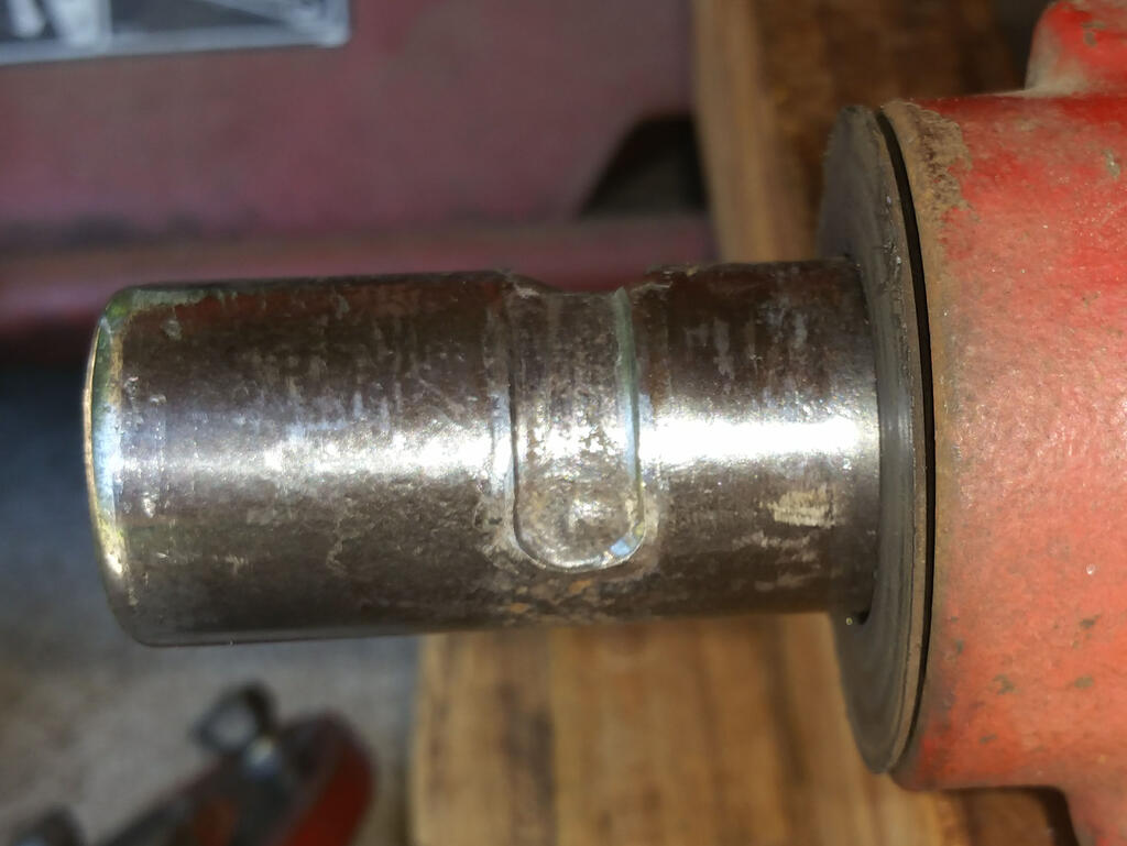

Bilbo 3 #1 Posted July 18, 2020 I have a 1996 Wheelhorse 520-H Garden Tractor with a Hydrostatic trans. Went to repair a tire, and found hub was wobbly on the axle. Pulled the setscrews and found part of the tip of one had broken off. The hub will move less than a quarter turn from stop and cannot be removed from the axle. Is there a simple way to remove it and repair? The tractor isn't in the best of condition, so I am also considering just replacing the setscrew and tightening them down hard and running like that. I am looking for advice. If I go the tightening route, what is the maximum torque I can use on the setscrews? I don't want to strip the threads. Thanks in advance for any help! Share this post Link to post Share on other sites

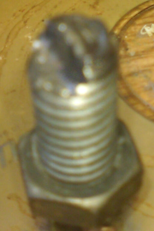

Bilbo 3 #3 Posted July 18, 2020 Thank you for your quick reply! I Will try again to get off. I thought it mignt be blocked by the broken tip of the setscrew. Pic Attached. Share this post Link to post Share on other sites
Ed Kennell 40,500 #4 Posted July 18, 2020 Yes, you have to get the hub off, but DO NOT pound on the hub to remove it. The axle is held in the transmission by a small E clip that will be damaged if you pound on the hub. It sounds like the hub is loose on the shaft and you need to get the key back in place so the hub can be pullled off with a puller. 1 Share this post Link to post Share on other sites
stevasaurus 23,072 #5 Posted July 18, 2020 If it is loose on the shaft, tap the hub in and file any burrs that may be on the end of the axle. 1 Share this post Link to post Share on other sites

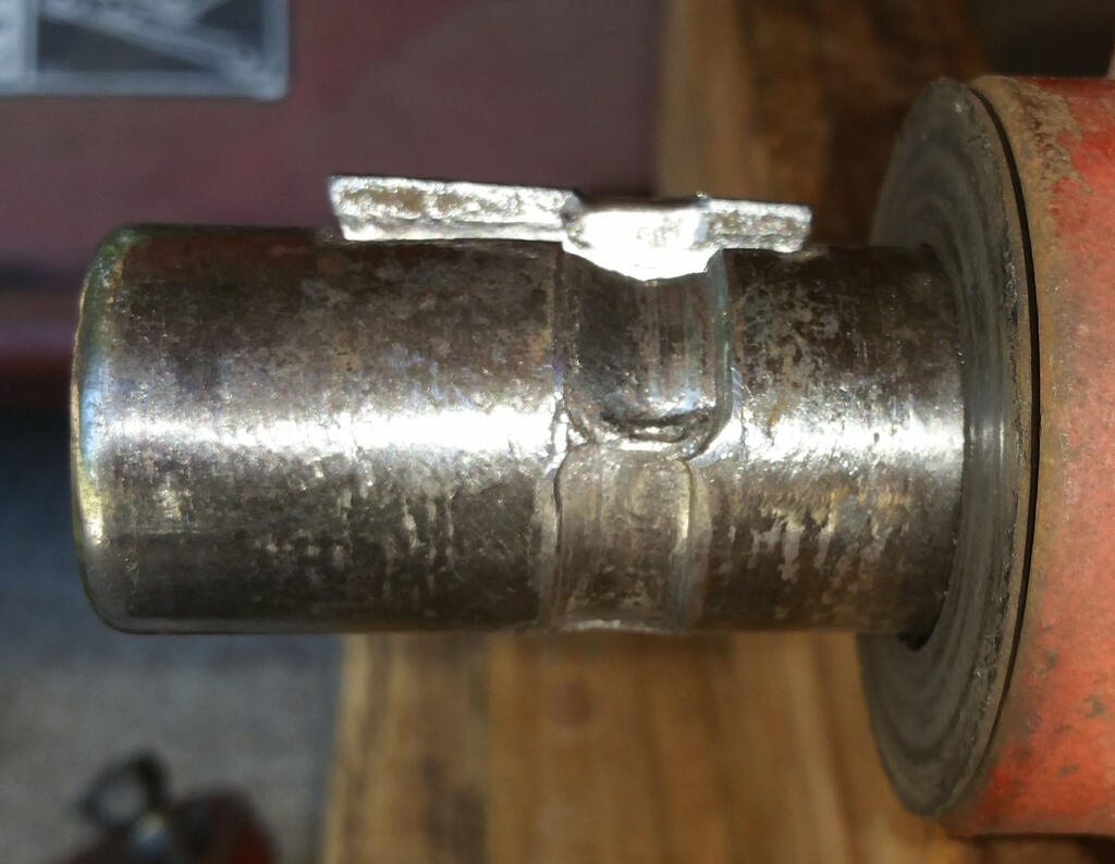

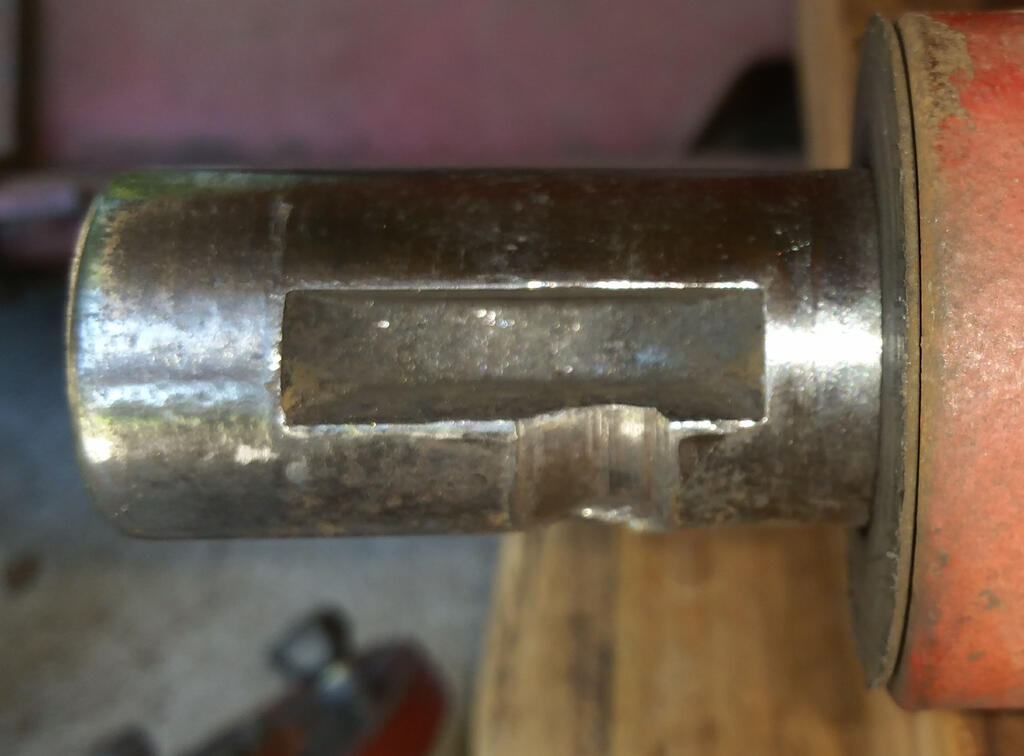

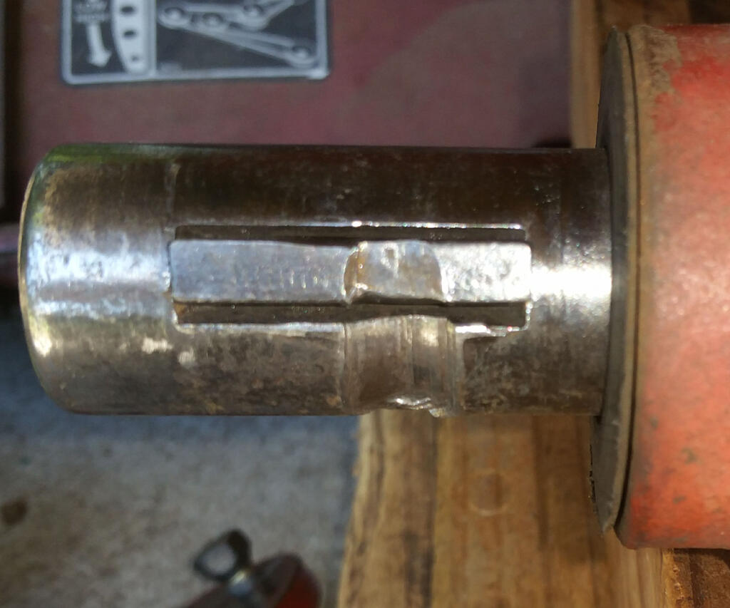

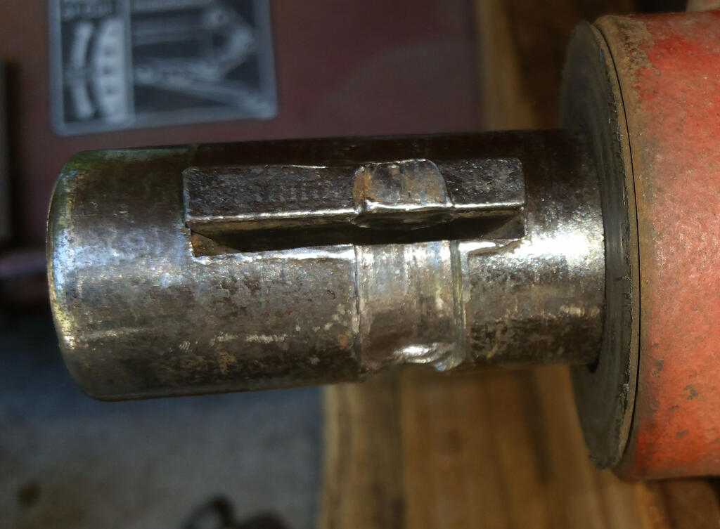

Bilbo 3 #6 Posted July 18, 2020 Well, I got it off. The setscrew that broke was the one over the key. Looking thru the hole I could see the the key was almost there at one end of travel. A few light taps to rotate and a few more back and forth, and it finally came off. I have attached pics of what it looks like. Apparently the setscrew on the key put a gouge in the shaft. I think the key should be tighter in the key way than it would be if I removed the bulge. Taking a break now. Thanks again for all the help. Any suggestions would be appreciated. 1 Share this post Link to post Share on other sites
Ed Kennell 40,500 #7 Posted July 18, 2020 What does the hub look like? No way the hub could rotate that far on the shaft unless the key way is totally gone in the hub. 2 Share this post Link to post Share on other sites
pacer 3,175 #9 Posted July 18, 2020 Wow, thats about as bad as I've ever seen!! Not to put too fine a point on it but ............ you gonna need to replace it and more than likely the hub too. Us guys here on the forum have devised a few .... 'shade tree' fixes for these but I dont think you can salvage that one. Share this post Link to post Share on other sites
lynnmor 7,568 #10 Posted July 18, 2020 (edited) I would replace the axle, hub, key and set screws if it were mine. This is what happens when folks don’t tighten the screws and run them till they quit. Edited July 18, 2020 by lynnmor Share this post Link to post Share on other sites

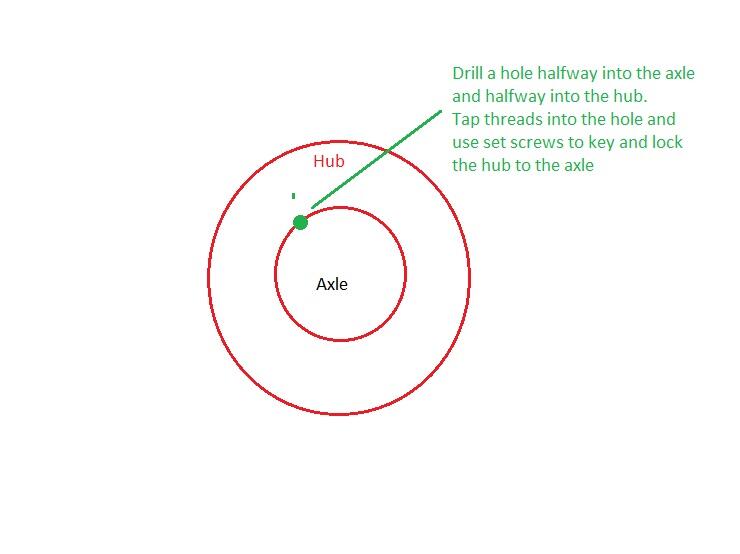

wallfish 17,498 #11 Posted July 18, 2020 For a backyard hammer mechanic fix since it's already broke and the hub and axle need to be replaced. You can key and lock the hub to the shaft by drilling and tapping threads into both. Lock it with 2 set screws into the threaded hole. 5 Share this post Link to post Share on other sites
Bilbo 3 #12 Posted July 18, 2020 @wallfish This sounds like the best course to take. At 75, this will probably outlast me. I am trying to keep it together as long as I can. I will let you know what I do. 2 1 Share this post Link to post Share on other sites
