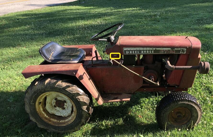

gwest_ca-(File Mod) 10,946 #2 Posted July 18, 2020 Can see the ID plate at the right side of the dash housing. Should have model number, serial number and possibly the Julian build date. Post the numbers and will add to the correct list. Garry 1 Share this post Link to post Share on other sites

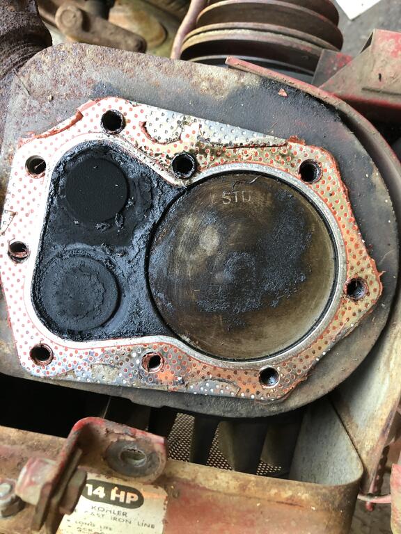

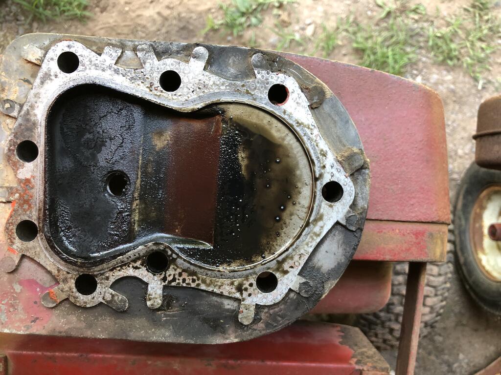

lynnmor 7,259 #4 Posted July 18, 2020 If you are sure it is a pre-ignition knock, pull the head and clean out the carbon. Also check that it has the correct spark plug. If the knock is mechanical, time to tear it down before it self destructs. Share this post Link to post Share on other sites

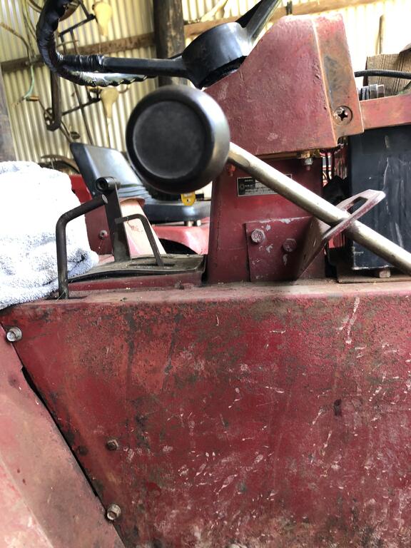

19richie66 17,463 #6 Posted July 18, 2020 Someone converted it to manual pto, which isn’t a bad thing. One less electrical thing to worry about. Is the grille open in the front and the fuel tank pokes through? That would be a 1969 grille. The rest are solid front. Share this post Link to post Share on other sites
Sammy 89 #7 Posted July 19, 2020 (edited) 10 hours ago, gwest_ca said: Can see the ID plate at the right side of the dash housing. Should have model number, serial number and possibly the Julian build date. Post the numbers and will add to the correct list. Garry the plate says that the model number is 17441 and the serial number is 568053. Edited July 19, 2020 by Sammy Share this post Link to post Share on other sites
Sammy 89 #8 Posted July 19, 2020 5 hours ago, 19richie66 said: Someone converted it to manual pto, which isn’t a bad thing. One less electrical thing to worry about. Is the grille open in the front and the fuel tank pokes through? That would be a 1969 grille. The rest are solid front. I thought it came with the manual pto but I guess not, and the grille is open with the gas tank through it so it’s a 1969. Share this post Link to post Share on other sites

cafoose 3,354 #15 Posted July 19, 2020 20 hours ago, 19richie66 said: Someone converted it to manual pto, which isn’t a bad thing. One less electrical thing to worry about. Is the grille open in the front and the fuel tank pokes through? That would be a 1969 grille. The rest are solid front. I have a GT-14 that I converted to manual PTO. Could you please post a close up picture of how the upper bracket is mounted to the hood stand? 13 hours ago, Sammy said: I can definitely get one tomorrow morning and also how do I upload a file of more than 14.78MB? Here is a link to become a supporter so you can upload unlimited pictures: https://www.wheelhorseforum.com/store/ Share this post Link to post Share on other sites
Sammy 89 #16 Posted July 19, 2020 12 hours ago, Sammy said: I can definitely get one tomorrow morning and also how do I upload a file of more than 14.78MB? there is the video of the knock, also the rings are trashed. Share this post Link to post Share on other sites

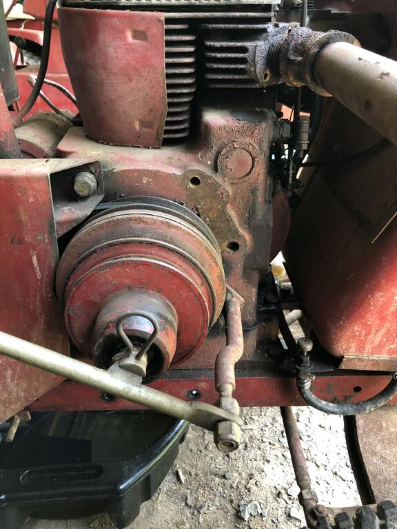

Sammy 89 #17 Posted July 19, 2020 19 minutes ago, cafoose said: I have a GT-14 that I converted to manual PTO. Could you please post a close up picture of how the upper bracket is mounted to the hood stand? Here is a link to become a supporter so you can upload unlimited pictures: https://www.wheelhorseforum.com/store/ There are pictures of the setup on mine. And ok thank you! Share this post Link to post Share on other sites
cafoose 3,354 #18 Posted July 19, 2020 20 minutes ago, Sammy said: There are pictures of the setup on mine. And ok thank you! Thank you! here's a thread on my conversion: Share this post Link to post Share on other sites
lynnmor 7,259 #19 Posted July 19, 2020 A pre-ignition knock would happen with the engine under heavy load, your video is of the engine not loaded at all. So, IMHO, you have an engine in serious need of an overhaul. The carbon and oil in the cylinder head, plus your analysis says it all. 1 Share this post Link to post Share on other sites

ZXT 2,396 #21 Posted July 19, 2020 That engine is about to put a window in the block. I wouldn't run it any more. Looks like you're in for a complete rebuild, or finding a good used engine as Richie suggested. Share this post Link to post Share on other sites
