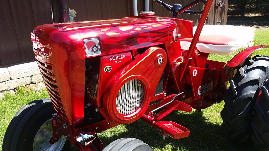

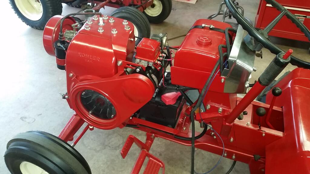

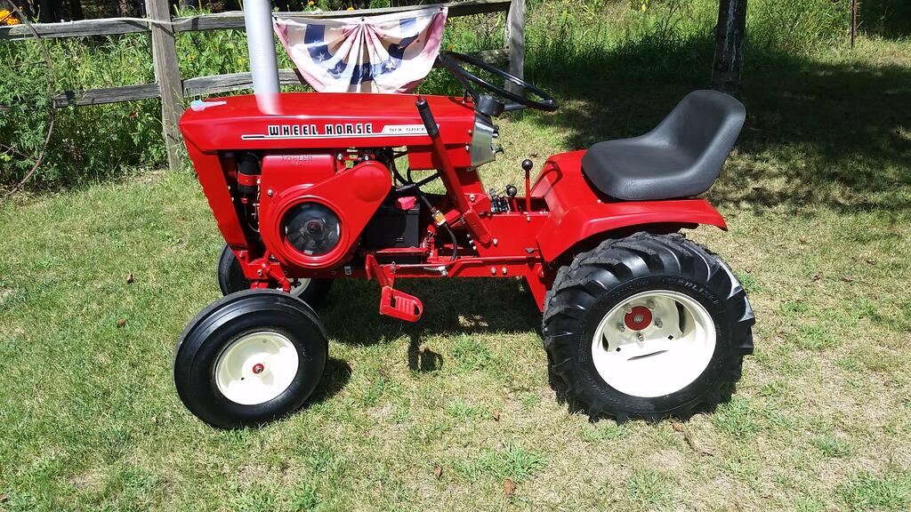

WHX?? 49,486 #5 Posted July 17, 2020 Every nut and bolt on these tractors is stainless. Most of my snow blowers and a few decks sport all stainless. I've done a few motorcycles out of all stainless too so my stainless fetish goes way back. No problem with galling. It seldom happens on small diameter bolts. Generally 3/8 diameter and up is where you can run into problems. To prevent it yes antisieze or any lubricant will do. Heat/friction is what causes it so more common on nyloc nuts. Assemble slowly to avoid. Many of @Achto's tractor are done with stainless. 4 2 Share this post Link to post Share on other sites

Achto 27,917 #9 Posted July 17, 2020 3 hours ago, 71_Bronco said: I know stainless is more prone to galling, but maybe there is a way to prevent this that I don't know about? Maybe something like anti-seize? I use stainless on every tractor that I redo. To avoid galling I try not to put a stainless nut on a stainless bolt or vise versa. Which ever will be showing gets stainless. Anti-seize and believe it or not Loctite will both prevent galling. I use a fair amount of blue Loctite when I am assembling a tractor. I have yet to have an issue using these practices. 5 5 Share this post Link to post Share on other sites
