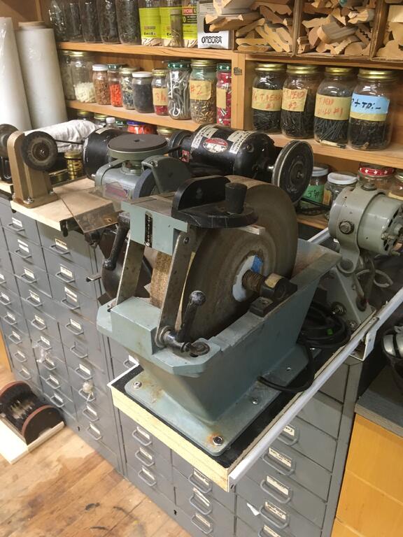

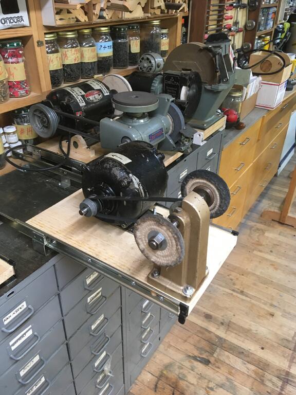

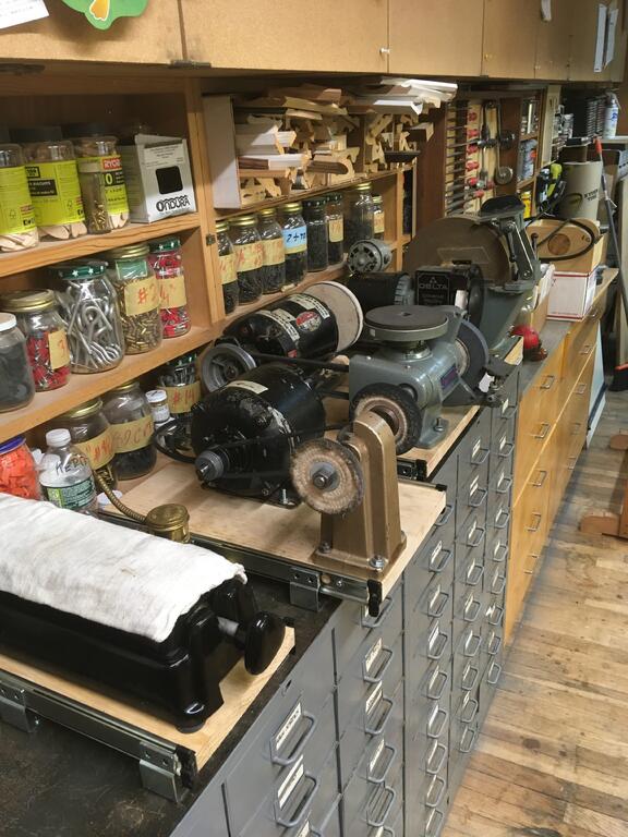

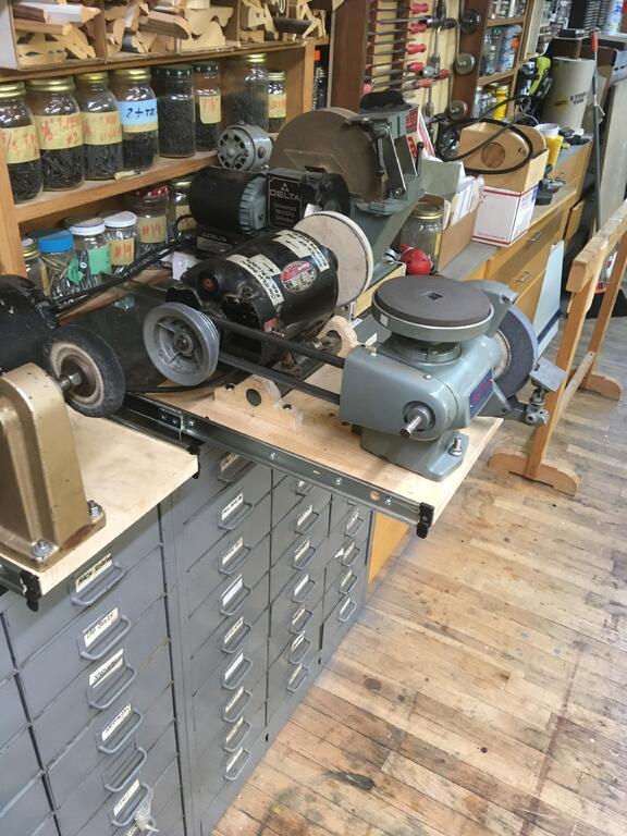

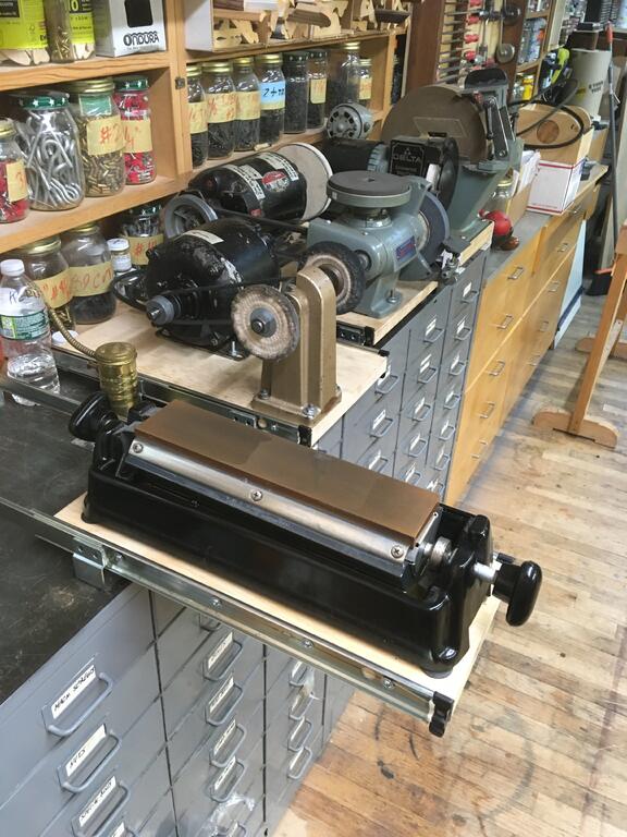

formariz 11,993 #1 Posted July 17, 2020 (edited) Between projects is always the time that shop improvements occur here. Absolute sharp and tuned tools is a must, so with only the exception of a few specialty honing stones I consolidated all my sharpening and tool maintenance devices to one area dedicated for that function. Each one slides out so it can be used without any obstructions on their sides. The indispensable Norton multi stone submerged in kerosene, two buffing wheels charged with different compounds, the grinder honer running real slow with an additional hard felt buffing wheel having special shapes for carving tools, and the wet wheel for major edge grinding without burning the edges with an additional small buffing wheel run by a fan motor from a retired US Navy ship.. At the bench I keep a couple of strops for immediate frequent touch up. Edited July 17, 2020 by formariz 2 5 1 Share this post Link to post Share on other sites
