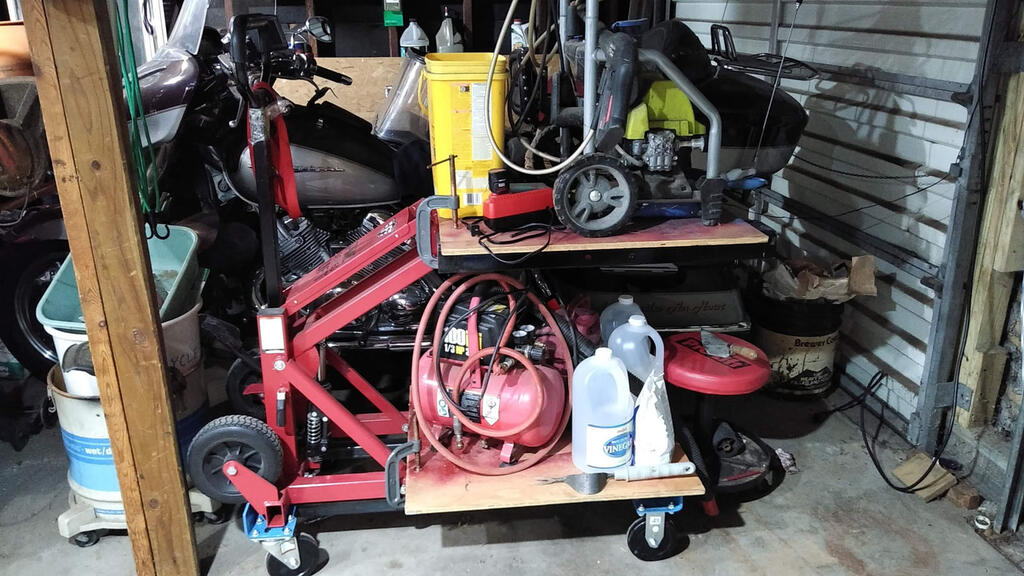

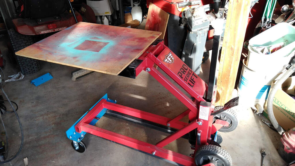

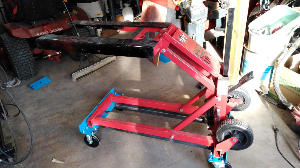

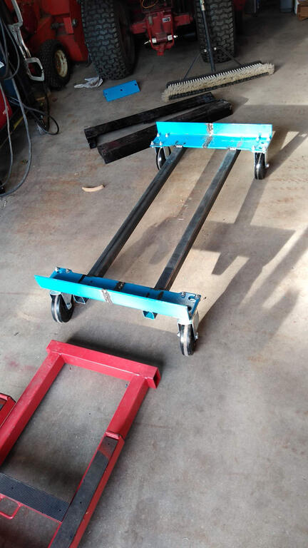

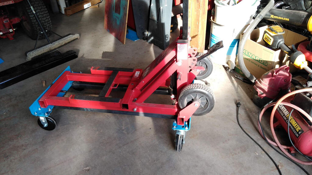

edgro 679 #1 Posted July 15, 2020 I bought one of these jacks, and it seems to work well as intended. With the extension bar and wheel lifts off, it can be a platform jack, or as an adjustable work lift platform. I built some extension arms to support a piece of plywood to use as a lift table. This jack has to be tipped back on the wheels to move it around, which is a PITA in the garage, and uses a lot of floor space. I built a wheeled frame for it to set in, which makes it movable. As a bonus, I can lock it in the raised position, clamp on the plywood, and use it as a clutter collector when not in use. Holds more clutter than a tractor hood! The HF casters I used are rated at 330 lbs each, so load shouldn't be a problem. First mod I am going to do is switch the 2 strait casters for swivels, 6 1 Share this post Link to post Share on other sites
