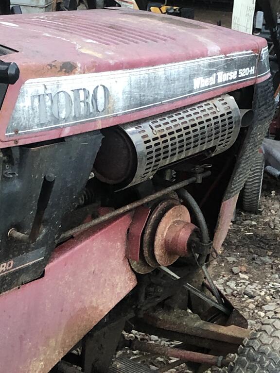

Silveradojeff 13 #1 Posted July 15, 2020 Finally got my first 520h this evening.a lil rougher than I thought but oh well. I know it runs because engine was warm when the guy dropped it off but I couldn’t get it to do anything but make a buzzing noise. Didn’t have a battery in it but hooked up a charger. Only buzzing, what am I doing wrong??? 1 Share this post Link to post Share on other sites

Tractorhead 9,036 #5 Posted July 15, 2020 Nice Machine Jim, sadly that anybody rapes the Hood that much. Share this post Link to post Share on other sites

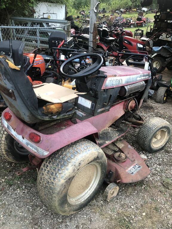

Silveradojeff 13 #7 Posted July 15, 2020 Thanks for the info. Update: put a battery in this morning and it fired right up and no smoke while running. I’m trying to determine the size of deck. Model number on deck is almost worn off. The best I can tell the numbers are 15498002 can anyone tell me what size deck this is? Thanks Share this post Link to post Share on other sites
WVHillbilly520H 10,372 #8 Posted July 15, 2020 19 minutes ago, Silveradojeff said: I’m trying to determine the size of deck. Model number on deck is almost worn off. The best I can tell the numbers are 15498002 can anyone tell me what size deck this is? Thanks It's a 48" side discharge (from the picture) gage wheels adjusting handle on left side only 2 other decks fit/work big 60" or 42" Rear discharge. 2 Share this post Link to post Share on other sites
