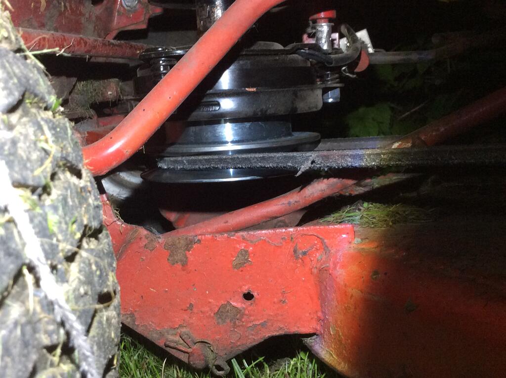

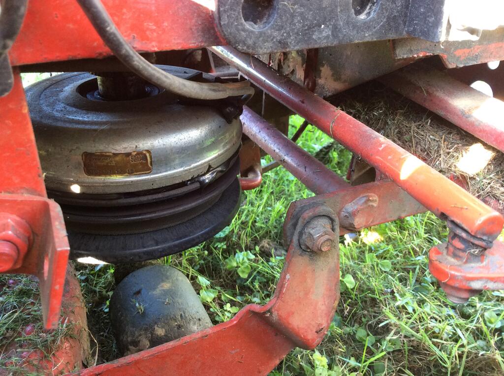

Edit - added Picts -
the old 12 HP Clutch after it‘s melting
Temp after 10 minutes was allready at 102deg C
this 10 min I need to go and grab a meter and check the Temp.
and the new improved Clutch for 20 HP
So check your Spindles and all moving bearings they be required if they turning freely without force.
