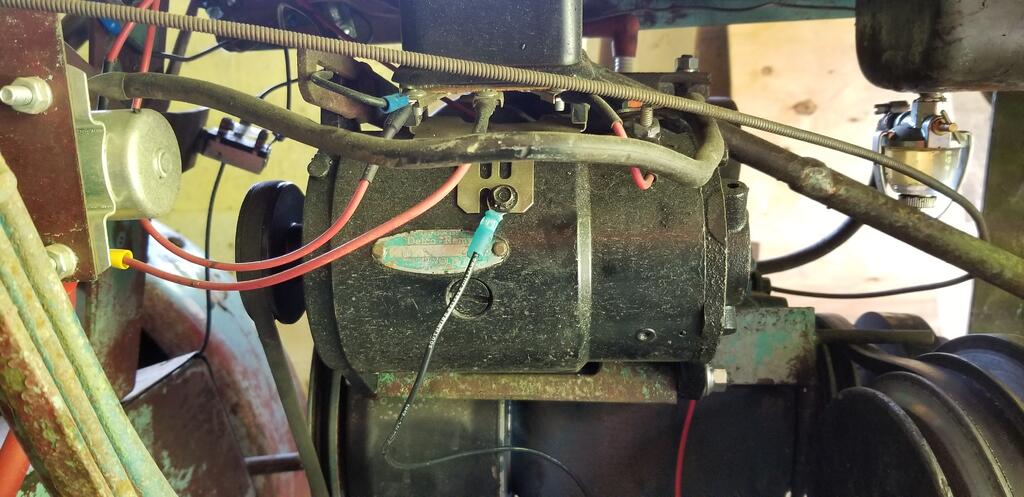

I've had the starter generator rebuilt because it was in real bad shape, new voltage regulator, new switch, new solenoid. Everything electrical is new. I've been running wires to check to see if I had a bad ground and still can't get it to charge. What am I missing?

When I put my meter on the battery at wide open throttle I'm only getting 12.4 volts.
