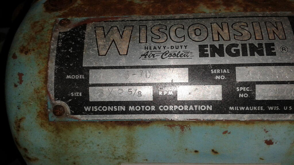

71_Bronco 1,072 #1 Posted July 8, 2020 First off, if this is in the wrong section, please feel free to move it. I am picking up a Wisconsin engine tomorrow that I found on CL. It's a S7D with a starter / generator and an oil down-draft air-filter. From what I found, it should be roughly 7hp at 3,600 rpm. Did Wheel Horse ever use Wisconsin engines? I know they have used a variety of manufacturers over the years, but I dont see these very often. On a side tangent, I found a mostly-complete lawn ranger local to me. Looks pretty complete minus a motor and a lift-arm. Was thinking this would be a pretty neat pairing. Share this post Link to post Share on other sites

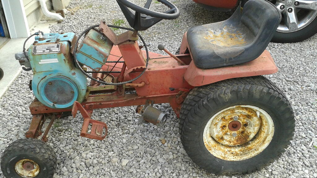

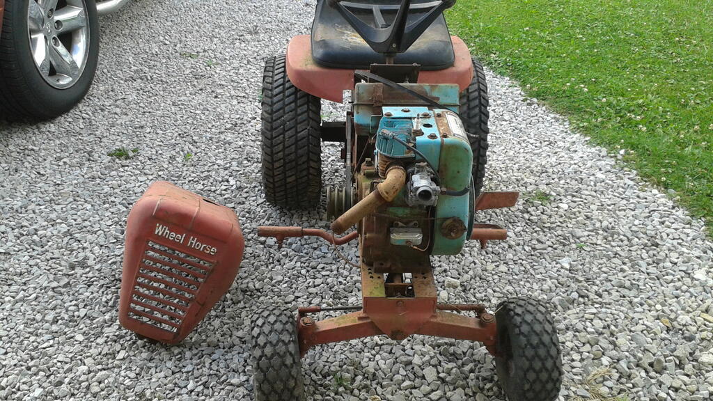

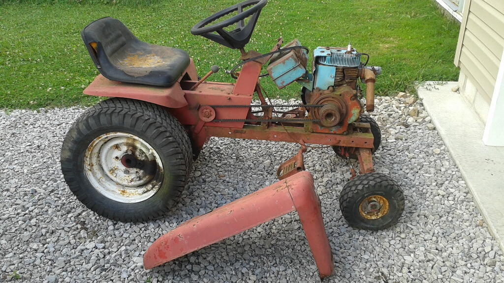

BOB ELLISON 2,983 #9 Posted July 9, 2020 I found these pictures of the little lawn ranger that I still have covered up behind my shed.l Share this post Link to post Share on other sites

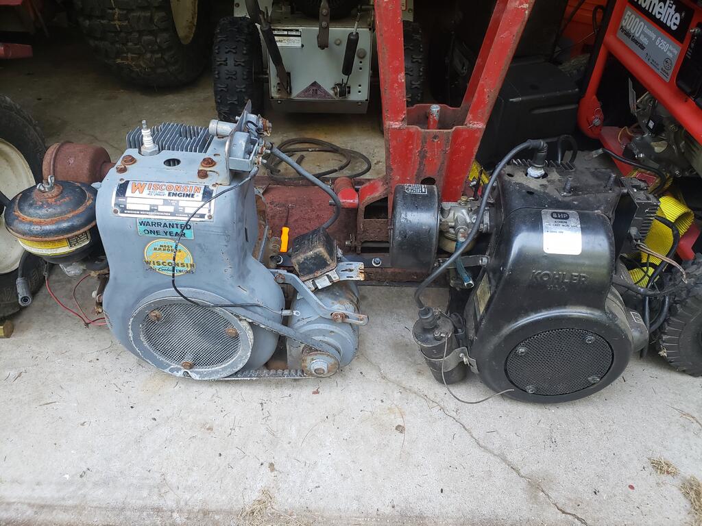

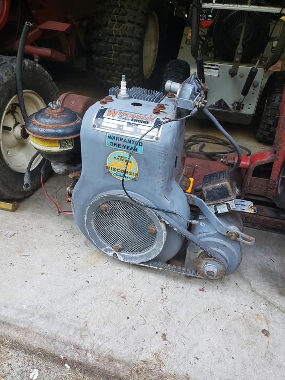

71_Bronco 1,072 #11 Posted July 9, 2020 Picked up the motor this afternoon. Looks like it's in pretty decent shape. He said it ran fine, just needs to be tuned (not sure what that means, but I will find out). 1 Share this post Link to post Share on other sites
71_Bronco 1,072 #12 Posted July 9, 2020 Now, here comes another question. How would this compare to a K181? I have a Commando 8 that i need to put a new motor into (popped the rod in the original motor). I have another K181 that I need to swap over the starter / generator onto (currently has electric start). The other option would be to go through the Wisconsin and use that instead (assuming crank location is correct and my tri-pulley will fit). The wisconsin does look a little bigger, but the Commando 8 seems to have some extra room under the hood. The S7D is claimed to be 7.3 hp vs the K181 at 8 hp. How would this Wisconsin compare to the Kohler? Or would it just to be a "different" build? Thoughts? Share this post Link to post Share on other sites
ebinmaine 80,719 #13 Posted July 9, 2020 Looks like the pulley location sure will be close. You'll need to find a home for the battery because of the S/G on the Wisconsin. Triple pulleys can be ordered online if the shaft size is wrong but location is correct. Share this post Link to post Share on other sites
71_Bronco 1,072 #14 Posted July 9, 2020 (edited) 44 minutes ago, ebinmaine said: Looks like the pulley location sure will be close. You'll need to find a home for the battery because of the S/G on the Wisconsin. Triple pulleys can be ordered online if the shaft size is wrong but location is correct. I was looking at the starter generator brackets. I can fab a new top bracket to mount on the head studs (like the k181), and reuse the other mount and put the S/G up high like the stock K181. I may need a slightly longer belt, but it would work, I think. Just not sure if it would be worth it, or if the S7D would be a step down in power or not. Edit: If it was an S8D (8 hp version), and the crank was in the correct spot, I'd swap for sure, just to be something a little different and unique. Edited July 9, 2020 by 71_Bronco Share this post Link to post Share on other sites
ebinmaine 80,719 #15 Posted July 9, 2020 44 minutes ago, 71_Bronco said: step down in power Forgive my memory if you've already stated... What'll this tractor be used for? Less than 1 hp drop really isn't much IIFF you're not already "pushing" the 8 horse through grass or a tiller. Keeping in mind I am not familiar with Wisconsin, what's the torque curve of it? If it's a good strong engine line then it may actually be able to push/pull MORE than the comparable K181... Share this post Link to post Share on other sites

71_Bronco 1,072 #19 Posted July 12, 2020 @BOB ELLISON, do you know if that hood will bolt on without modification? The Lawn Ranger roller thats near me just got lowered from $150 to $100, and it's really tempting me now. If I know the S7D will fit, I may grab it for a rainy day project. Share this post Link to post Share on other sites
ebinmaine 80,719 #20 Posted July 12, 2020 At a C note it's worth buying just to hold. Share this post Link to post Share on other sites
BOB ELLISON 2,983 #21 Posted July 13, 2020 The hood was bolted down from what I can remember and nothing was cut so I think it will fit. Like @ebinmaine said the gen may be in the way because mine didn't have one. There's no room for a battery from what I can see so a pull start may be the only way. Share this post Link to post Share on other sites

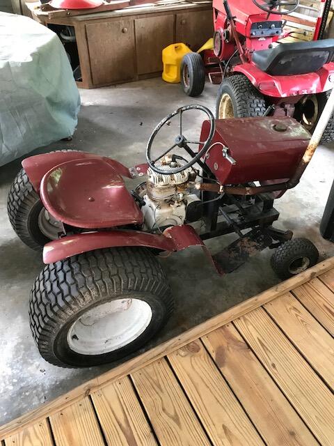

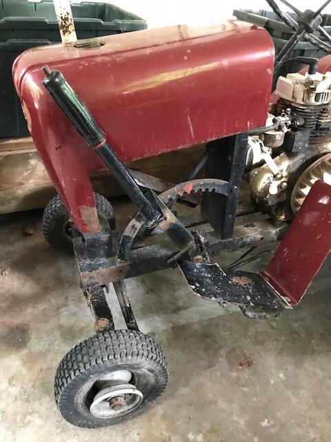

Kagnew66 15 #22 Posted July 20, 2020 FYI: This is a Wisconsin in what I believe is a 400 Suburban (customized). Share this post Link to post Share on other sites
