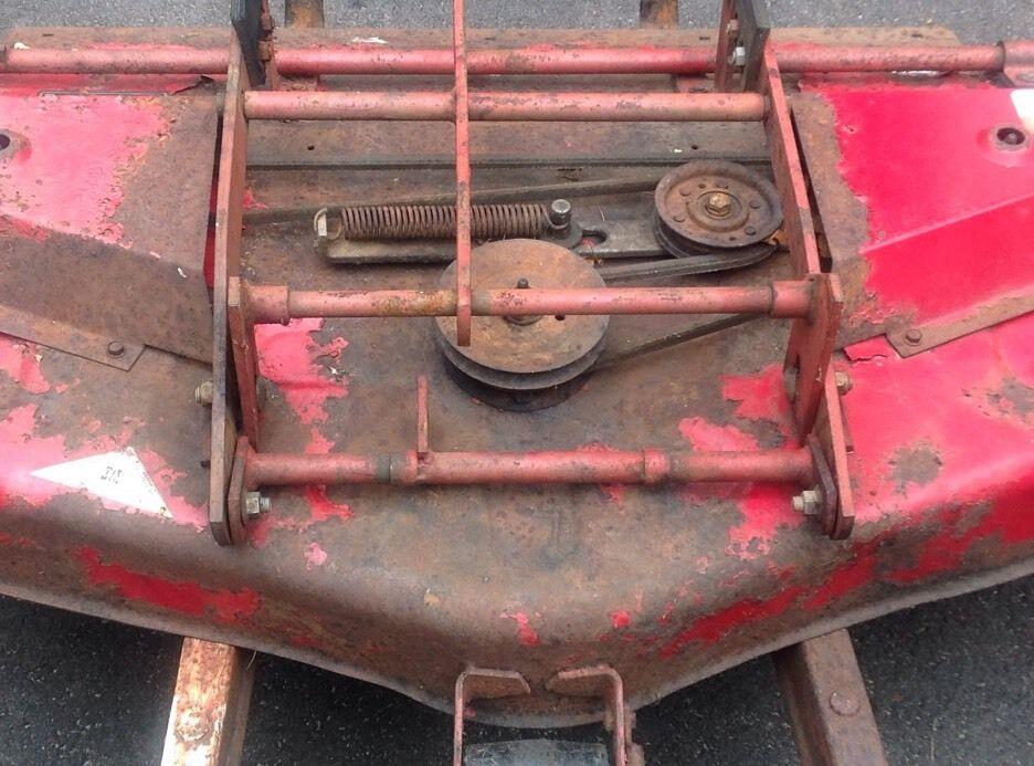

daveoman1966 3,788 #2 Posted July 4, 2020 (edited) This is what I like about the Wheelhorse product line: Most any 36, 42, or 48 deck made from 1973 forward using the Tach-A-Matic system will fit on the B series or the C-120, C-160, C-141, C-145, or the 300 400 and 500 series tractors. With a few lift hardware changes, these decks will also work on the bigger D series tractors. Older model decks using the 'Double-D' Spindles and pulleys can also be easily modified to work. If the deck looks like this...or similar...it'll hand on the C-120. Edited July 4, 2020 by daveoman1966 1 Share this post Link to post Share on other sites

Mr Magoo 226 #4 Posted July 5, 2020 3 hours ago, daveoman1966 said: This is what I like about the Wheelhorse product line: Most any 36, 42, or 48 deck made from 1973 forward using the Tach-A-Matic system will fit on the B series or the C-120, C-160, C-141, C-145, or the 300 400 and 500 series tractors. With a few lift hardware changes, these decks will also work on the bigger D series tractors. Older model decks using the 'Double-D' Spindles and pulleys can also be easily modified to work. If the deck looks like this...or similar...it'll hand on the C-120. Thank you. That's a beauty of a deck Dave! Share this post Link to post Share on other sites
Mr Magoo 226 #5 Posted July 5, 2020 Exactly what I needed to know. I will look for one of these then. Thank you guys! Share this post Link to post Share on other sites
