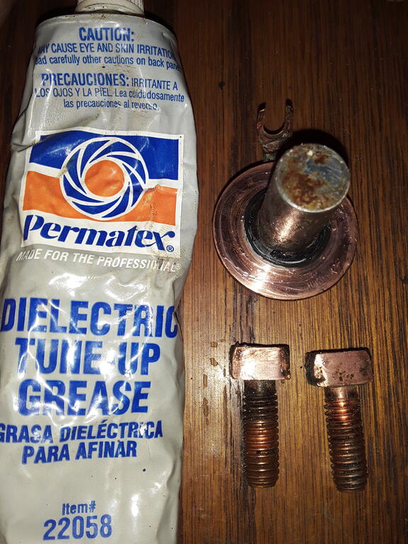

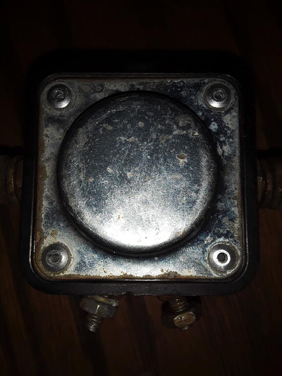

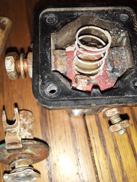

Stike 204 #1 Posted July 3, 2020 Hello all, went to start one of the horses and got just clicks at the starter solenoid had 12 volts on battery side and nothing to starter so pulled the solenoid and drilled out the rivets holding the plate to the bottom with a 1/8 inch bit and found the suspected corrosion. To remove the plunger loosen the I side of the solenoid and it will come right out. Cleaned up the contacts and applied dielectric grease. Reassemble and use 1/8 inch pop rivets to finish up, works every time and doesn't take long to do. Hope this helps someone out that has this problem. 4 6 1 Share this post Link to post Share on other sites
