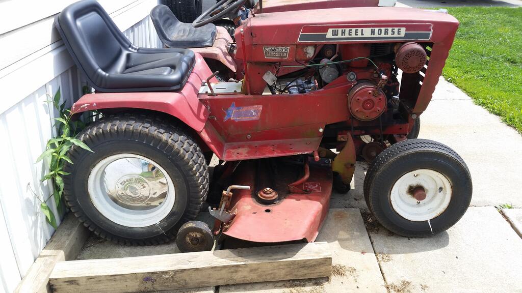

Just picked up a 1968 Electro 12 with original engine the manual says 5 pints of oil after draining completly I added 2 qts. and checked and dipstick showed full I did a measurement and the oil line is right at the oil pan line, I read a article that said oil line should be a 1/2" above oil pan line if I add the pint that does put it above the oil pan line but shows over full on dipstick it is a screw in dipstick and I'm not screwing it in for checking I have this problem before I just put in 2-1/2 qt. and go never had a problem just curious what you guys think.

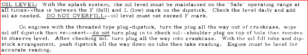

When checking with the older  screw in plug style dipstick just rest the bottom of the plug on the block. it can be tricky to see the oil level on these round dipsticks. Clean around the plug before checking. Here is the rest of the manual.

That was the way I checked it,I guess for now I will go with the dipstick reading and assume the manual is incorrect.
