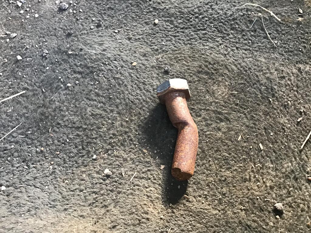

Check out this bad boy!  That’s what Grade 3 will get ya when you use it as a 4 link pin on a 16’ wide snow plow!

That's really nice but where in the world are you going to find one that has that kind of an angle building already?

 Bit of heat and a BFH will soon sort that. :handgestures-thumbup:

perfect spare, huh?

Gives you a clue as to the amount of force between the plow blade through the machine to the driving wheels.

and though a hassle, the cheap bolts like this are a perfect failsafe for the wing hydraulics.  Smoke something big and heavy at any rate of speed, it pops this instead of a $200 cylinder.

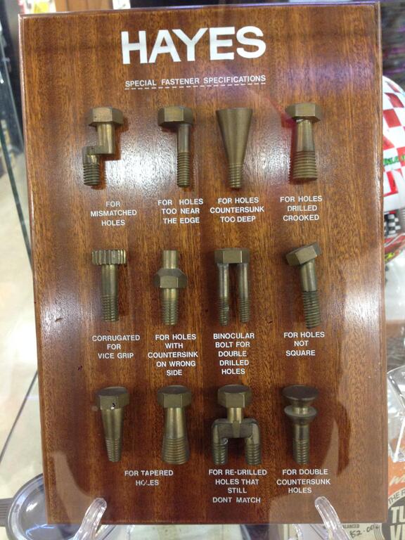

40 minutes ago, Alex175 said:
Reminds me of this classic beauty, had a poster like this that used to hang at the parts store I worked at years ago, those who got it laughed hard, and those who scratched their heads at it gave us a good laugh.
I have a printout of that in my shop, didn’t realize there was a physical model of it!  That’s fantastic!
you know a Source where to buy,
need a few for a collegue... 😎  😂😂😂

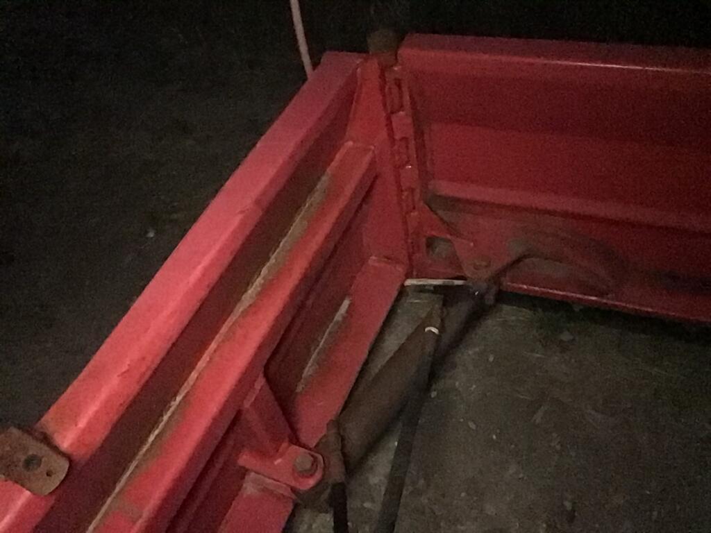

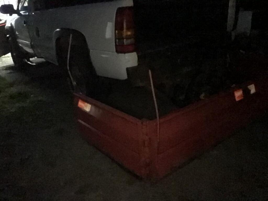

I’d like to see the 16’ plow!
It’s 8’ wide with two 4’ wings.  Mine can pull or push, I built a 1”x4” solid bar frame for it.
