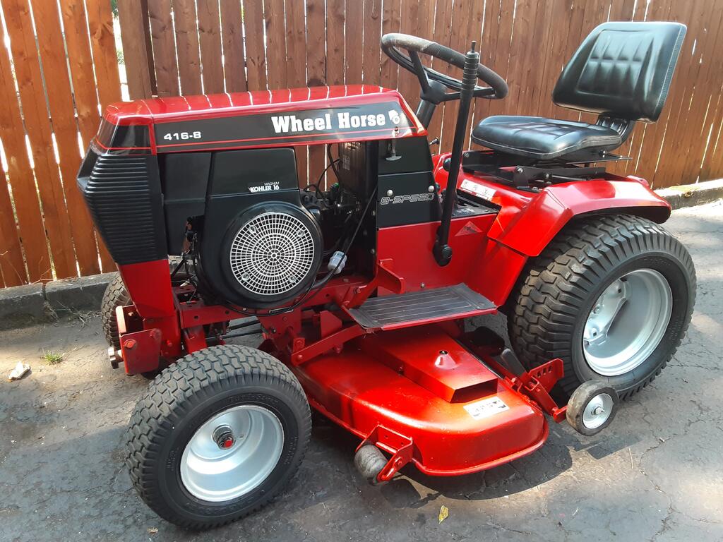

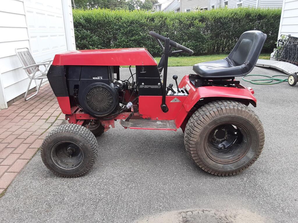

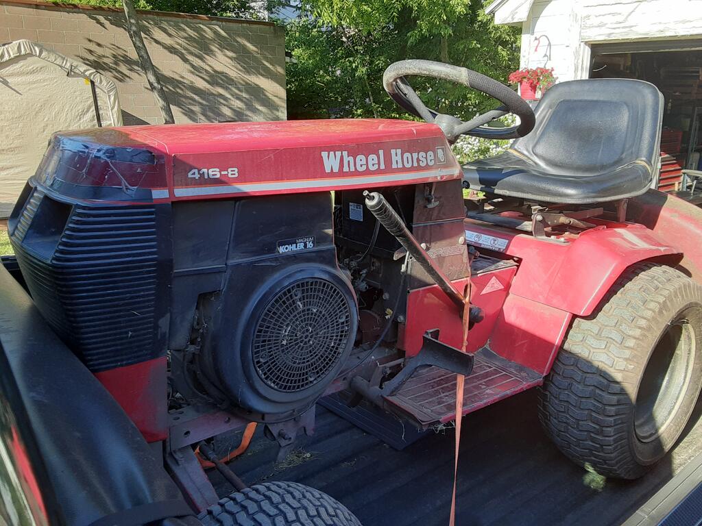

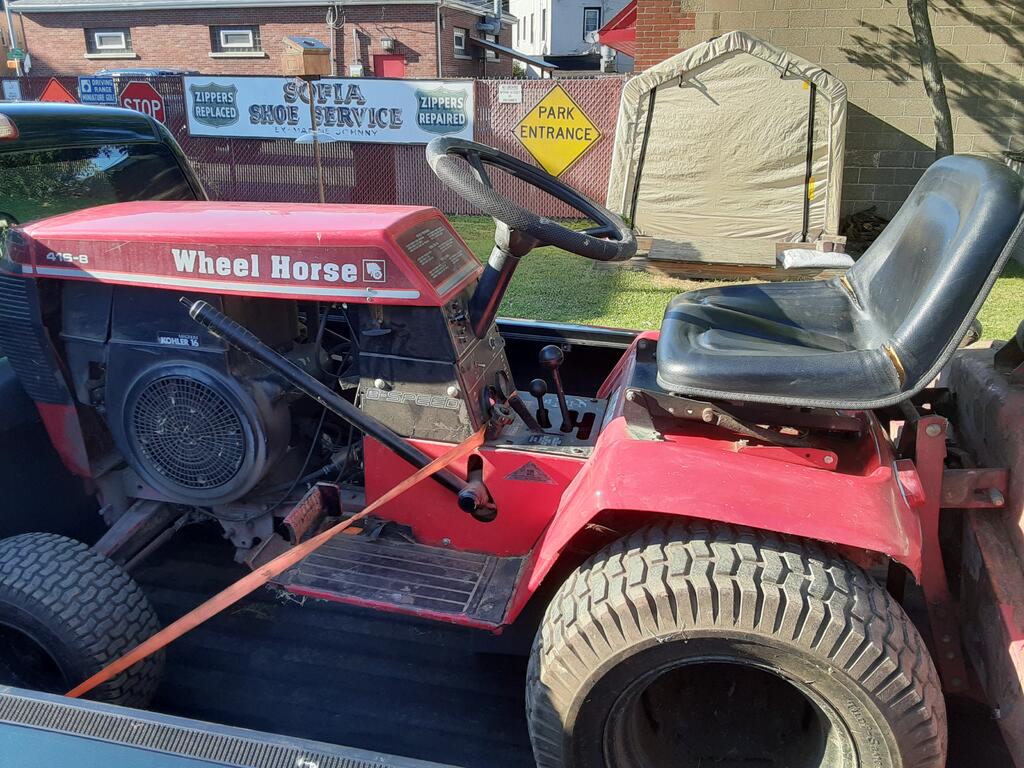

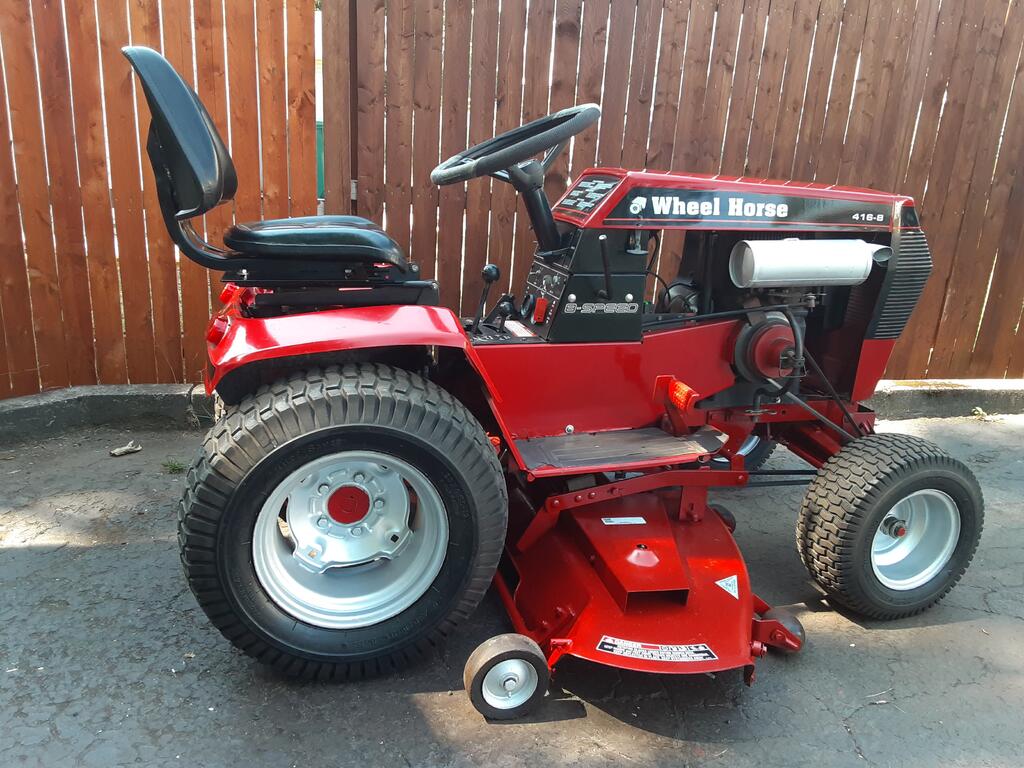

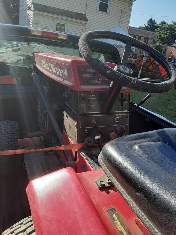

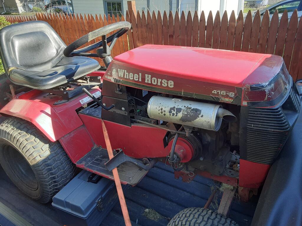

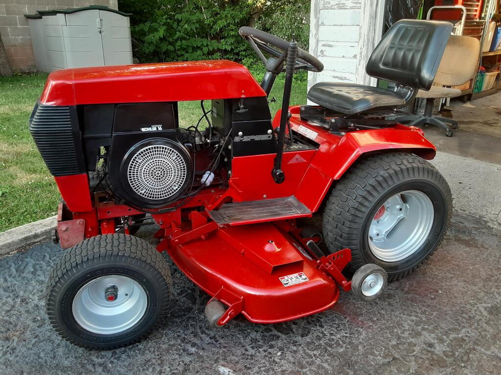

D_Mac 9,152 #1 Posted June 28, 2020 (edited) Starting this here even though I am close to completing it. Just wanted to show that if you buy a nice running tractor, with just a few dollars you can bring it back to looking as nice as it runs. I purchased this a few weeks ago. It was bought new by the family and was passed down from father to son, to brother. The last brother wanted to buy something newer. The 416-8 was scalping his lawn and didnt want to deal with it. I paid him and loaded it into my truck. At the time I didnt have a place to keep it so I brought the tractor to a friends house and the deck to my house. The deck I scrapped the underside, wasnt bad but had a rope wrapped around all the blades. Took the blades off. Took the guards off. Scrapped and sanded the top for painting. I noticed the leveling rod was broke, figured thats why it was scalping the grass. Ordered new rod and decal kit for the 48 inch deck. Edited June 28, 2020 by D_Mac 5 1 Share this post Link to post Share on other sites

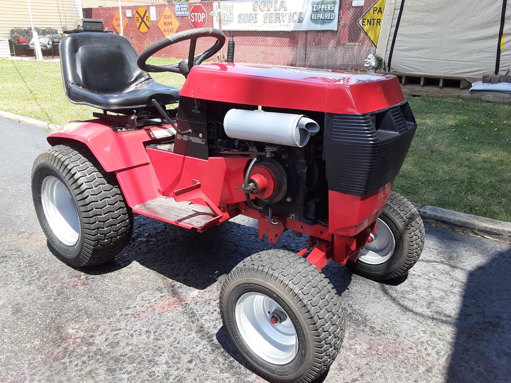

D_Mac 9,152 #2 Posted June 28, 2020 While it was at my friends house I did go over a few days to work on it. The tractor had black electrical tape as well as clear tape all over it. You can see it in the previous photos. Removed all of that plus the original decals and all the sticky residue left behind. Adjusted the clutch, tried to get the parking brake to engage but failed on that. Changed the oil, changed the fuel filter, installed new air filter, new spark plug. I also took off the blower housing and blew out all the nests and leaves and grass that had piled up since 1988. 1 1 1 Share this post Link to post Share on other sites

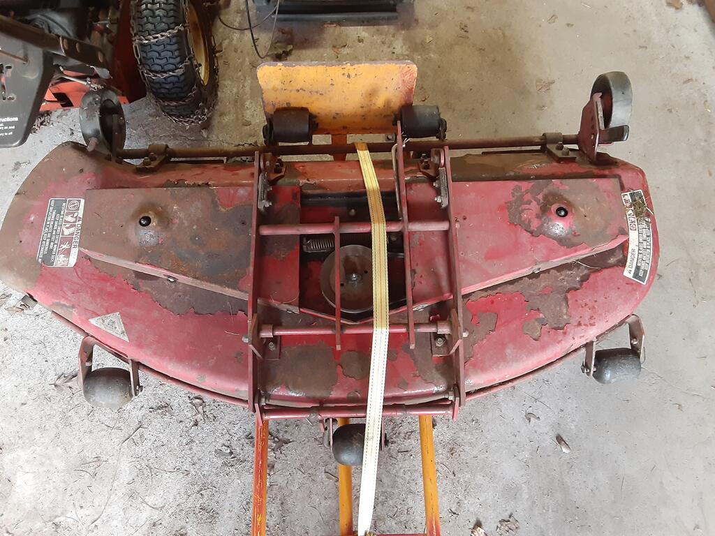

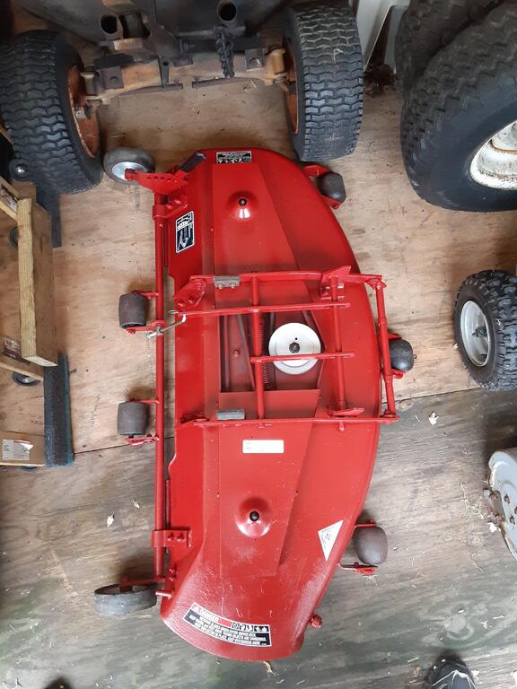

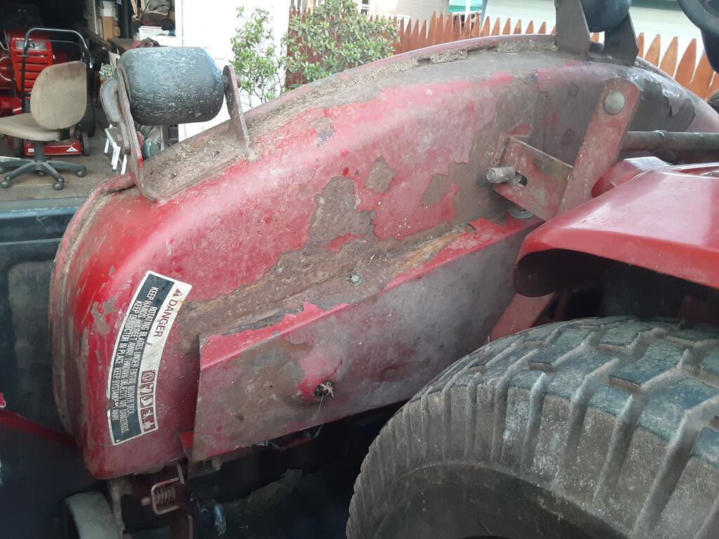

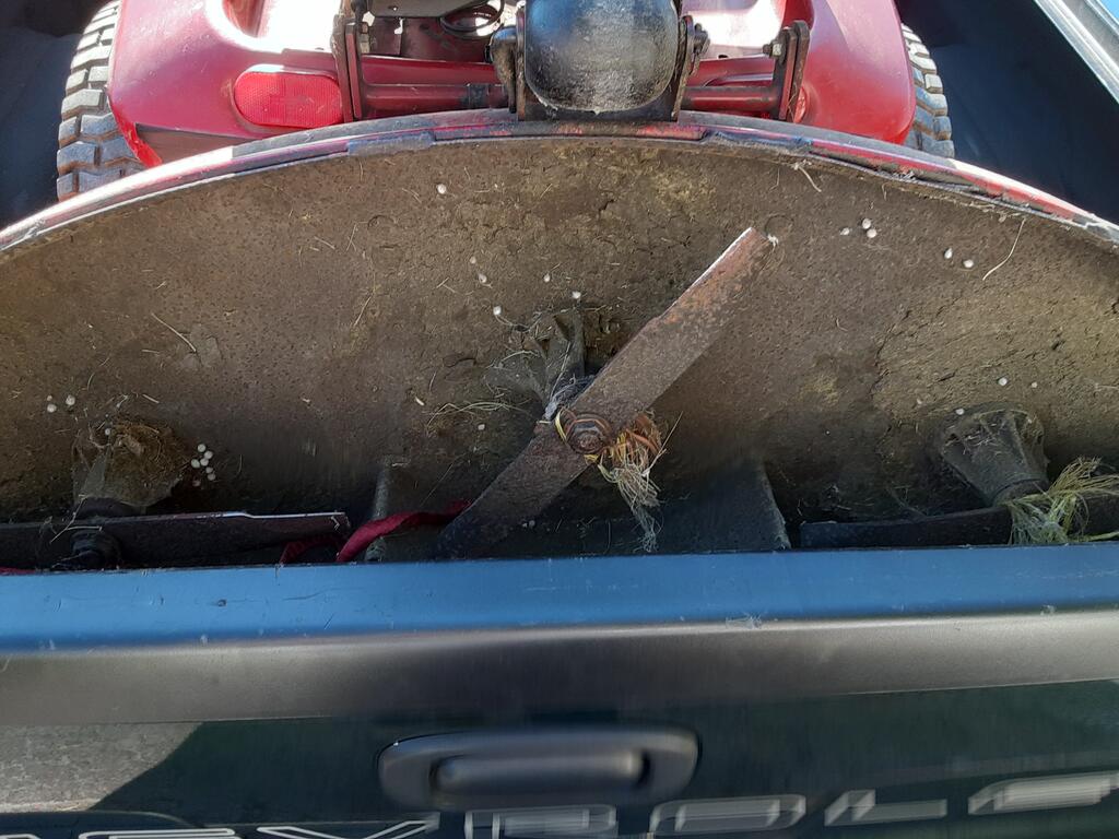

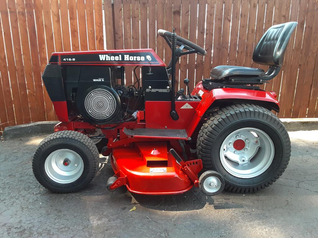

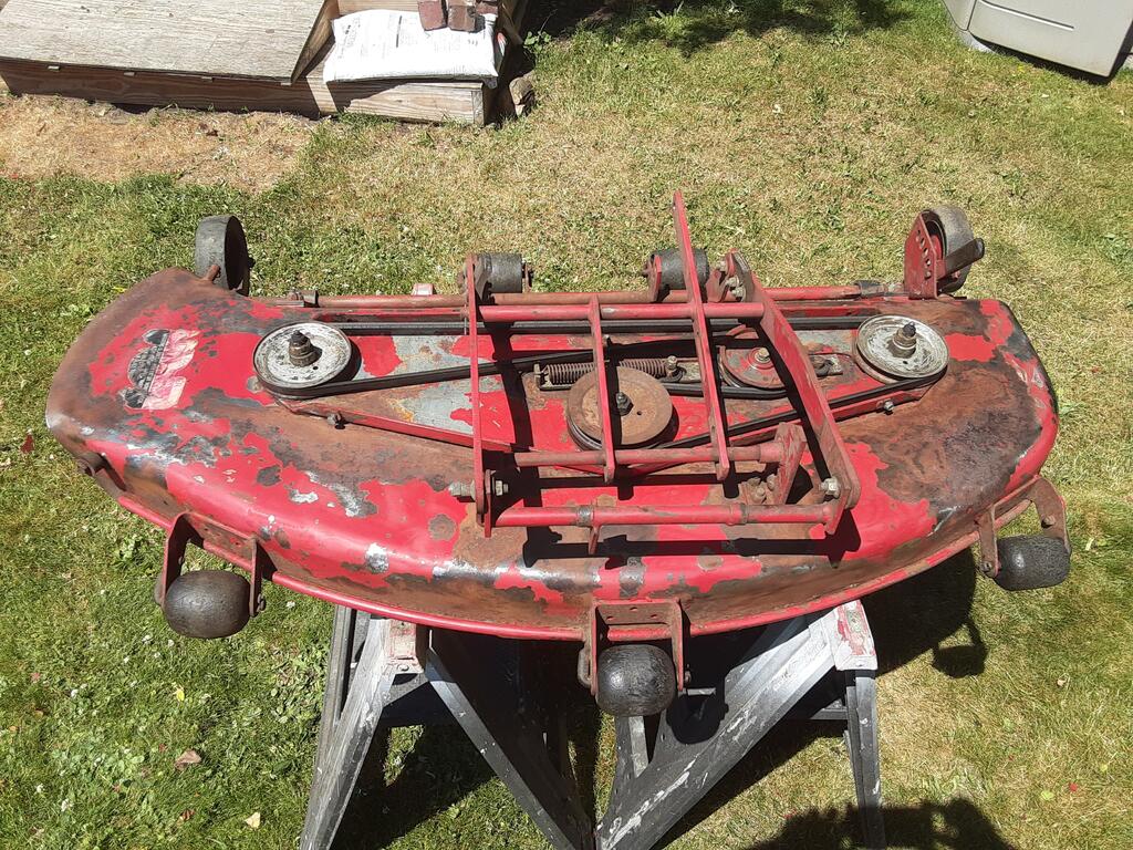

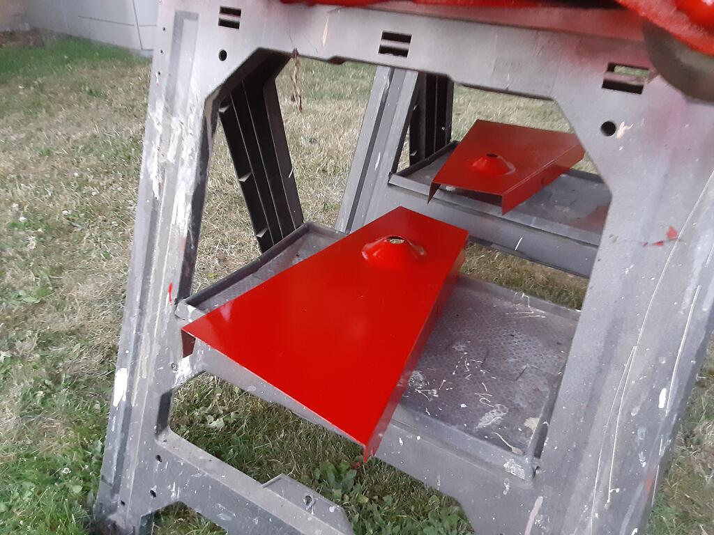

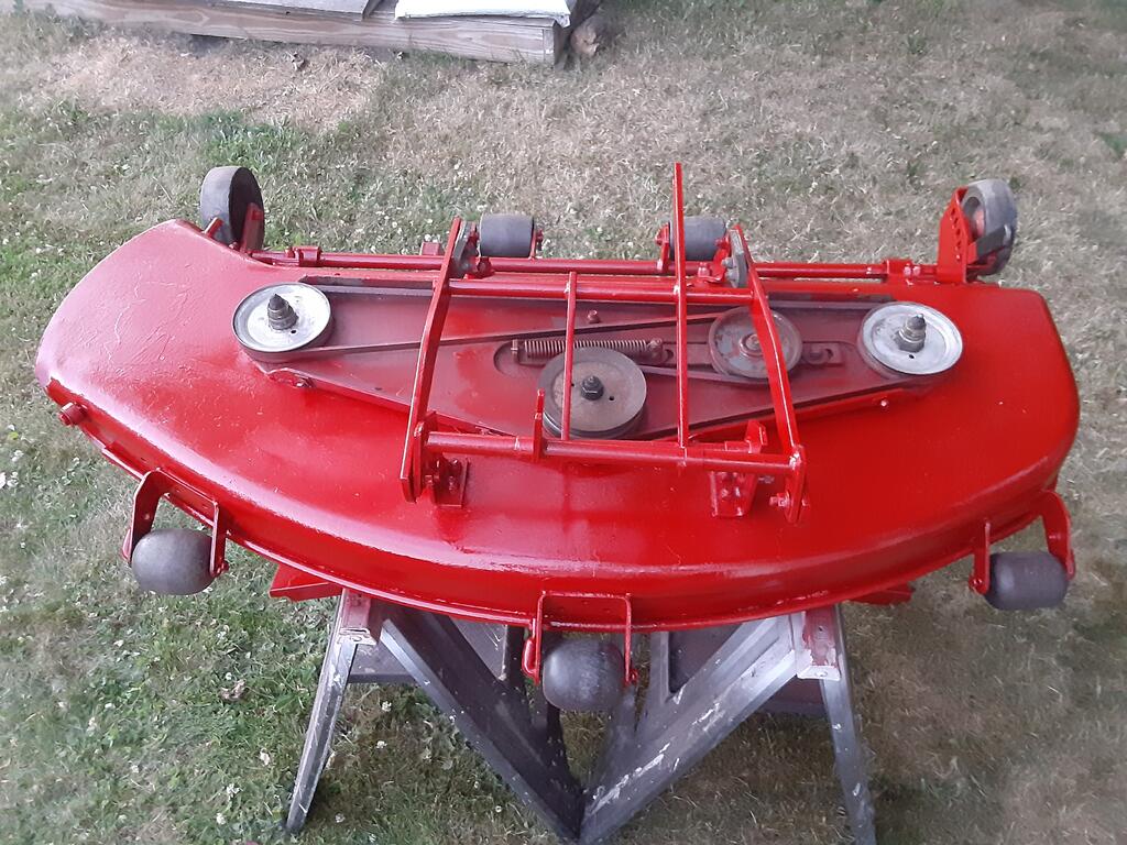

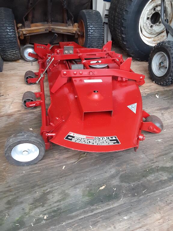

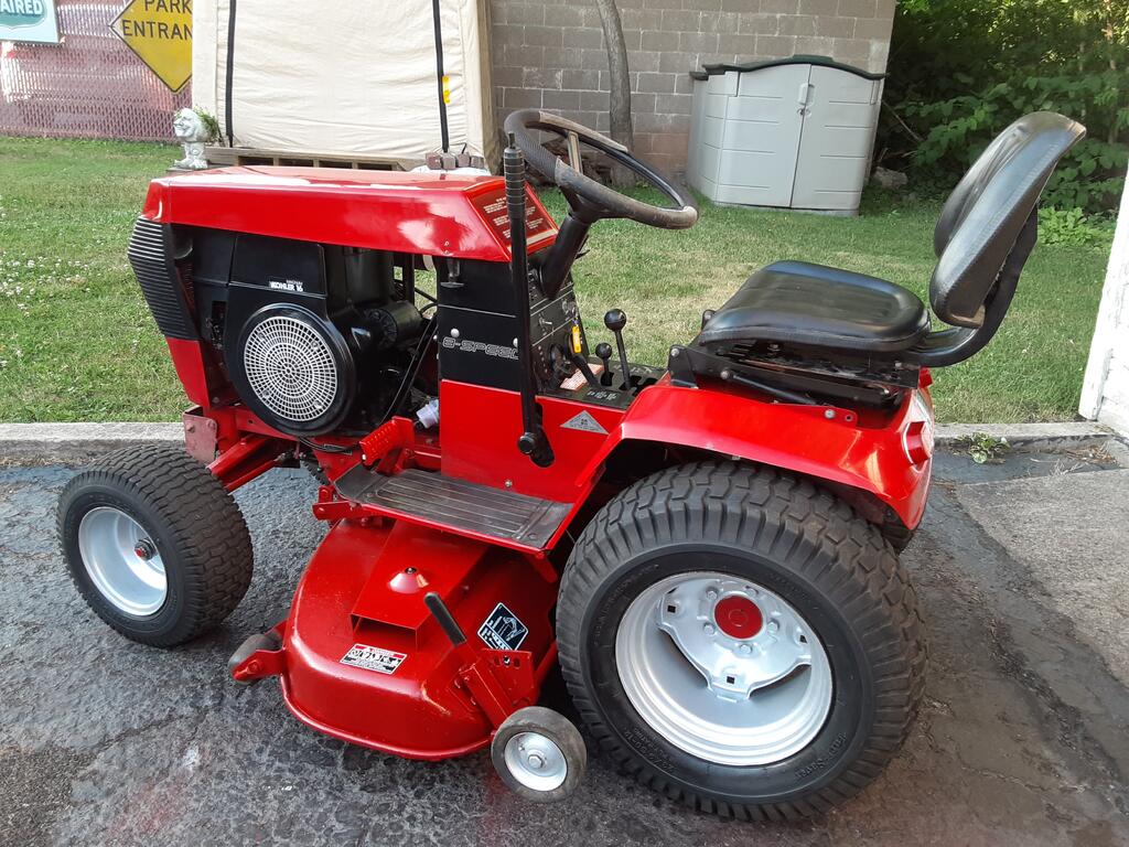

D_Mac 9,152 #3 Posted June 28, 2020 With the deck at my house I was able to scrap the bottom clean. I painted the top of the deck and the guards. had the blades sharpened and balanced. Put it all back together. Applied new decals. 5 2 1 Share this post Link to post Share on other sites

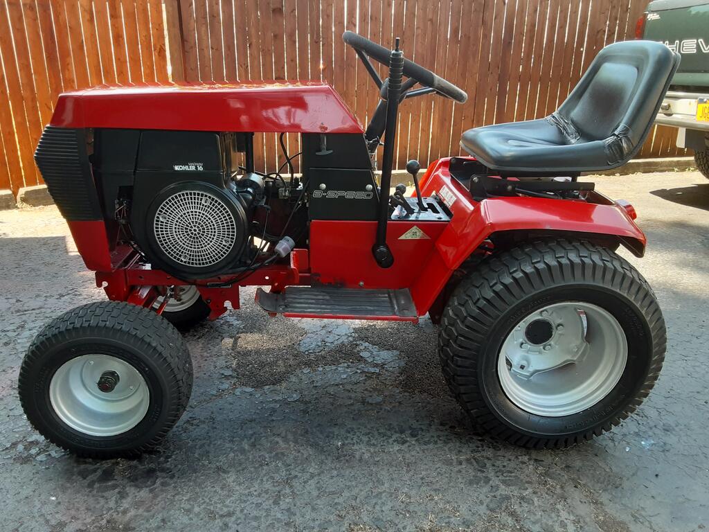

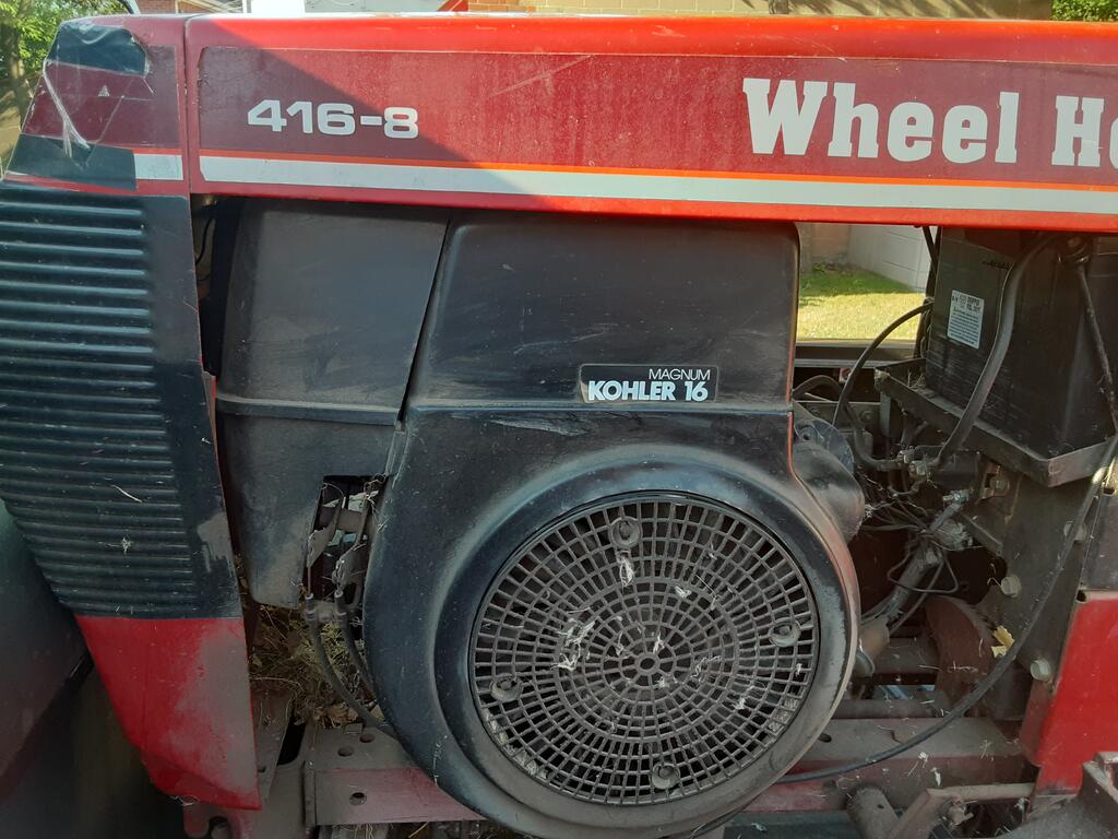

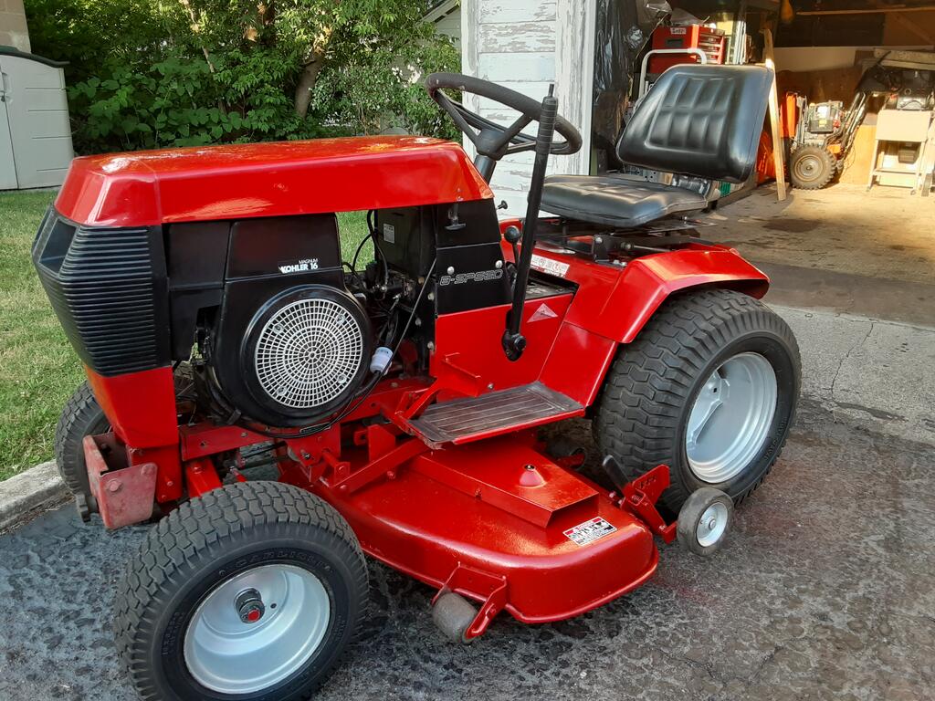

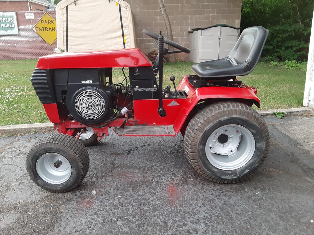

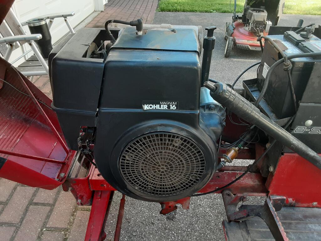

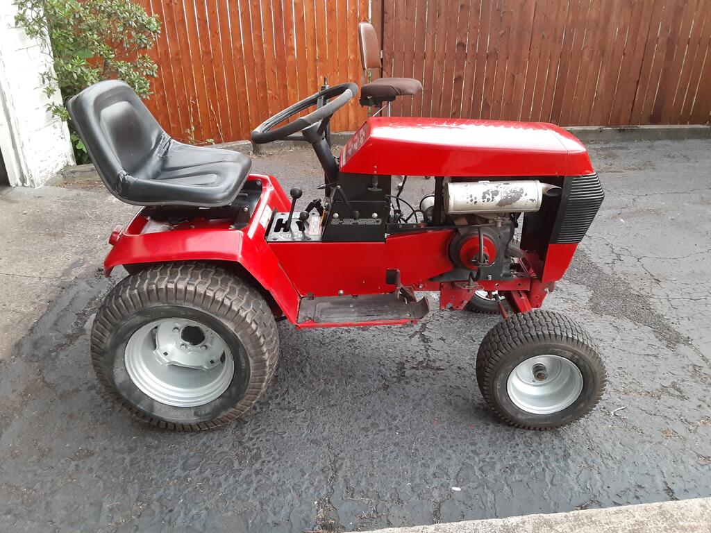

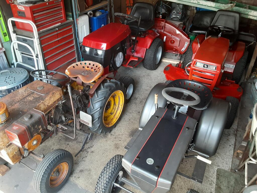

D_Mac 9,152 #4 Posted June 28, 2020 (edited) So I got my garage cleaned out so I could squeeze a 4th tractor in it. Wasnt easy I only have a one car garage and to get 4 tractors plus all my other stuff in there and still be able to close the door was a task by itself. Brought the 416-8 home to do some major cleaning. The 16 hp Kohler Magnum is running perfect. Sounds great. Got lucky there as the engine and tranny are rock solid. I degreased and power washed everything. I repainted the wheels back to original color as at one time they were painted black. Got out my tooth brush and cleaned every little nook and cranny. Brush touched up a few spots of paint. Except for the wheels its all original paint. Scrubbed the tires with a brush and reconditioned them. Painted the debris guard. PO had painted the muffler but some off the paint had come off so I repainted with High Heat paint. Greased all the fittings on the deck as well as the tractor. Edited June 28, 2020 by D_Mac 6 1 1 Share this post Link to post Share on other sites

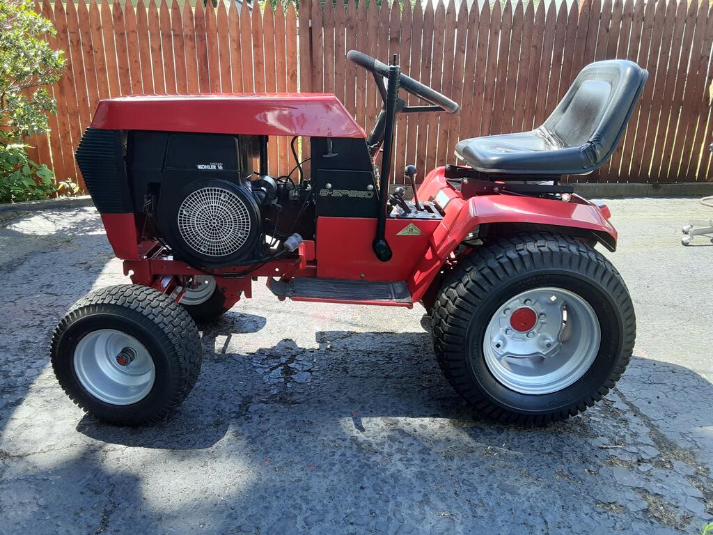

D_Mac 9,152 #5 Posted June 28, 2020 (edited) So after it was all cleaned and the paint work done it was time to install the deck. Attach O Matic makes that job easy. In a few minutes the deck was on. I had this tractor seat in my garage for awhile, since the original seat was ripped I thought I would put this one on. The seat is supposed to slide backwards and forwards. Well after I got it on, had to change a few things to get it to fit it dosnt slide back and forth to easy. I just set it all the way back as I am 6'5 and like the leg room. I had decals ordered for the hood and now at the last minute I am changing my mind. I will post when I make the changes but for now here is how it sits. I am happy with how it came out. Didnt cost hardly any money to transform it from what it was when I got it. Just some time and alot of elbow grease. It runs as nice as it looks. Kohler 16hp Magnum with a 8 speed tranny.... isnt that what most of us want? This tractor is a beast. Only things that I know dont work are the lights on the dash and the parking brake. Cant wait to finish it. Stay tuned for the finishing touch !!! Edited June 28, 2020 by D_Mac 3 9 1 Share this post Link to post Share on other sites

squonk 42,552 #7 Posted June 28, 2020 I want to see a pic of everything in the garage! 1 Share this post Link to post Share on other sites

D_Mac 9,152 #9 Posted June 28, 2020 (edited) Thank You @ebinmaine I have been following your builds as well. Like my title says, this is just a " refresh" . I didnt have to do any mechanical work as this machine was in good running condition when I purchased it. The only mechanics that I did was adjusted the brake and clutch. The oil change, regreasing, spark plug, fuel filter, and air cleaner I feel should always be done when acquiring a new machine. This wasnt a restore back to new or custom build. Just refresh on a budget. @peter lena Thanks for watching ! I could have used some help ! Stay tuned for its completion. One more finishing touch to go. I still want to fix the parking brake issue but dont want to spend the 100 dollars on a new brake band especially if I dont think it will fix the issue. No one seems to want to chime in on weather its just this tractor or are most like that. The dash lights I am not so sure if thats something I want to get into. Looks like trying to fix them might be like disturbing a hornets nest. Leave well enough alone. @squonk you want it you got it!! This is before I put the deck on. I had to rearrange them so both Horses are on the same side because of the decks. What cant be seen but is still in the garage is my 11.5 hp 32 inch snowblower, 2 generators and a wagon !! If you see anything you like make an offer !!! Edited June 28, 2020 by D_Mac 5 Share this post Link to post Share on other sites

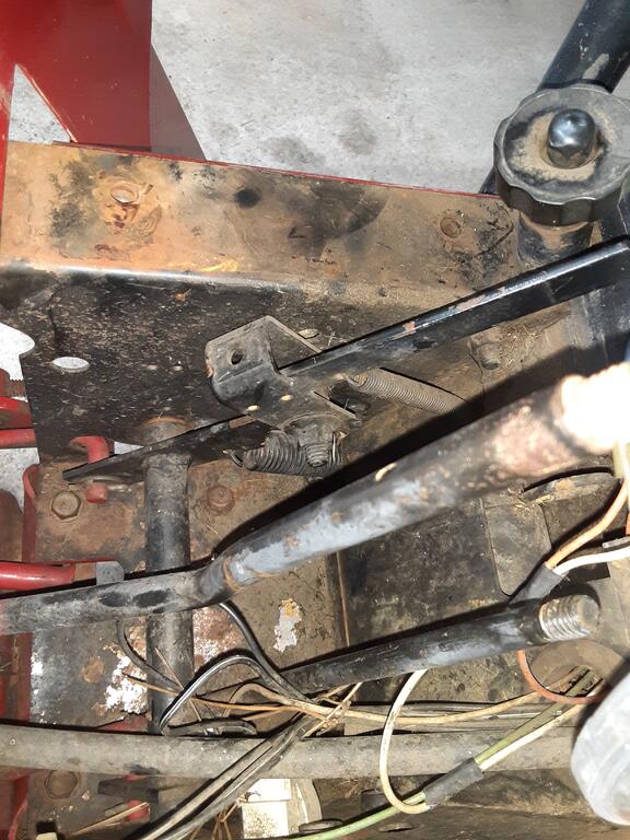

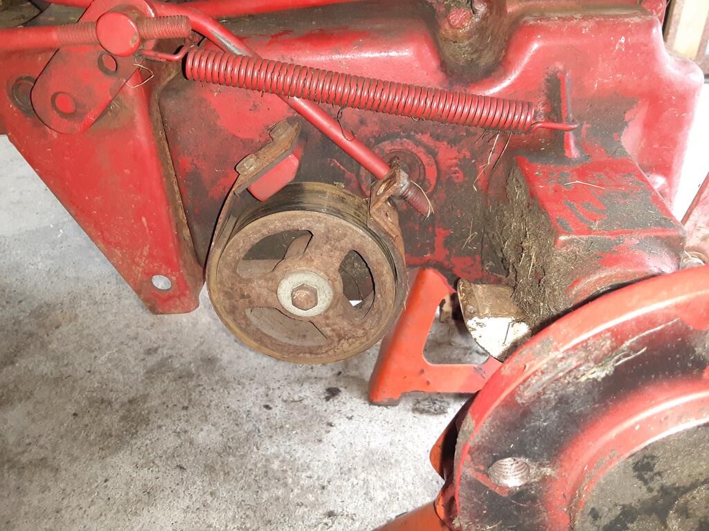

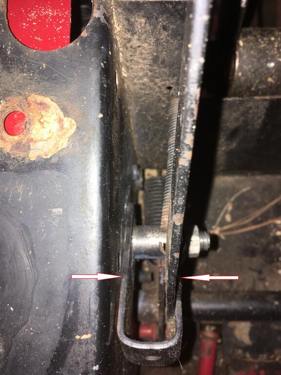

biged77 113 #11 Posted June 28, 2020 (edited) Looks great D_Mac. Painting the debris guard white is a nice detail too. As far as the parking break, I had a problem with my 416-8 also. It would not release by itself when the brake pedal was depressed. Turns out the U shaped piece was sprung, removed and used a vice to spring it back (see arrows). Easy fix if that's your problem. Edited June 28, 2020 by biged77 spacing 2 Share this post Link to post Share on other sites
Sparky-(Admin) 22,096 #12 Posted June 28, 2020 That came out real nice! 1 Share this post Link to post Share on other sites
D_Mac 9,152 #13 Posted June 28, 2020 @biged77 I looked at that piece 100 times, I didnt see anything wrong but I dont know what I am looking for. When I set the brake that U shaped piece is a long ways away from catching those teeth. If I loosen the brake strap so that U piece catches the teeth the brake wont stop it from moving. I dont think the brake strap is so far worn on mine that if I got a new one it would make much differance. maybe that U piece can be pushed back? Ill have to look again. Share this post Link to post Share on other sites
biged77 113 #14 Posted June 28, 2020 Mine works but it is on the last tooth. Share this post Link to post Share on other sites

peter lena 9,088 #18 Posted July 3, 2020 D-MAC the bottom side of that deck looks starved for LUBRICATION SOAKING , TO FEED THE METAL. if you regularly drop your deck and clean it out , that is the time to use a cable and chain lubricant on the entire bottom side , if possible prop it up to the sun with the lube on it , the deck gets hot and sucks in the lubricant , breaks the grunge cycle ,and your deck lives much longer . i like the rest of you article , good recovery on that , and a good horse to start with , pete Share this post Link to post Share on other sites
D_Mac 9,152 #19 Posted July 3, 2020 2 hours ago, peter lena said: D-MAC the bottom side of that deck looks starved for LUBRICATION SOAKING , TO FEED THE METAL. if you regularly drop your deck and clean it out , that is the time to use a cable and chain lubricant on the entire bottom side , if possible prop it up to the sun with the lube on it , the deck gets hot and sucks in the lubricant , breaks the grunge cycle ,and your deck lives much longer . i like the rest of you article , good recovery on that , and a good horse to start with , pete yes when I had the deck of for painting I went through it all, shapened blades, scrapped it, lubed it all. It had rope wrapped around the blades and spindles. 1 Share this post Link to post Share on other sites

D_Mac 9,152 #21 Posted July 3, 2020 @Darb1964 Yes that Kohler 16hp is a nice engine. I have two in my garage now. K341 and the Magnum 16. One Hydro one 8 speed. My garage will never have room to put a car in it, but it holds 4 tractors !! 1 Share this post Link to post Share on other sites
Darb1964 1,093 #22 Posted July 3, 2020 D-Mac I have three in my garage,four in my barn,and one in a shed, wheel horse. I have a 30-10 Kubota that is outside. Before winter I will need to do some rearranging to get them all in,don't like leaving any of them out. Kubota only out now because doing hay, weather permitting, not permitting last week or so. 1 Share this post Link to post Share on other sites

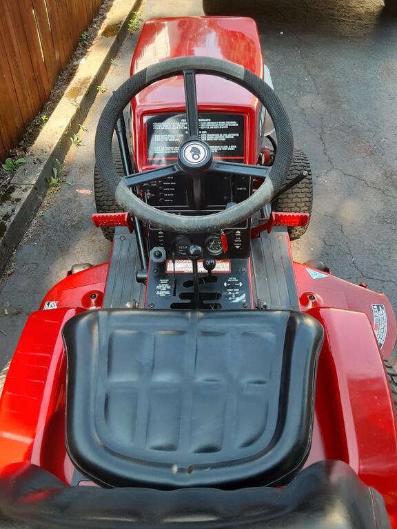

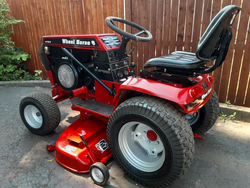

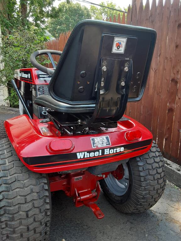

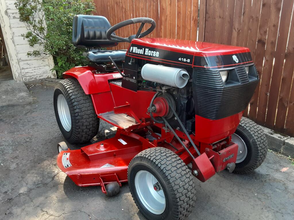

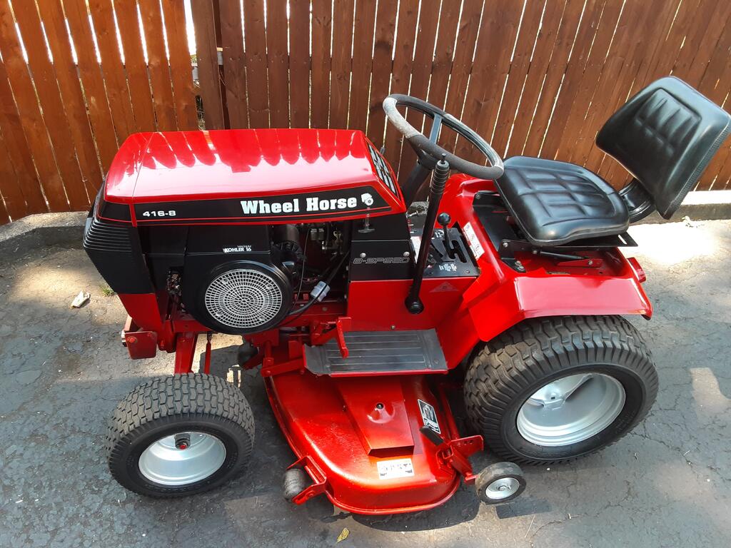

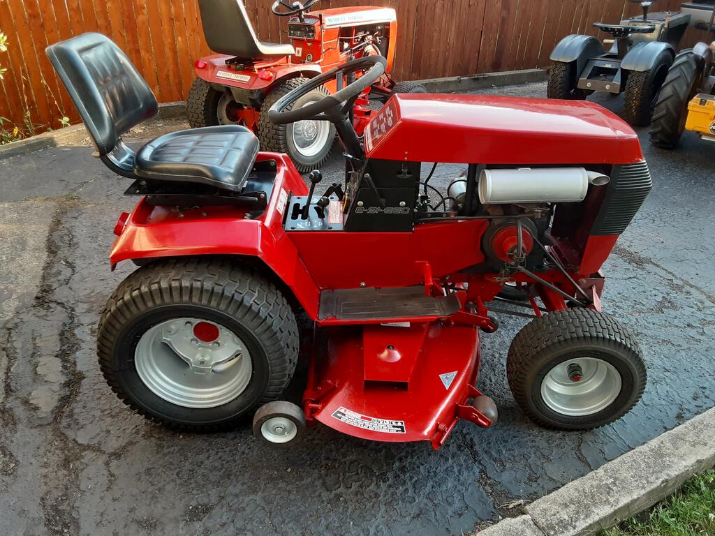

D_Mac 9,152 #23 Posted July 7, 2020 Well I finished off this tractor and I am very pleased with the results. My decals arrived yesterday from @Vinylguy. I originally ordered the original matching decals but then at the last minute I changed my mind and decided to go with the custom set. I am glad I did. I love the look. Take a look at the before and afters and let me know what you all think. Painted the deck and the wheels, the rest of it is original paint. Replaced the seat. Adjusted brakes and clutch. Changed oil. New fuel filter and air filter. New spark plug. Runs strong and looks great. I just like to show what a little elbow grease, a few cans of spray paint, and some new decals from @Vinylguy can do for your tractor. Thanks for looking. Look forward to your comments. 2 2 Share this post Link to post Share on other sites
