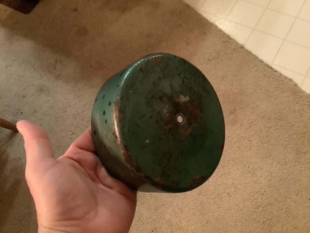

K-181 air cleaner (engine donor for Putt Putt) turned planter.

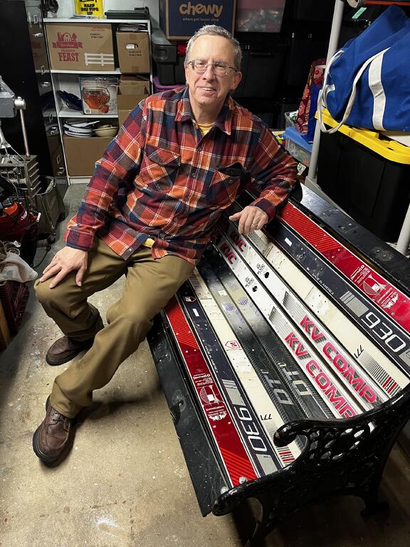

Yup!!!
Posts 139, 143, 145 and 146...
Try to look past the old guy...
Geez and to think I use them for butt kits ... Navy slang for ashtrays right @953 nut:lol:
Yes,          :confusion-shrug:          if you don't annunciate clearly that could be Navy slang for "go ahead and punch me in the face!"           :jaw:

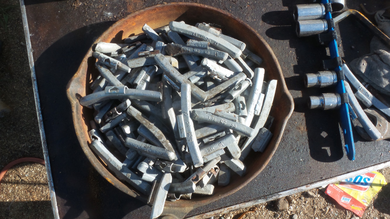

Offered to purchase but the tire shop instead gave me a few hundred pounds of wheel weights, some are Fe iron, some lead  and the sought after Zn Zinc that I'm after.
Fe - iron is magnetic
Lead is soft with a low melt point, when struck against a metal object has a dead sound
Zn - Zinc a harder metal than lead has a higher melt point, has a ring tone when struck against a metal object.
Sorting is a tedious scutt job, I'll keep the zinc and give the lead away to someone casting bullets or fishing weights.
The fry pan is zinc.
If you melt both lead and zinc wheel weights together, as the molten metals cool down the zinc cools quicker than the lead forming a  crust that can be skimmed off of the still molten lead.

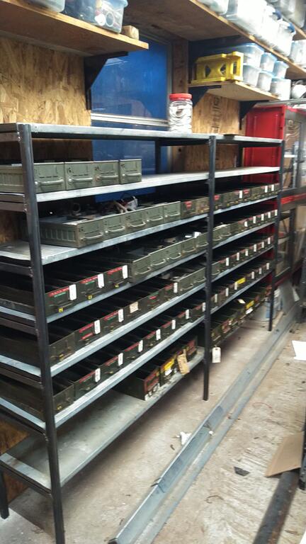

I was given 2 - 3' x 8' metal adjustable shelving units a couple years ago. The shelf material is 12" 16 gauge c channel. I was hoping to put them in a storage shed one day. I still may do that and use plywood for the shelves but I decided to upgrade some cheap metal shelves in my shop. Now I need to remove all the old labels and organize the bins.
Before
After
Sorting complete

4 hours ago, JPWH said:
decided to upgrade ******   my shop
Excellent work!

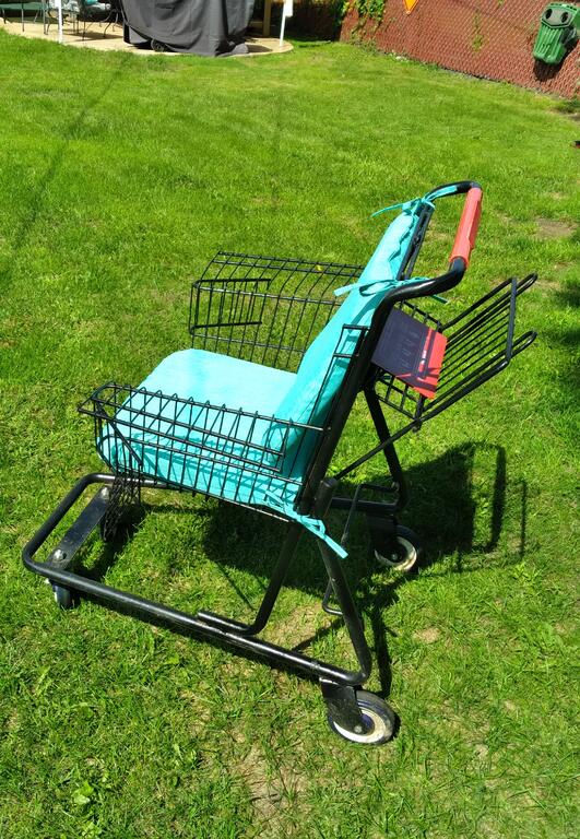

I like this topic. Hope to see some more great ideas. Made these chairs out of shopping carts. Nooooo I did not steal the carts. I pulled them out of a junk pile. When I loaded them into my truck I had no idea what I was going to do with them. Got the idea off the internet. Surprisingly how comfortable they are. Great for the back yard fire pit.

Man, it's a good thing we didn't have those as kids. Riding crunched up uncomfortable as heck while completely uncontrollable down the mall parking lot hills is probably what limited more runs. Doing that in comfort and style would of undoubtedly increased the amount of runs by 10 fold and probably end up with more serious crashes as a result. Once we discovered motorcycles and things with engines, that cart would've been occupied going 20-30 plus MPH easy on the end of a rope. We were all huge jackasses way before it became popular on the net. No helmets either. It's amazing how no one was killed for some of stupid things we were doing. But just like any other young person now, let's blame someone else like Evil Knevil for making us do it! LOL
And fire proof except the cushion!
7 hours ago, wallfish said:
Once we discovered
 engines, that cart
Somewhere on the interwebs  there's small GO-cart chassis with shopping carts attached over the top.
:scared-eek:

7 hours ago, ebinmaine said:
And fire proof except the cushion!  And the occupant?!

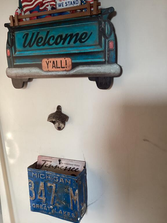

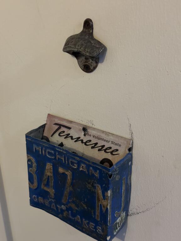

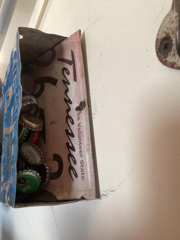

Sometimes I don’t realize I have something special, until I do.  I made this bottle top catcher about 15 years ago, give or take.

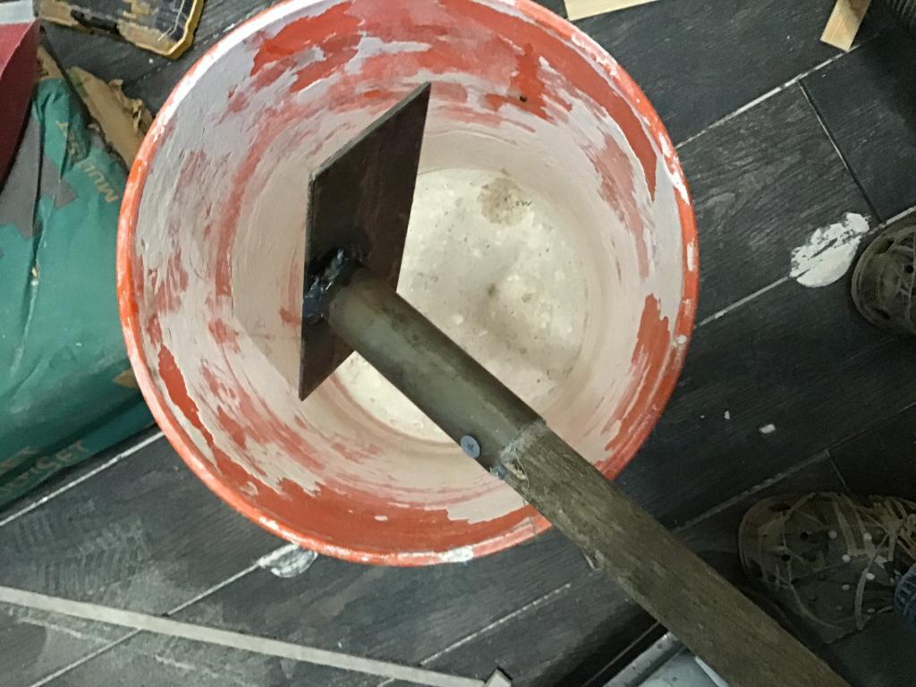

I need a garden hoe to mix the mud.  I can’t find it.  I believe I recall it broke.  I found an old broken handle and made up a few bits of steel.  Whaaah lah!

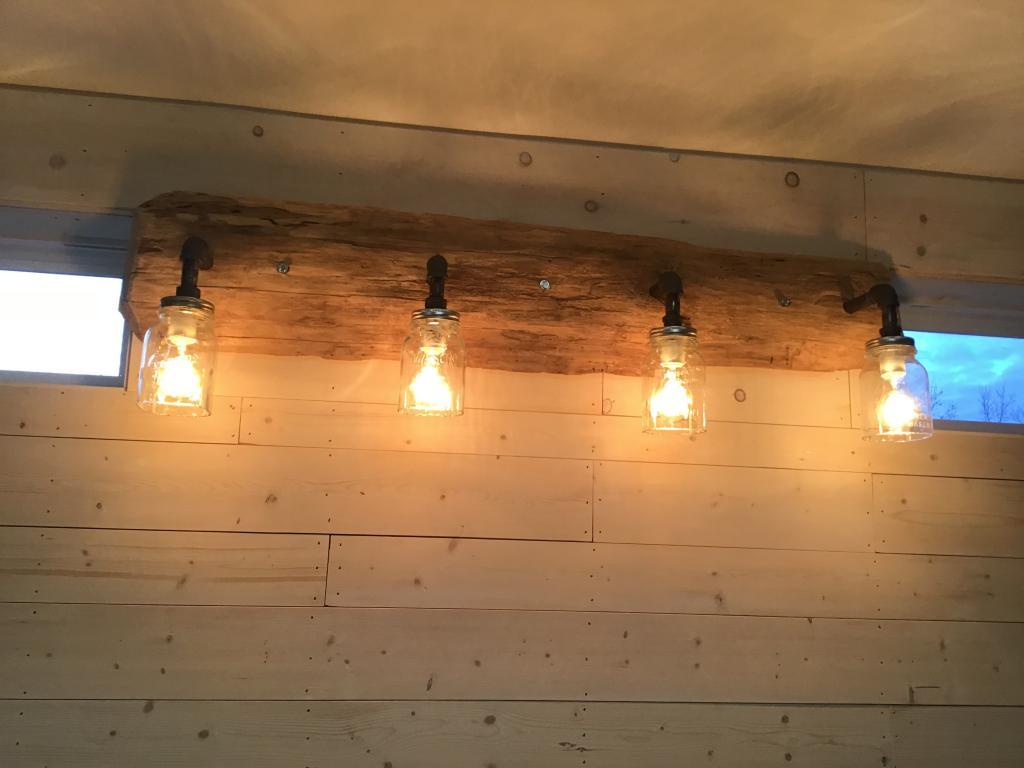

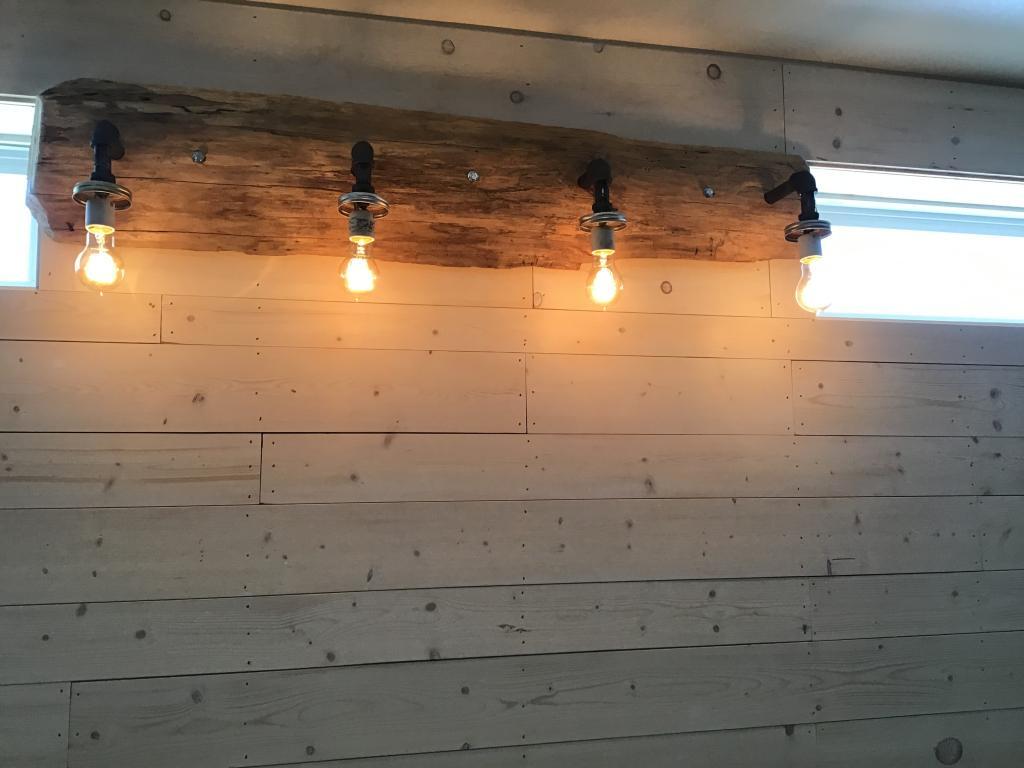

A piece of ash tree, some pipe fittings, some bottomless mason jars and a chainsaw helped make this light fixture.

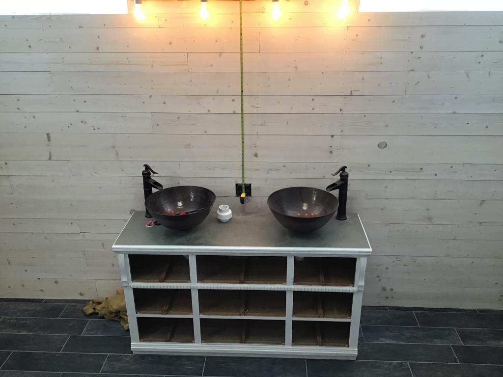

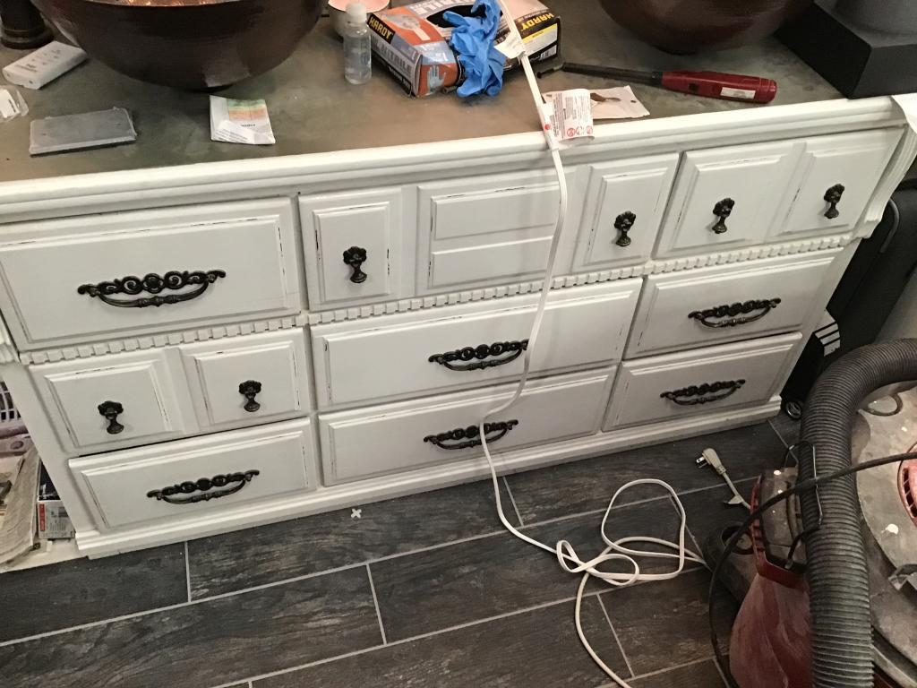

Below the light, an old dresser and some creative saw and pipe work to build a vanity.  Yes, the drawer inserts I built warranted the flip flopped drawer layout :lol:
