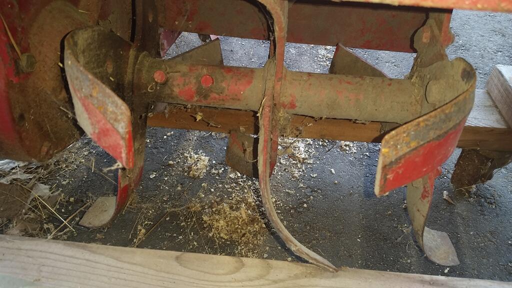

lynnmor 7,448 #9 Posted June 21, 2020 The tines are about spent. A-Z has his aftermarket kit listed on Ebay for $540! Share this post Link to post Share on other sites
McGrew 460 #10 Posted June 21, 2020 Guys, Thank you for all the responses. I really appreciate it! This tiller did come with the mid mount brackets and pulleys, (owner sent me pics) but I am going to pass on this tiller. I will keep my eyes open for another, as I definitely have use for one. I assume the rear mount bracket is the same one that mounts the dozer (snow?) blade? The tiller did not come with them, but the mounts for the dozer blade I already have. And yes, the new tines are expensive! Thanks again! Danny Share this post Link to post Share on other sites
