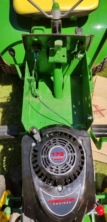

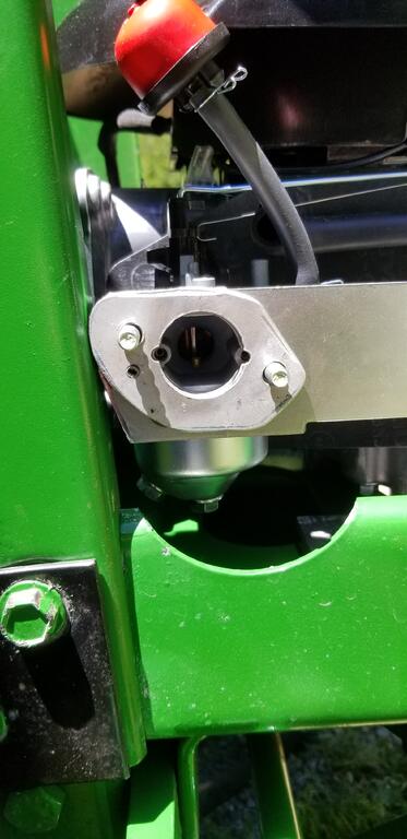

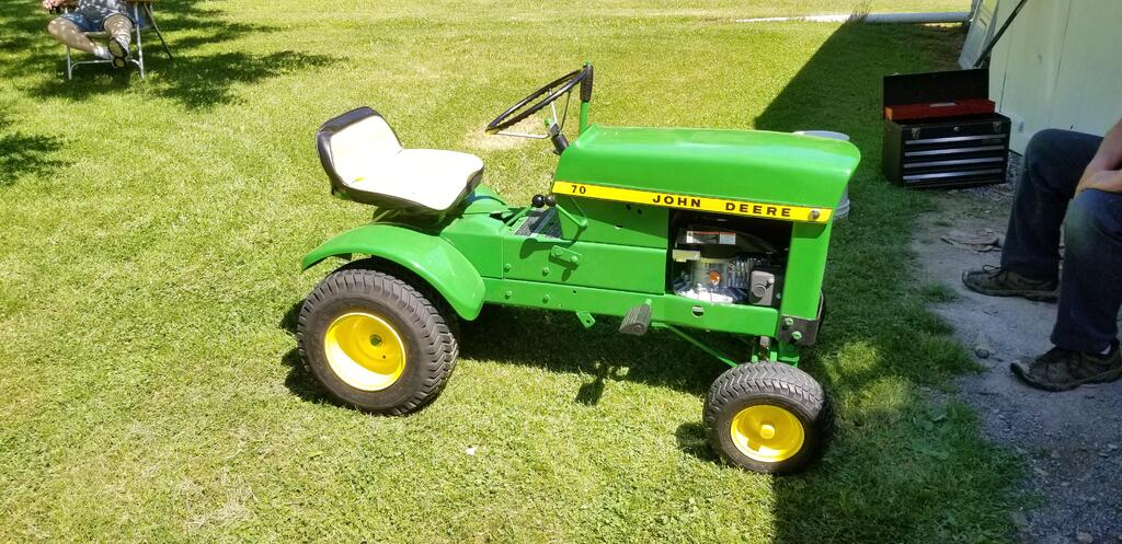

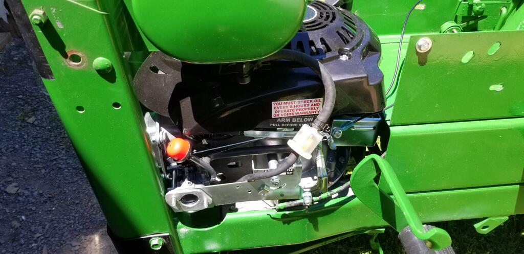

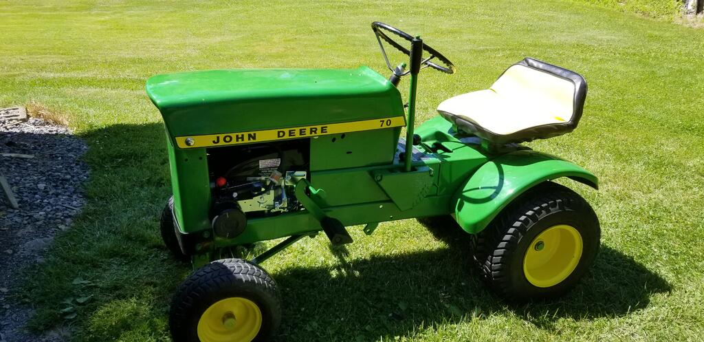

Mike'sHorseBarn 3,055 #1 Posted June 15, 2020 I've had this little 70 for probably 15 years now and the V70 Tecumseh that was in it gave up the ghost so I decided I would try a HF engine. That little Tecumseh was a very compact little engine so you can't get much more than a 5hp engine in there of any brand so the 5.5hp predator fit nicely with some modification. I had to put a 1/4" aluminum plate under it to raise it so it wouldn't hit the axle underneath when the pulley was on the crank. I had to grind the back of the oil pan off a little bit to give me just enough clearance so it sat just far enough behind said axle. The factory intake would't fit at all so I modified the original Tecumseh intake to fit. To do that I had to make and a plate to keep the intake from hitting the front grill and so the atmospheric vent in the carb would vent to the outside air. I have a motorcycle breather filter ordered to put on the breather tub of this and the primer bulb is just kind hanging around on there. I'll never be able to use the PTO on it, but I never did anyway. That little 5.5hp runs pretty good and it will haul my fat butt up a steep hill in 3rd gear so it will do everything I want it to do. It wants to surge just a little bit at idle since I put a different intake on it so I'm assuming I will have to drill out the idle jet just a little bit. Overall not a bad experience. Got me thinking about those little WH Reo Rear Engine Riders, if I ever see one with a blown Tecumseh I could drop one if these in there fairly easily! 6 Share this post Link to post Share on other sites
