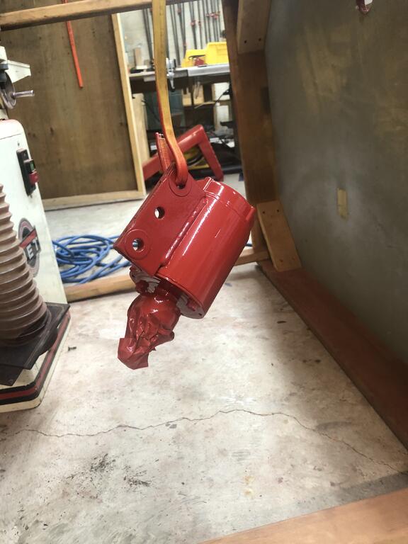

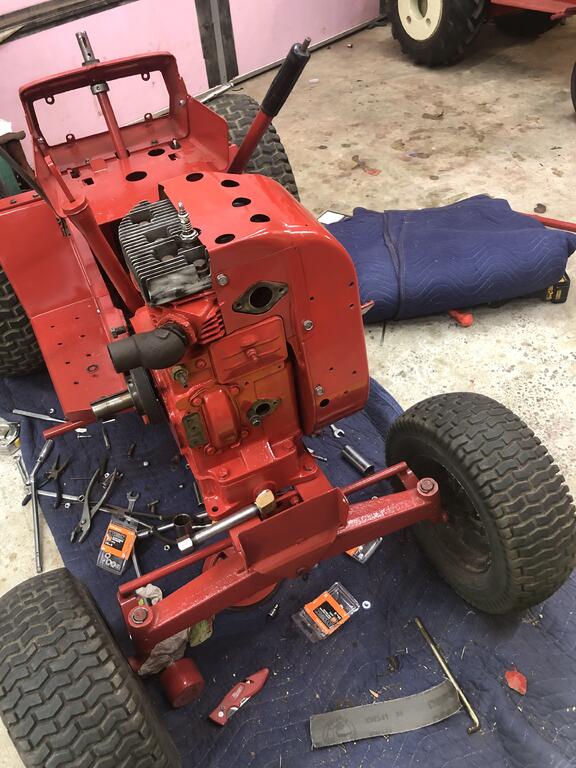

Sitting here listening to some Clint black music trying to get this charger back together. Started to venture on the starter of all things. Went out to the shed and grabbed two or three and brought in and ran a check on each one. Got one that works great cleaned it up put some paint on it and it's ready for installation!

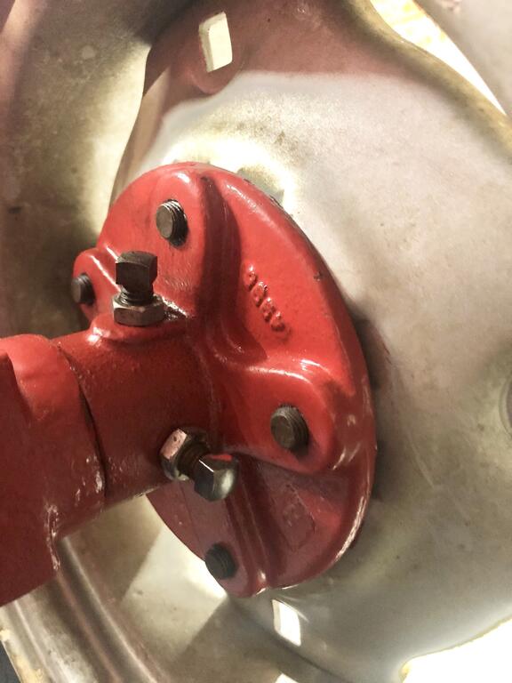

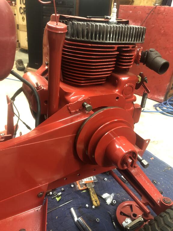

I drilled out and tapped an extra hole in the hubs as well and threaded for another bolt.
Likely a little late now but the hub should have a flat ground into it so the set screw jamb nut will be less prone to backing out.
The Tuul Crib
Thanks for the tip! Easy fix. Drilling
and tapping was no probably. I'll have to get the grinder Out tomorrow and flatten
that spot!Might still add a flat washer and a spring washer in that area as well

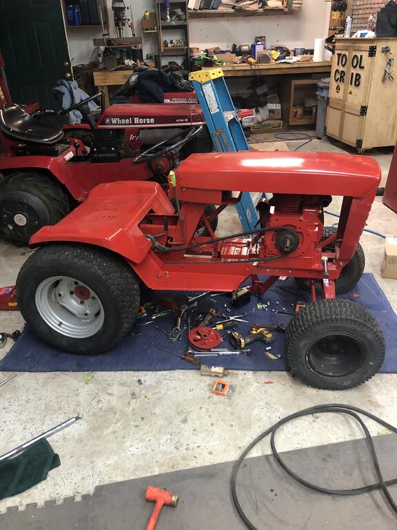

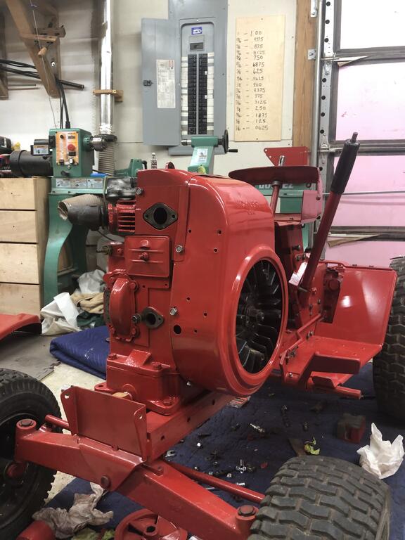

Got home today and fully mounted
all the tins. put all the small bolts back in place now I'm searching for a carburetor!

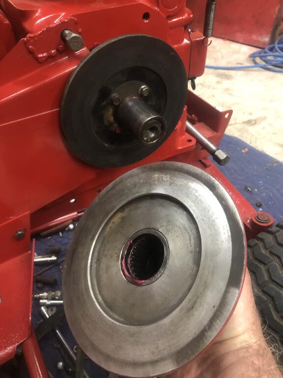

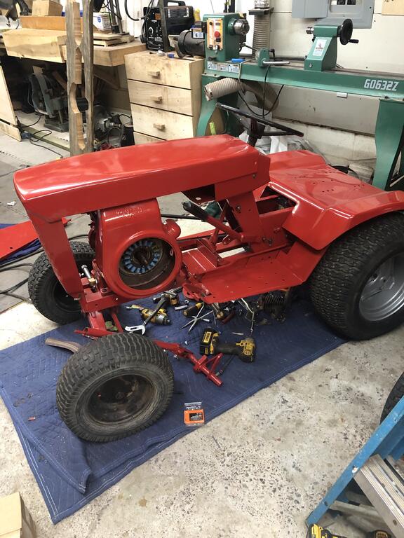

Finally passed on from the transmission
to the power plant .This 30 over 16 needs to be born one bolt at a time.Got the PTO cleaned up and painted.
