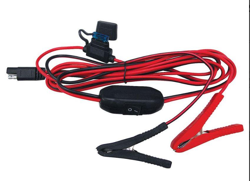

I was looking to power my tow behind sprayer.  Are there any optional power outlets?  I can always runs something off the battery but would prefer something a bit closer to the back.  And of course find a good place to mount a switch.
The included wring won't quite reach to the battery.
DET
I just ran mine off the battery along the frame to the back. I plug my sprayer in there and just loop the switch around the hi-low selector so the on/off switch is handy.
mdtoro

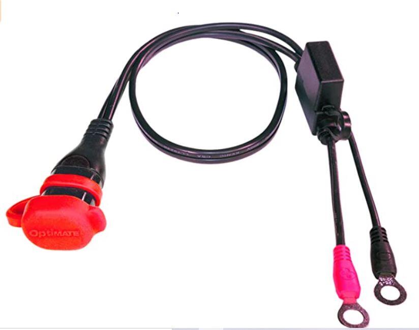

I decided to add this connector off the battery and dump the alligator clips for SAE connectors.  The battery isn't really accessible for alligator clips.  Might mount a perm weatherproof SAE style connector to the back of the tractor.
