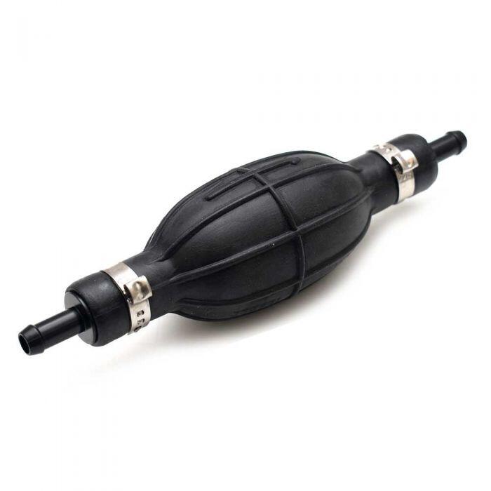

wallfish
The problem with starting is typically the fuel draining back to the under the seat tank. Adding an electric fuel pump or one of these primer bulbs improves starting dramatically.
