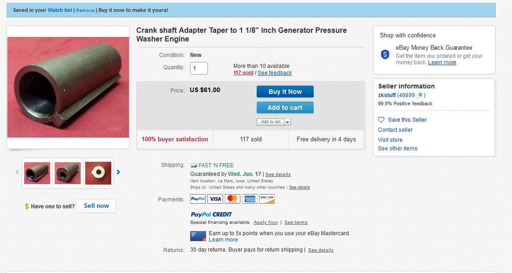

bds1984
The only primary concern I'd have is making sure the crankshaft is long enough.  I have come across a few M16s that could have been had for almost free, but the cranks were either 1" long or tapered.
