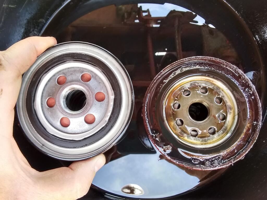

bottjernat1 2,190 #1 Posted June 8, 2020 I cant believe folks don't know how to change oil! I changed the oil in the 1976 D-160 in the transmission and the Onan bf ms 2929 motor. She runs and drives a bit better! I used my wix filters and SAE 30 in the motor and 10w30 in the transmission. That is what the book calls for and that is what i used. Im pretty sure this is the original filter! Eww! 1 Share this post Link to post Share on other sites
