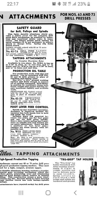

Mickwhitt 5,014 #12 Posted June 5, 2020 And here it is in a catalogue... The larger belt guard is shown as a production item to satisfy your health and safety codes. Could not have found that information without Cas pointing the way. Mick 4 1 Share this post Link to post Share on other sites
