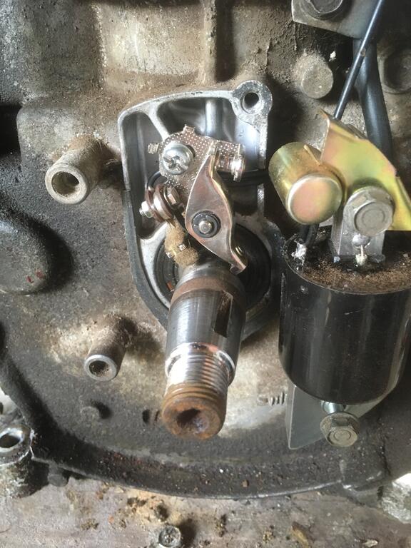

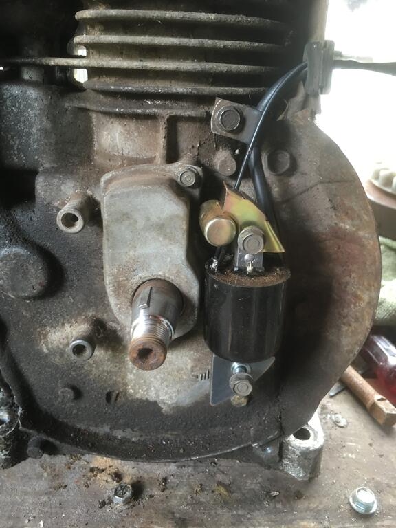

Ganers 0 #3 Posted June 4, 2020 To clarify. The fly wheel has a magnet with the coil inside. I’ve attached a photo as it was originally with flywheel removed, it’s pull start. I checked the points with all wires from condenser and coil removed to ensure continuity when they closed and not when open I also checked the grounding of the points. Then I checked the condenser with a multi meter to ensure it charges and discharged. I then replaced the coil which came with a condenser attached which I also checked. Still no spark. Believing it could be a new bad coil I bought another from a different supplier again with attached coil, still no spark. I cleaned all ground points still no spark. In desperation I bought a CDI UNIT which is supposed to replace points and condenser, the wiring diagram is crap but shows it taking the wire from the coil to the unit and you do away with both condenser and points. Still no spark. The flywheel has been cleaned and brushed and the magnet is still strong. I’m completely stumped. Cheers Lee. Share this post Link to post Share on other sites
Tractorhead 9,087 #4 Posted June 5, 2020 The thin black wire from the Coil was the Stop line. check with an ohm meter if you moving the flywheel gently, there is a resistance measured. if there is continousely ground, you seems to have that wire somwhere squezzed. as far as i know the g300 has an additional oil sense stop. maybe that interrupts you Engine. as far as coil was in, the points have enough gap to work, and the thin black wire( stop line) is off ground, you must have a spark. tried with another sparkplug? Share this post Link to post Share on other sites
Ganers 0 #5 Posted June 5, 2020 Hi. Ive swapped out the condenser and kill wire completely, as I now have three, the points were gapped and confirmed with a meter, and two different plugs tried still no spark. Ive been all over it and can’t find an oil level cut off so I don’t think it has one. Its so simple a system it should spark, but it doesn’t. Share this post Link to post Share on other sites
