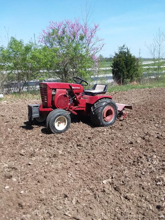

I put a k301 on my 856 used a Cub engine with the flat pan but I did have to notch the frame for the flywheel housing and I put the battery in the tool box under the seat.
Pretty much exactly what I was thinking right there. Even the battery re-location as well.
Were you able to re-use the stock pulley and belt guard? Or was the crank location too far off?
ELECTRORIC
I changed trans to a 8-speed and had to change pulley sizes had to make a new belt guard but I would think if you keep pulleys the same your belt guard should work may need to change mounting flange were it mounts to engine
