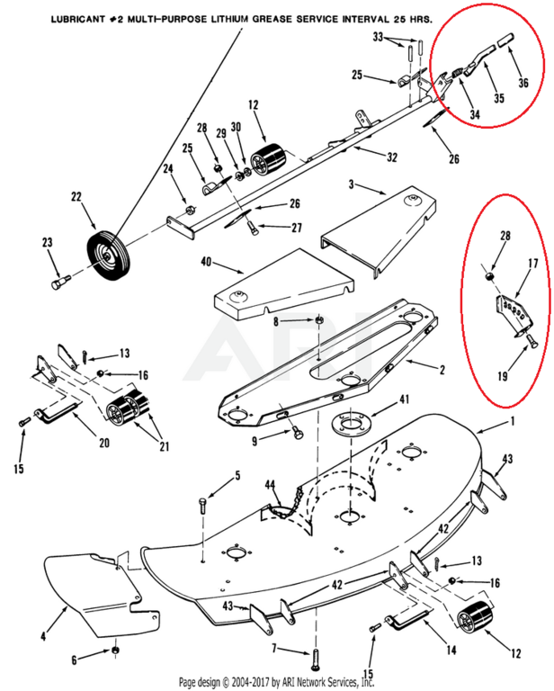

daveoman1966 3,884 #2 Posted May 29, 2020 (edited) I have the replacement parts you want... the quadrant, handle, spring, etc... for the height adjuster on the 48" deck. My email is: daveoman@windstream.net. Send me an email and we can pursue this...will get pics / schematic is a bit. What is your ZIP CODE... Here---in RED--- are the height adj parts... I have all of these. Edited May 29, 2020 by daveoman1966 Share this post Link to post Share on other sites

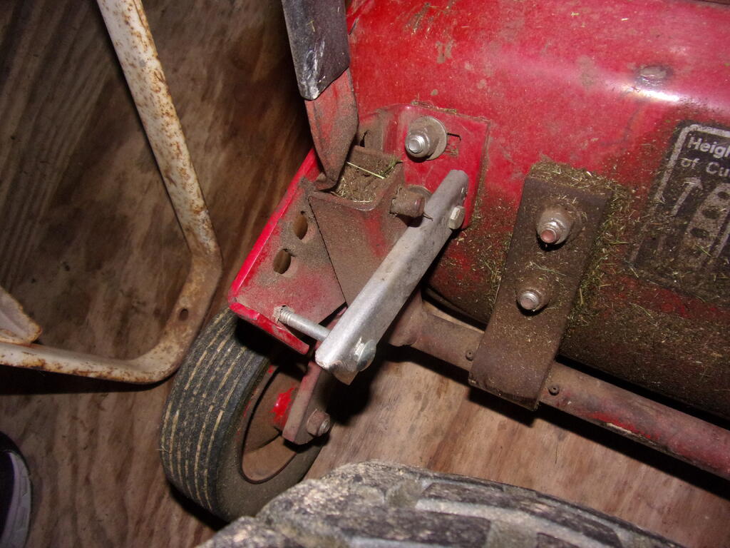

Ed Kennell 47,041 #3 Posted May 29, 2020 This is what I did to fix my loose adjuster. A flat bar and two 1/4" bolts and Nylock nuts. It keeps the assembly together and the pin in the hole. Just tighten enough to keep it together and still change holes. Easy Peasy. Share this post Link to post Share on other sites
