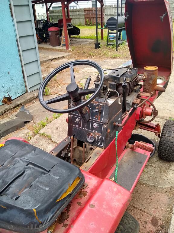

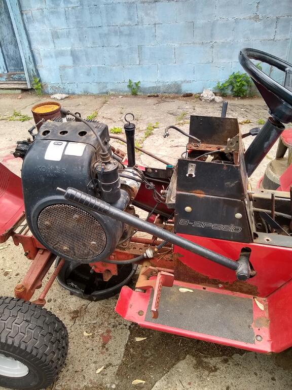

help does anyone know what year this 312-8 is? has a kohler 301s
The Tuul Crib
Had one just like it . Looks like
1986 1987
kasey54
As reported by tractor data 312-8 used k301 engines 1985 thru 1986. Then the Kohler m12.
:text-yeahthat:      Under your seat there is a decal with a model number on it (if it is legible).   1985 is Model # 21 12K801 and 1986 is 21 12K802 or 21 12K803.

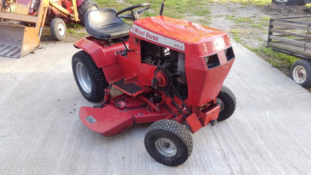

Thats kinda interesting, my 1985 310-8 has the magnum 10. You would think they would switch the whole line at once. Maybe it had to do with what was available from Kohler.
Randy
Randy
:confusion-confused:                Have you owned this since new?
RandyLittrell
17 minutes ago, kasey54 said:
 #5
Posted 5 minutes ago
Yes it is. wonder if its been replaced?
Nope, she all original.
RandyLittrell
No, but I did buy it from the guy up north of me that was a big collector and had the N.O.S. Wheel Horses. I do believe what he told me and it shows no signs of being worked on.
Randy
kasey54
Well , we have all heard of these things , but usually only one year off.
RandyLittrell
I just pulled up some more pics and I do have the K241, I guess I was thinking it was a magnum because of the flywheel starter instead of the starter/generator on my 1277. Sorry fella's, old age sucks!!!
Randy
Edited by RandyLittrell
kasey54
No worries I'm old too , lol
