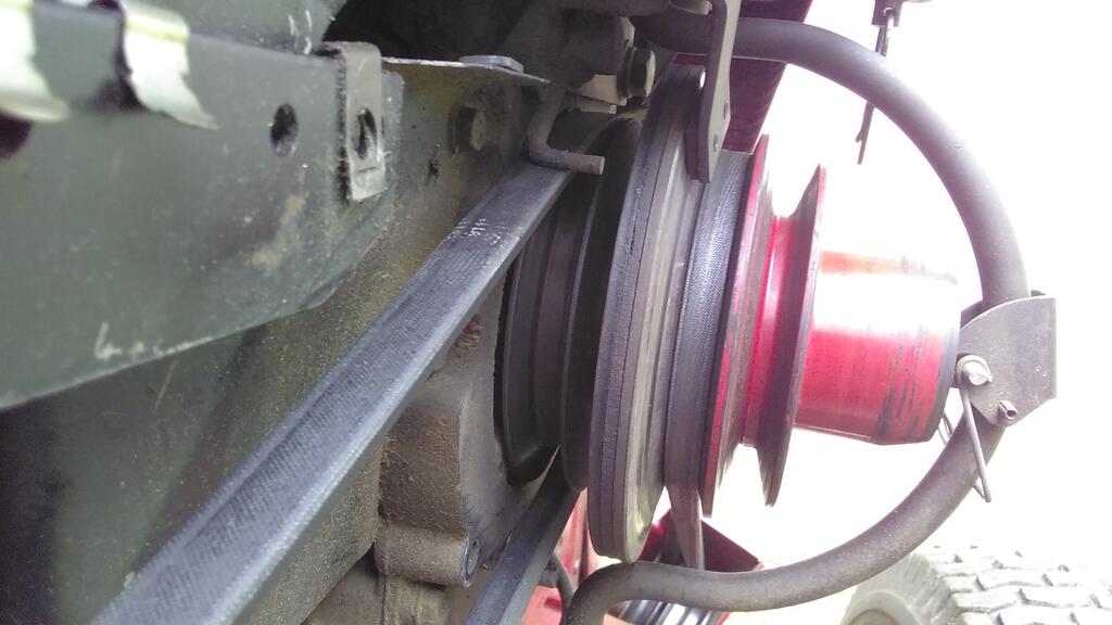

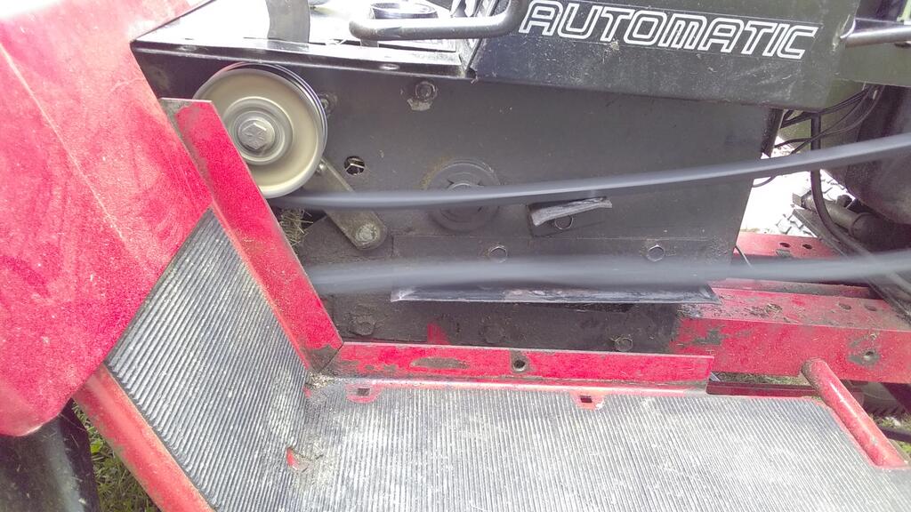

I have a 1985 Wheel Horse 417A 31-17KE01.  When I pull up the lever to disengage the drive, the belt will continue to move erratically (slow, speed up, repeat.)  I've attached a couple of pictures, and have a one minute video showing how it's operating... (this is a OneDrive link, if it's not working someone please let me know.)  I wish I could provide more info in my post, but I don't know enough about what's occurring here to do so.

The belt guard supports the bottom of the belt near the engine pulley so try installing the belt guard

It's doing this while the guard is installed as well.  I pulled the guard off to try and repair.  The guard wouldn't prevent the belt from engaging... is that pulley on the engine supposed to still be moving?

@the jeep driver look at the belt itself. The belt may be sitting down in the pulley to far and this will cause the belt to do what your describing. I have a 1984 C-145 that when I pulled up the handle to disengage the drive pulley the belt wanted to spin, stop, spin, speed up, stop, spin. After pulling the belt off and comparing it to a brand new belt, I discovered the belt sat down inside the pulley to far and with the belt it completely stopped when disengaged.

Looks like you lost the bottom belt support rod at the engine drive pulley.    I think here should be one on the bottom like the one on the top.
A closer look and I see the lower support rod.    Maybe it needs adjusted.
Edited by Ed Kennell

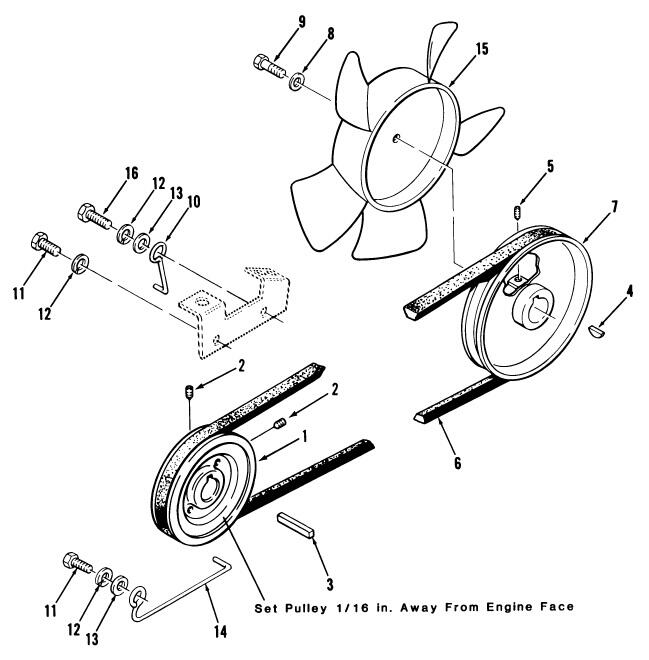

Should be adjusted so the guides are 5/32" away from the belt when the belt is tight.
Some service info in the 1986 illustrated parts ist.
Garry
