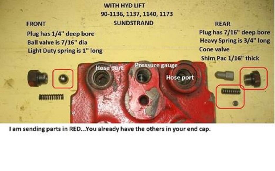

Did the donor tractor also have the Hydraulic Lift...?  If not, you are missing some parts ...I have them.
These parts are NLA from dealers...
email to me at:  daveoman@windstream.net

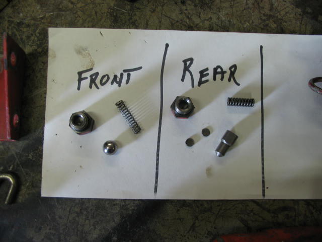

I believe some check valves need to be changed when the lift is added to a non-lift setup. Someone that knows more than me will reply.  The pieces you need are likely in the old unit.
Found this

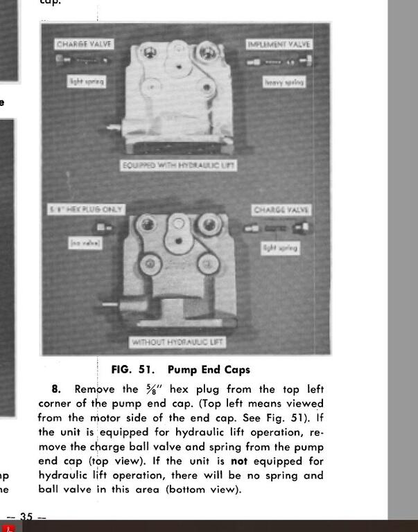

Look at the Sunstrand Manual in the manual section here.  you have to move stuff on a piston to piston unit when you add a lift.

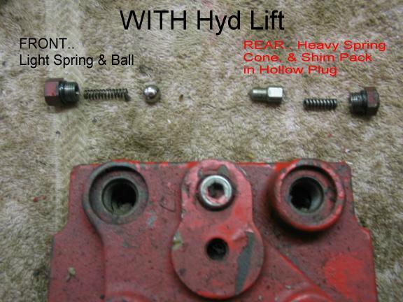

All you gotta do is take these parts from the Sundstrand unit that has the hyd lift and put them into the EXACT same ports of the replacement unit you have.  NOTE...  you have switch the HOLLOW plugs too...not just the internal spings and cone valves.  Put the SOLID plugs back into the donor tracotr

Okay I read over everything again! And I got it I didn’t use the same hollow nuts from rear to rear I just went and changed everything and I once again can lift everything! Thanks a lot guys for all the help!!
