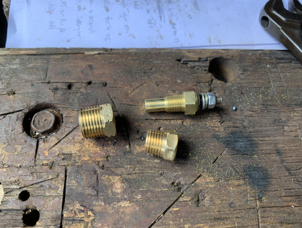

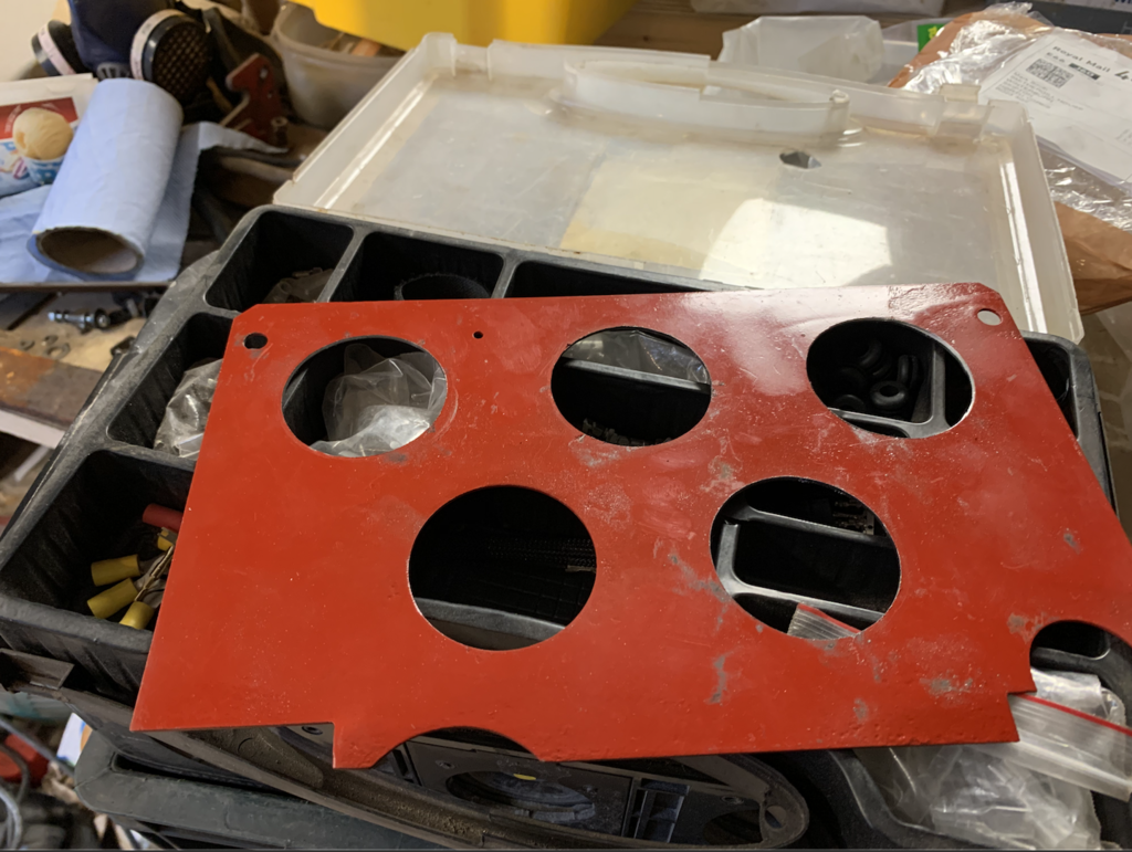

Slow progress... as I keep thinking of cool things to add...

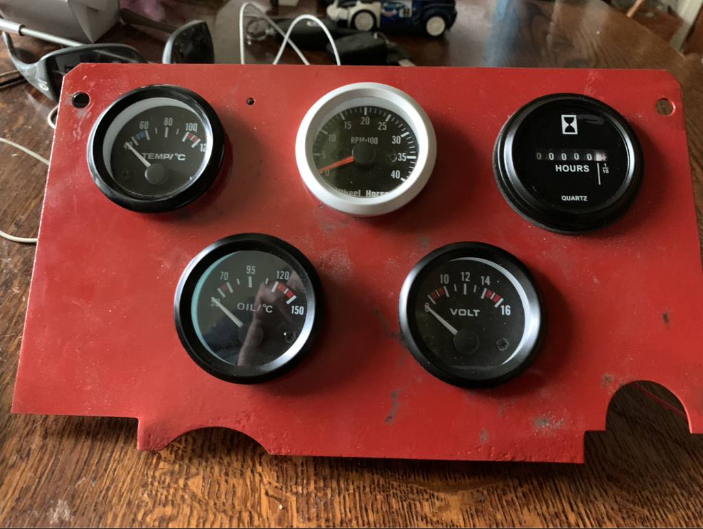

Moist of the wiring loom has been made - theres a few mods to be made to the original.
a few gauges to add
need to add an oil temp sender
without draining the fresh oil....
then all new crimps and wire
might get to start it again soon!  still waiting for fuel tap from China - as well as fuel tank sender....
Forgive my memory if you've already answered this...
What's the upper left temp gauge for?
Air or transmission?
meadowfield
ignore that - it was just filling a hole :D

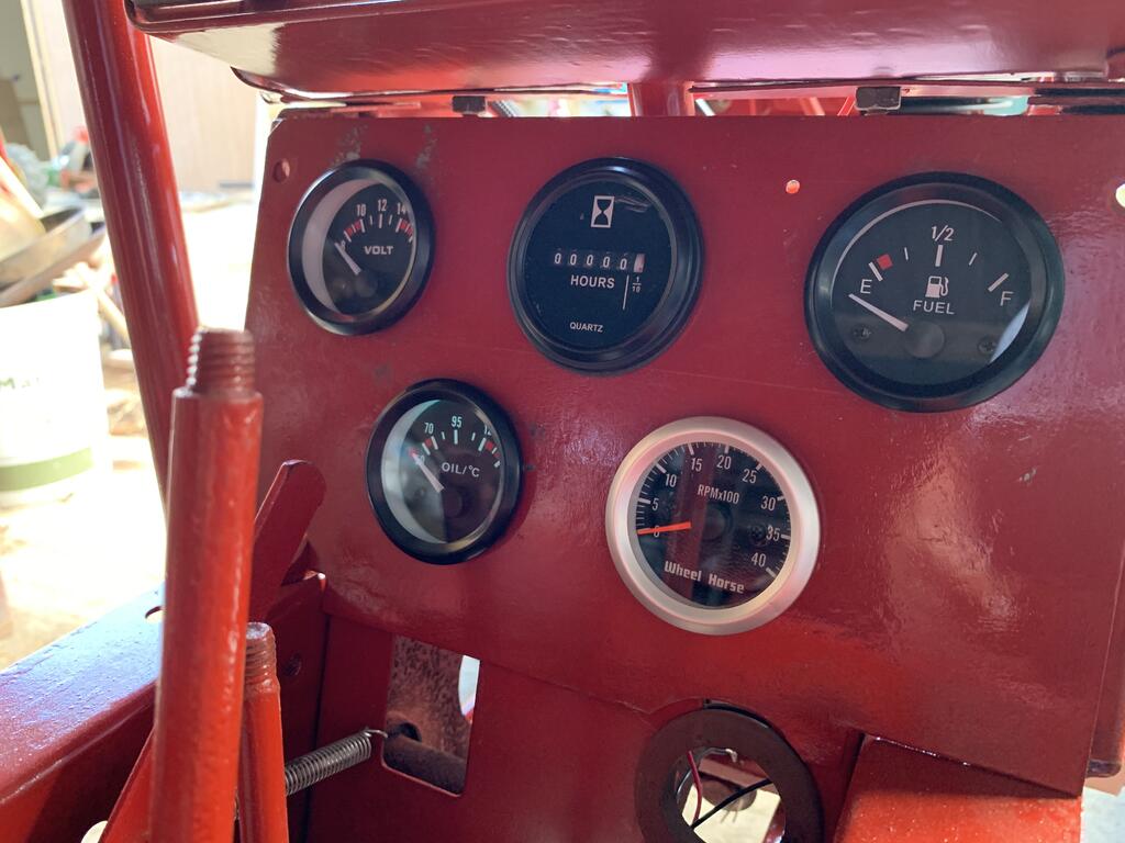

Fuel gauge arrived... so panel now looks like this.

after a lot of woes - I'll go into later, I think we are all good on the panel. I swapped the oil tempo gauge for a water temp gauge, the oil in the pan and block don't get that hot. Well I haven't managed to get it over 80 deg C - 175 in US money :D
Cheap chinese Voltage reg runs at just under 14.4V so good enough for me - cheap chinese hour counter appears to not work. Turns out I order a 12VDC one, this one says 110-240VAC, so not going to work.
Fuel gauge and sender working great, as is the tacho that I had modified 6 years ago and not found a use for...
