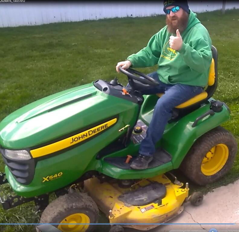

bottjernat1 2,190 #12 Posted May 7, 2020 LOL my deere has a locking dif see the orange pedal on the floor. it comes in handy. Share this post Link to post Share on other sites
Driver.Copeland.James 3 #13 Posted May 13, 2020 On 5/7/2020 at 9:53 AM, bottjernat1 said: LOL my deere has a locking dif see the orange pedal on the floor. it comes in handy. Sadly enough, I can't afford that green paint 😂😂😂 Share this post Link to post Share on other sites
