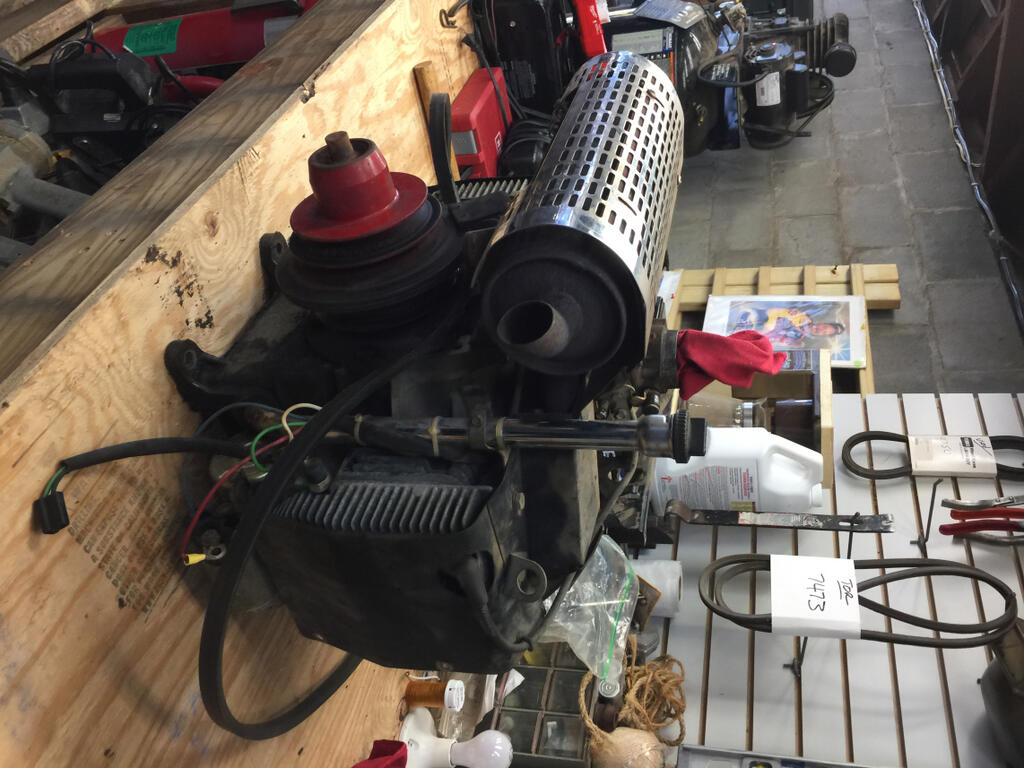

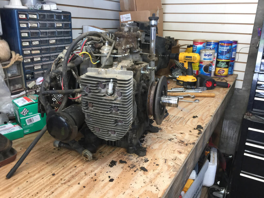

Anthony Wendover 124 #1 Posted May 6, 2020 I wasn't sure if i should put this with the 520 tractor rebuild thread im going to start but i figured best to separate the engine form the tractor. So this engine comes off a 1993 520H. It has 473 hours on it. It had a little oil leak in a couple spots so i wanted to take it off the tractor to clean it up. I also had to replace the stator as well as the rest of the electrical components on it. So as i dug into it i said why not just give it a refresh/rebuild. So over the last week i have stripped the engine to the block and the crank. ( did not have much luck pulling the crank gear ) so because everything there looked fine i left the crank in. Cleaned everything up, honed the cylinder walls and ordered my new parts. Thanks to ebay and onanparts.com the rebuild parts should be here by the end of the week. Doing new rods, pistons with rings, cam shaft bearing, valve springs, and all electrical components. One thing that i did notice on my engine was inside of the block. There are a couple chips out of the block around the piston bore. It looks like crappy casting or when the slid the sleeve into the bore? Has anyone else ever seen that inside of their onans? 4 3 Share this post Link to post Share on other sites

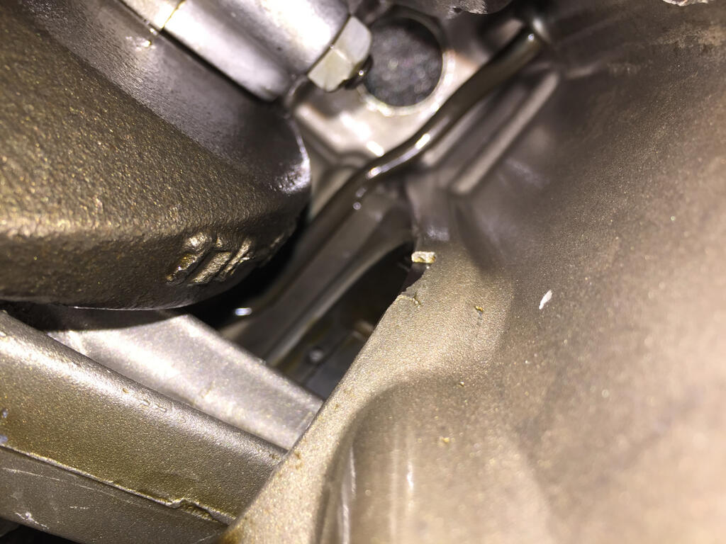

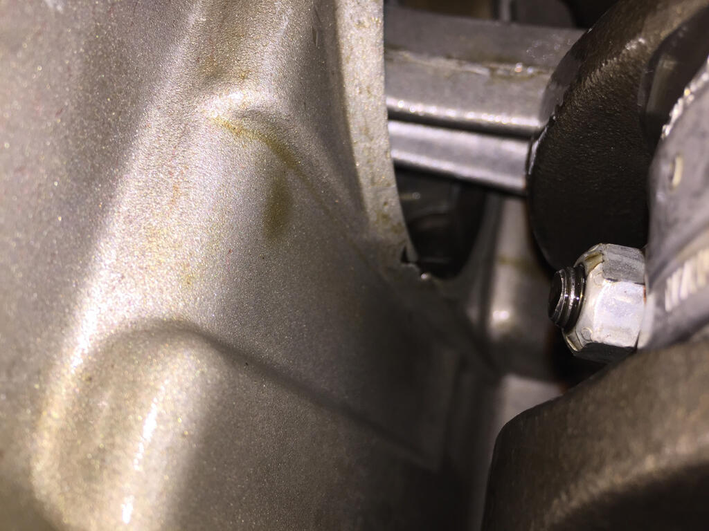

Anthony Wendover 124 #2 Posted May 6, 2020 Here are the pictures of the cracked missing piece i was talking about. 2 Share this post Link to post Share on other sites
WHX?? 49,666 #3 Posted May 6, 2020 Looks nice Anthony ...keep up the good work! Yes those cam gears can be stubborn. Somewhere here ther are some tricks to getting them off. Those must be just factory marks. 1 Share this post Link to post Share on other sites

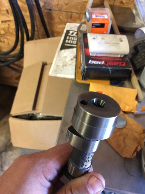

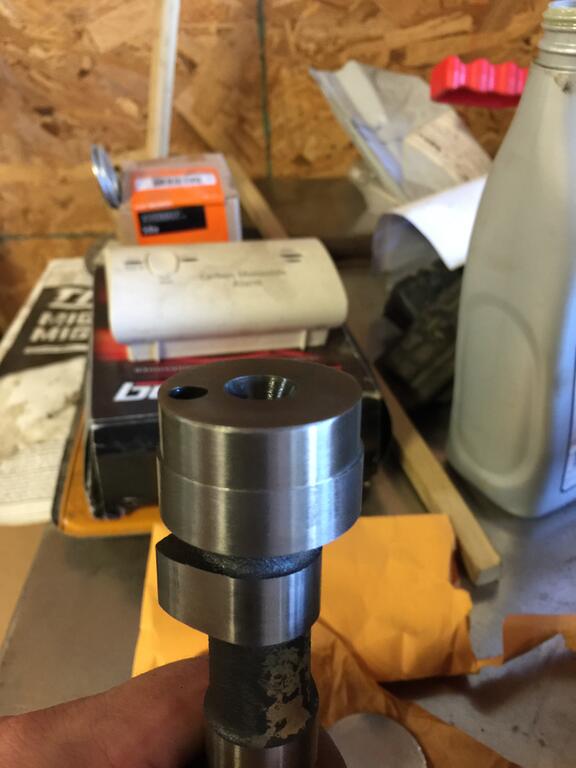

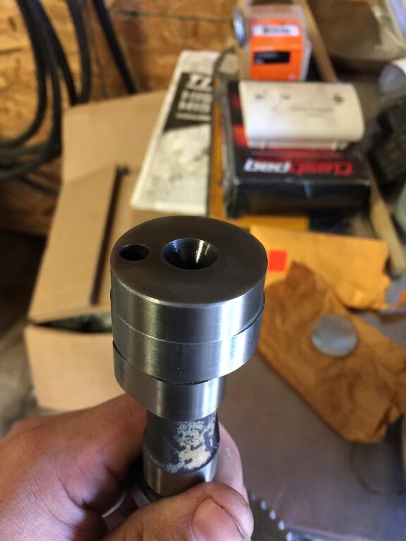

Anthony Wendover 124 #15 Posted May 16, 2020 (edited) Guys is my cam worn down? It looks funny but not sure if this is normal or not? its shocking it’s so worn down in that short of hours. What are suggestions to fix it? Replace it or weld and then turn it down on a lath? It also doesn’t fit through the new cam bearing anymore it’s super super tight and gets stuck. Edited May 16, 2020 by Anthony Wendover Share this post Link to post Share on other sites
lynnmor 7,451 #16 Posted May 17, 2020 How does it compare with this one on eBay? Cam Share this post Link to post Share on other sites
Anthony Wendover 124 #17 Posted May 17, 2020 The one on ebay looks a lot more worn and more even. mine is worn down egg shaped Share this post Link to post Share on other sites
lynnmor 7,451 #18 Posted May 17, 2020 Older Onan engines had points, maybe you are looking at the cam area that operated the points push rod if it were used in an older engine. 1 Share this post Link to post Share on other sites
Anthony Wendover 124 #19 Posted May 17, 2020 i dont think it is that because the cambearing on PTO side was also worn down on the inside edge. I just dont know if i can reuse this as is or replace it.. Hopefully someone out there knows.. a new one from toro is over 500 Share this post Link to post Share on other sites
tom2p 2,394 #20 Posted May 17, 2020 32 minutes ago, Anthony Wendover said: i dont think it is that because the cambearing on PTO side was also worn down on the inside edge. I just dont know if i can reuse this as is or replace it.. Hopefully someone out there knows.. a new one from toro is over 500 ouch that's approaching the cost of a camshaft in a $50K 900hp sprint car engine Share this post Link to post Share on other sites
onanparts.com 181 #21 Posted May 17, 2020 14 hours ago, lynnmor said: Older Onan engines had points, maybe you are looking at the cam area that operated the points push rod if it were used in an older engine. ^^^^^^^^^^^^^^^^^^^^^^^^^^^^^^^^^ Cam is fine. Lynnmor nailed it. Same one is used for both points and electronic ignitions. If a cam bearing is damaged during install or when removing the cam, the cam will not be happy about going in or out of the block. Very tight cam bearing clearance. 0.0015-0.0030 it does not take much to upset that clearance. Buggered up or distorted it's a no go situation. Bearings should be pressed or pulled in gently, never driven in. Heat block, chill bearings, press in. Very little resistance in the process. 1 1 Share this post Link to post Share on other sites
Anthony Wendover 124 #22 Posted May 18, 2020 Thank you for that reassuring and excellent news!! I’ll put it back together sometime this week. Glad to know that the end of the fam is suppose to be a bit egg shaped. Out of curiosity do you have the onan part number for a new cam? I know toro wants a crap ton but I find everything is so much cheaper using a onan part number. If I can find one I’d put it on my shelf as a just Incase. Thank you!! 1 Share this post Link to post Share on other sites
onanparts.com 181 #23 Posted May 18, 2020 15 hours ago, Anthony Wendover said: Thank you for that reassuring and excellent news!! I’ll put it back together sometime this week. Glad to know that the end of the fam is suppose to be a bit egg shaped. Out of curiosity do you have the onan part number for a new cam? I know toro wants a crap ton but I find everything is so much cheaper using a onan part number. If I can find one I’d put it on my shelf as a just Incase. Thank you!! New cams discontinued, P216, P218 & P220. No need to have one on the shelf. When you get North of say 10,000 hours maybe. Onan cams have no history of flat lobes or abnormal wear. If the need ever did arise to replace one there are thousands of used cams in near perfect condition out there. You do not have a disposable cheap Chinese toy motor. Briggs, Kohler V-Twins etc. Odds are very high if you had just serviced it properly it would have outlasted you as is. But since you are resetting the clock to zero, peace of mind does of course have a high value! When the clock gets to around 2500-3000 hours, then it will be time to open it back up for another total look see/inspection/refresh. 2 Share this post Link to post Share on other sites
Anthony Wendover 124 #24 Posted June 2, 2020 So update guys. This thing is starting to go back together the last couple days. Pistons are in along with the camshaft. Had to lightly sand down the ends of the camshaft with very fine grit emery cloth to get it to slide into the new bearings. So far this thing is super tight! Getting the valves in today and then start going over everything. Should be ready to fire in a couple of days time! 3 Share this post Link to post Share on other sites
