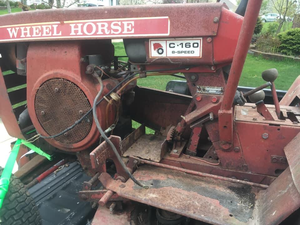

First post, so a little background. Last July, after a little research, I ditched my plan of buying a big box tractor and found a really nice condition C-160 automatic for sale here in Michigan. Great back story - original owner family, original manuals, and a hand-written note he had left for his wife before he died telling her how to start and run the tractor. She did use it for a few years, but was officially retiring from mowing, and I bought it from a friend of their family. Under 200 hours on the gauge, but it was inoperable and probably had been for a long time.  Came with a decent 48 inch deck, grader blade, snow blower, tiller, and a sweeper and a thatcher that were both third-party.

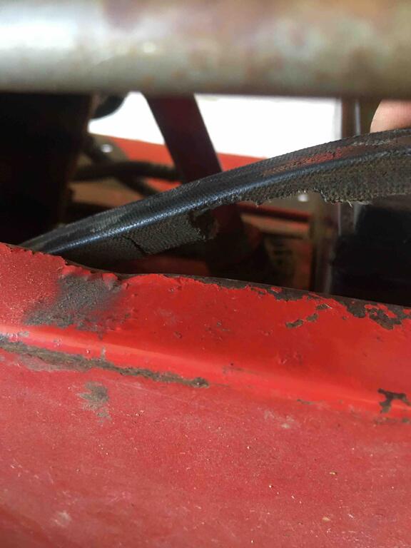

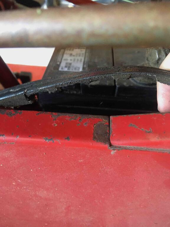

My plan this weekend was to attach the tiller for the first time and break ground for a good-sized garden. I get the tiller lined up and attached to the rear hitch, run the cable from the tiller to the mid-point attachment, and turn on the tractor. Turns over fine, runs fine. I chock the wheels, and drop the parking brake so that I can use the hydro to raise the tractor, and as soon as I drop the parking break, there's an unusual sound and vibration. I raise the tiller, and the sound gets worse. The source of the vibration appears to be the parking brake itself, which makes no sense, but then when I look closer, I can see the drive belt is not running correctly. I turn it off, put the brake back on, and examine the belt.  It's chopped to hell.  It's not all that loose, but it's clearly damaged.
At this point, I know: (1) I'm not tilling today; and (2) I'm coming here to ask for some advice.
I turn it on once more to lower the tiller and take the video below.  As I'm taking the video, the belt appears to get even looser and vibrate more.  Once I shut it down, I examine the belt further, and it's clearly right on the brink of failure. I think if I ran it for even a few more minutes, it would have gone.  Oddly enough, I was only able to find one small piece of belt debris under the tractor (and I looked pretty hard).

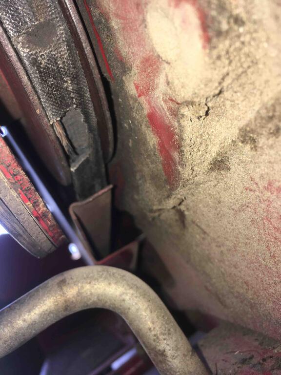

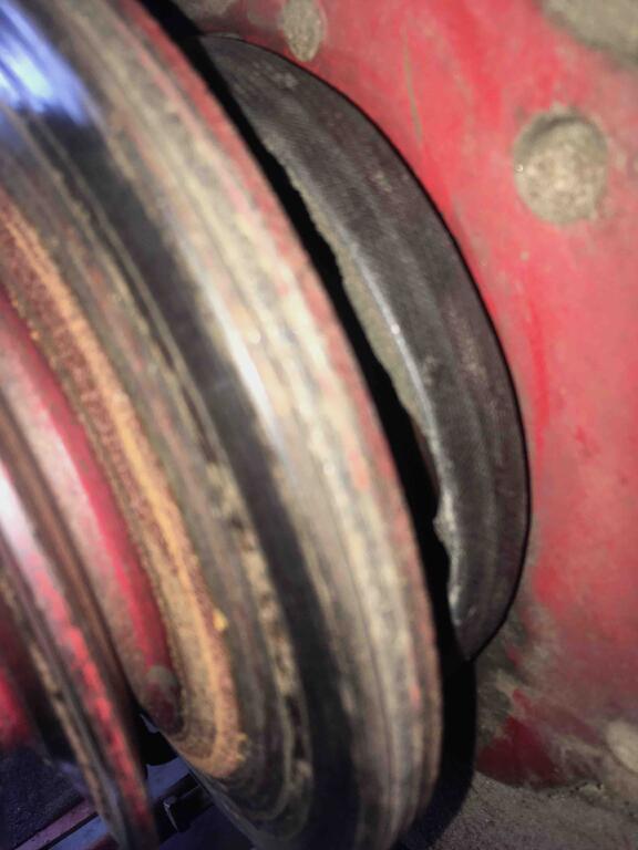

A few shots of the belt.

Remove the belt guard and changing the belt is almost self explanatory plus we can help with any questions or guidance. No need to pay anyone to do it and the more familiar you get with maintenance on your machine the beter off you are.
The missing pieces of the belt is what's causing all that jumping around of it. The missing pieces will also make the belt looser around the pulleys.
One thing to check and inspect while you are in there changing the belt is the idler pulley which tensions the belt. It's a common problem for the bearings in that pulley to wear out over 50 years. Look for anything which could be rubbing the belt too.

When you get the belt guard off, be sure to check all the Vee pulleys for damage and/or pieces of the old belt wedged in the bottom of the Vee grooves.

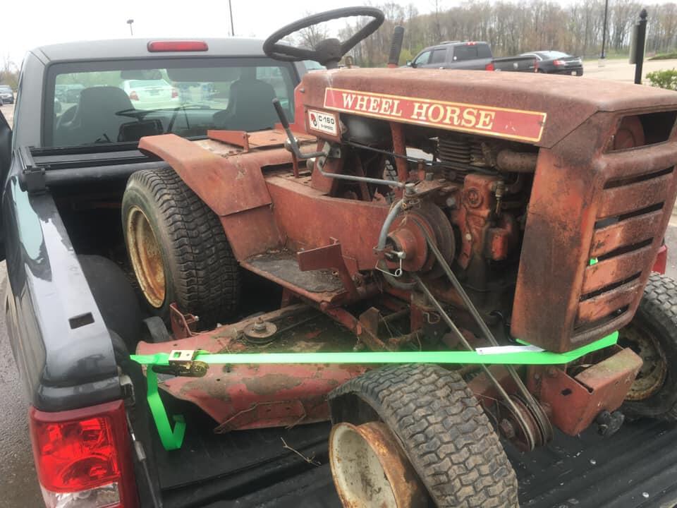

ondeadlin
I found a replacement belt.
(Just joking, I ordered the belt ... but then this guy came up for sale locally and the price was just too good to say no to).

Thanks, it was luck. Was looking on Craigslist to see if anyone was parting out a deck. Hadn't looked at Craigslist in weeks. Was just listed today, so I jumped on it. I figured at worst, it would be good for parts, and it came with a deck. Deck turned, engine was loose. Not sure what I'll do with it, but it'll probably start with seeing just what shape the deck is in. If it's usable, I'd like to do some work on my current deck, so I'll take that out of service.
