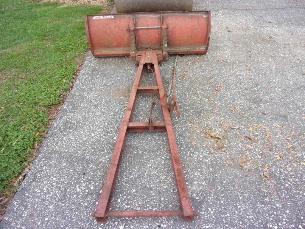

This is a short frame plow.  Note the VEE shape from front to rear.

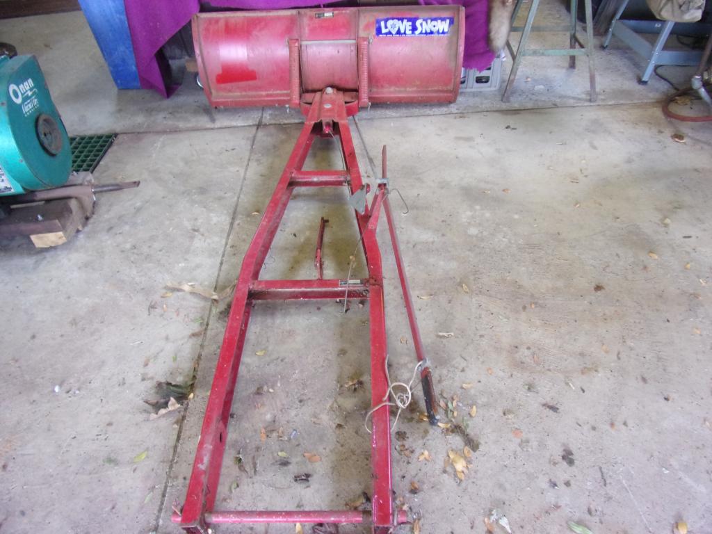

This is the long frame plow that you need for your 314-8.     Note the parallel frame rails.
If it's a Long Frame it should fit fine but there wasn't a 48 available in 68 that I know of.
