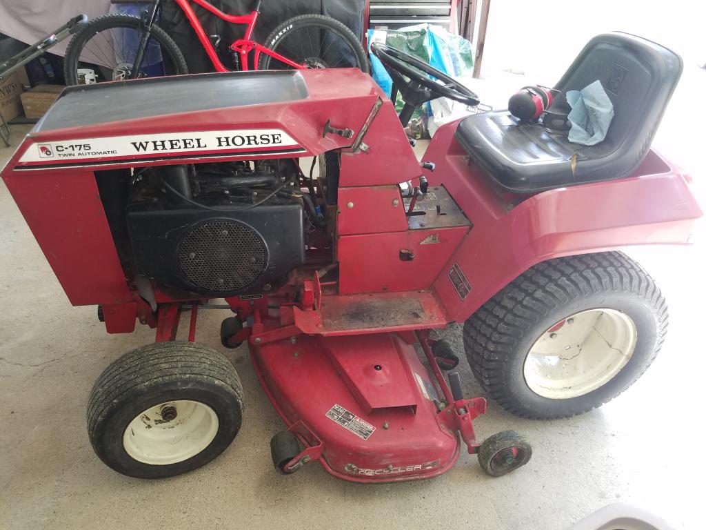

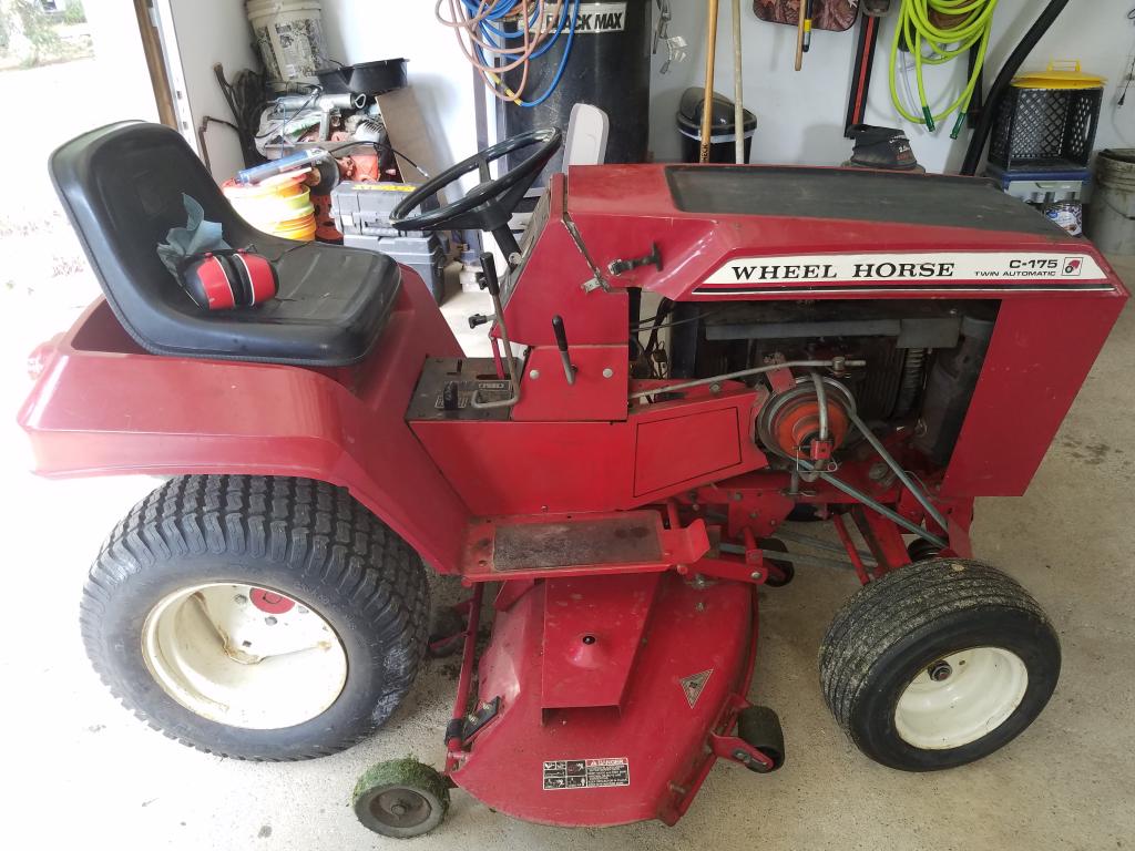

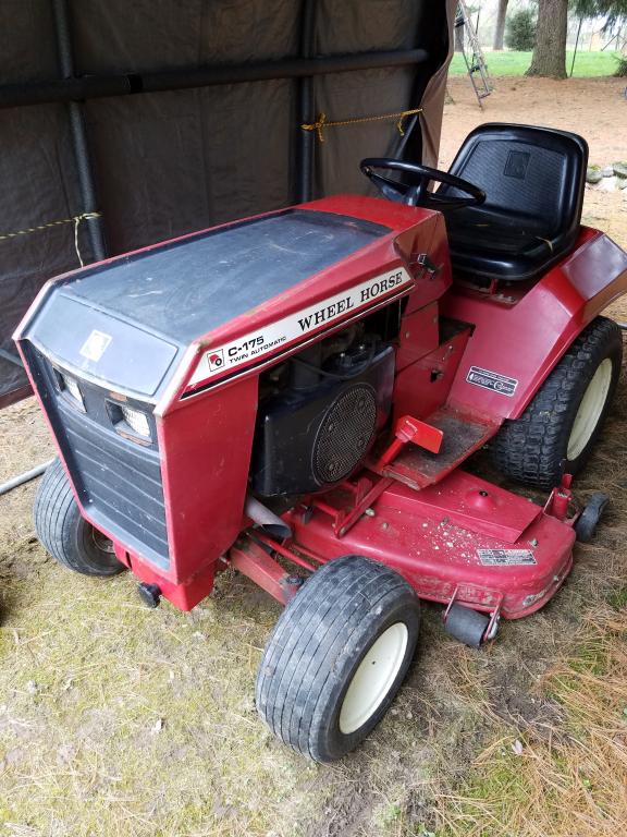

CHUCKBORDNER@GMAIL.COM 14 #1 Posted April 30, 2020 Ok guys, the tractor has been getting a fair amount of my time. I plan on working it this summer so quite a few things needed to be done to ready it. Replaced the axle seals last week, installed a new PTO drive belt for the mower deck & fluid changes. The deck mows well but I will be replacing the belt driving the spindles. Installed a pair ofcdeck support wheels and a new gas cap/ fuel gauge assm. As promised, here are a couple pics of it, pretty much as I bought it. 7 3 Share this post Link to post Share on other sites

c-series don 9,258 #3 Posted April 30, 2020 That’s a series one Kohler so if you’re going to run it on hilly terrain it’s recommended that you run it slightly over full on oil. Nice tractor! Welcome to Red Square! 2 Share this post Link to post Share on other sites
Tuneup 1,433 #4 Posted May 1, 2020 Hard to find one of those fiberglass fenders in such good shape. Nice machine! 1 Share this post Link to post Share on other sites
Zeek 2,286 #5 Posted May 1, 2020 That is in great shape, wish I had it! Share this post Link to post Share on other sites

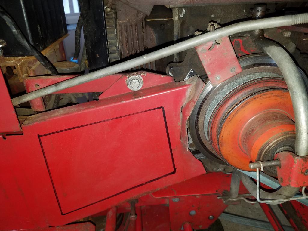

CHUCKBORDNER@GMAIL.COM 14 #6 Posted May 1, 2020 I marked out an area to be cut out on the right side panel cover for the hydro belt. I saw one of the posts on this site where an owner did that to his. The hole created with be covered with expanded metal screen IF there is determined to be no interference with the belt. Recently, I noticed various areas of belt polishing on the interior side of the cover but did not take the time to compare them to the intended work area. By the way, thanks for the supportive comments you guys gave along the way so far. I will seek advice periodically as I understand the abundance of experience and insight that this site offers. Chuck Share this post Link to post Share on other sites
