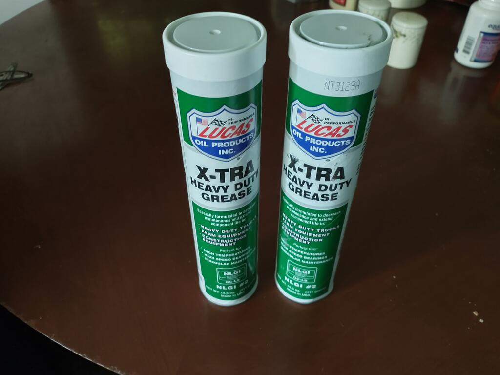

squonk 42,400 #5906 Posted July 17, 2023 Got these in the mail today. $13 ea. 5 3 Share this post Link to post Share on other sites

19richie66 17,560 #5908 Posted July 18, 2023 9 hours ago, squonk said: Got these in the mail today. $13 ea. You’re now in the Lubrication Hall of Fame. 😁 4 Share this post Link to post Share on other sites

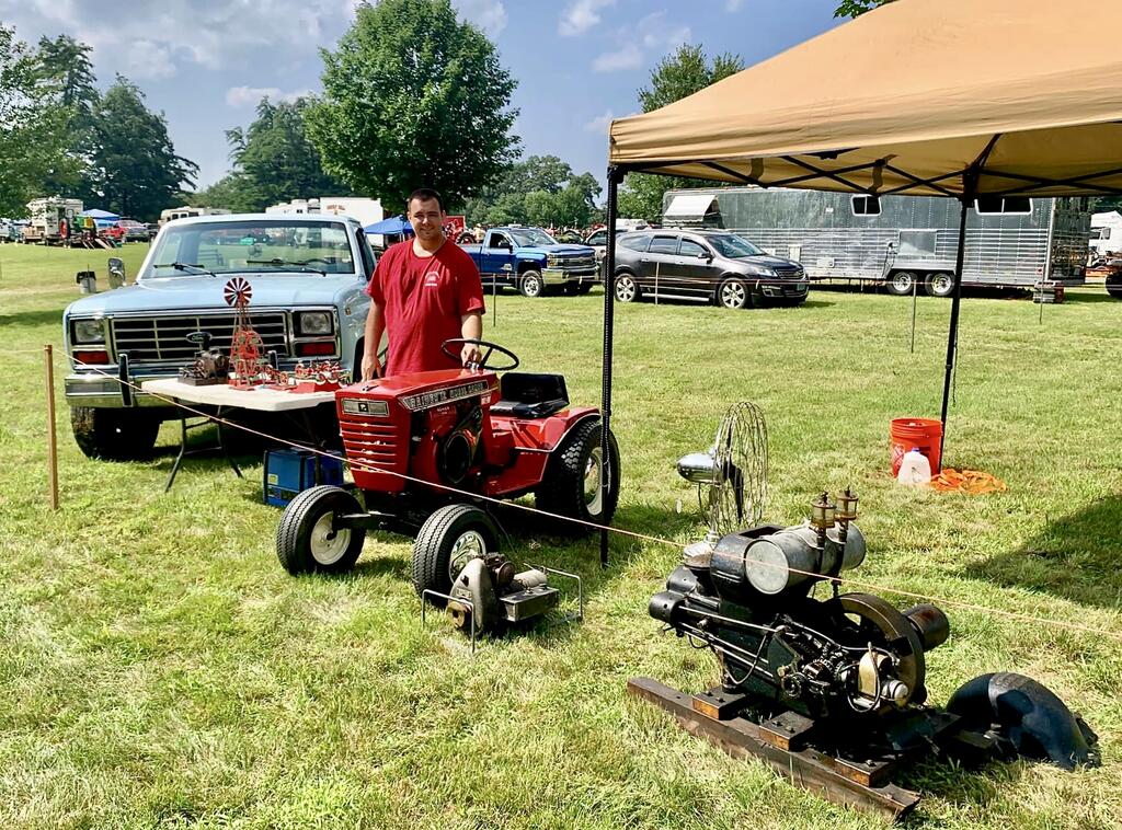

Stepney 2,343 #5917 Posted July 30, 2023 Old girl finally made her first show. Sad lack of WH's this year at Eliot, lack of attendees in general as all shows are nowadays. A good time overall though. Ice cream was made via Clinton engine and the little Horse belt started a dead John Deere LA so that was fun. 7 Share this post Link to post Share on other sites

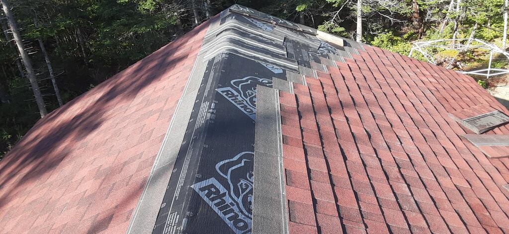

Oldskool 6,660 #5919 Posted July 30, 2023 Here is today's project. Finishing the roof on camp. Camp has consumed most of my time for a few months now. It's finally to the point I can take some time to get back to tractors. 3 4 1 Share this post Link to post Share on other sites

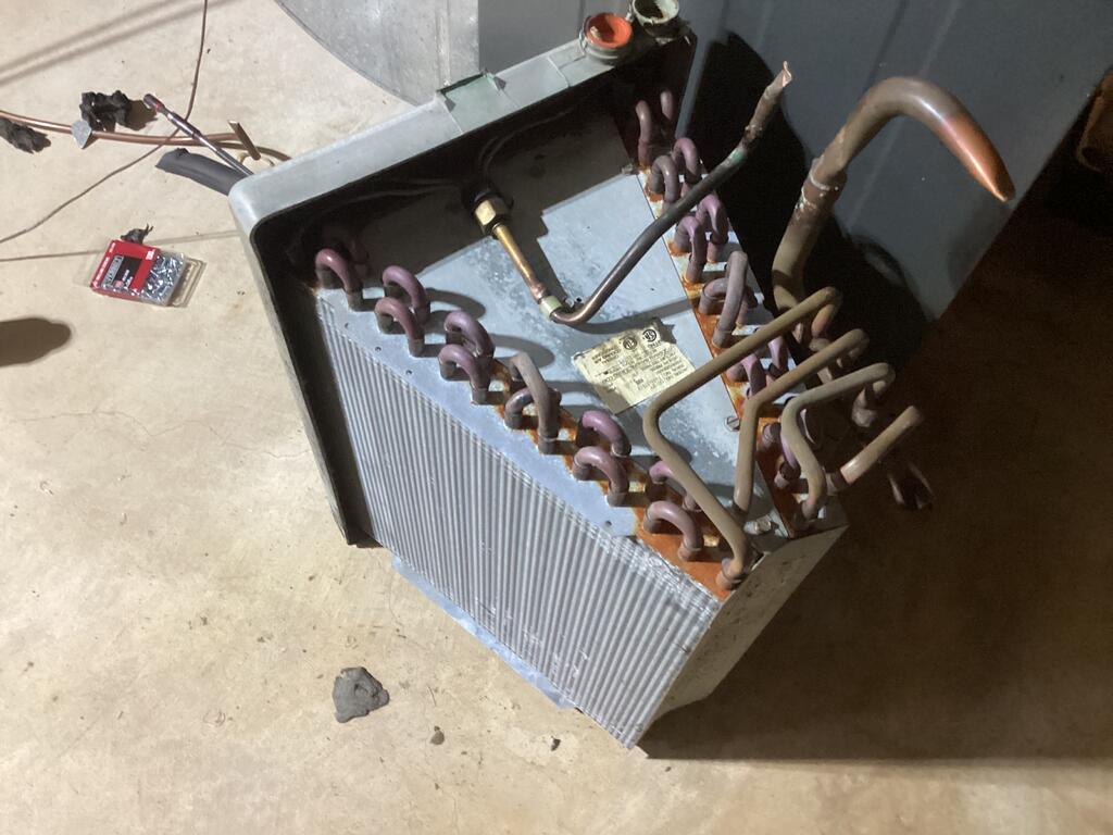

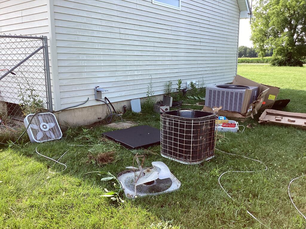

Pullstart 64,396 #5920 Posted July 31, 2023 I sure could use a farm hand some days! Straightening, then pulling the new 3/4” insulated line set kind of sucks! Our old A/C has been on limp mode for far too long. The fan seized up about a year or so ago and a cheap box fan has been plugged in sucking the heat out ever since. When playing with heat transfer, surface area is king. This new condenser is HUGE! Went with a piston coil for the furnace plenum and a new line set for the 410A system. 4 Share this post Link to post Share on other sites
WHX?? 50,580 #5921 Posted July 31, 2023 (edited) 39 minutes ago, Pullstart said: Straightening, then pulling the new 3/4” insulated line set kind of sucks! Your not doing it right then. Unroll the whole thing out on the lawn. Both lines then black tape them together along with the low voltage wire. Only at the end so you can separate them in the basement. Then feed the whole thing in. Helps if one of the girls feeds it in while your in the basement routing it. 39 minutes ago, Pullstart said: This new condenser is HUGE! It's to get the efficiency mandated by Uncle Sam. 20 seer + units are monsters. Personally I would have replaced the old fan motor and ran it like I stole it. New stuff is all junk. Some new stuff is just better junk than others. They all come with the stupid hail guards that do nothing but trap dirt in. You will have to take it apart yearly to clean. Looks like a gorilla had his way with the box! Edited July 31, 2023 by WHX?? 1 Share this post Link to post Share on other sites
Pullstart 64,396 #5922 Posted July 31, 2023 45 minutes ago, WHX?? said: Looks like a gorilla had his way with the box! Geese tore that up as soon as it was off the truck! 45 minutes ago, WHX?? said: Unroll the whole thing out on the lawn. Both lines then black tape them together along with the low voltage wire. Only at the end so you can separate them in the basement. Now you tell me! 2 Share this post Link to post Share on other sites
Handy Don 13,290 #5923 Posted July 31, 2023 1 hour ago, Pullstart said: Straightening, then pulling the new 3/4” insulated line set kind of sucks! 49 minutes ago, WHX?? said: Unroll the whole thing out on the lawn. Both lines then black tape them together along with the low voltage wire. This is why I was glad our replacement didn’t need new connection pipe. 😁 The original install was of heavy wall tubing so still usable with new fittings at the ends. 1 Share this post Link to post Share on other sites
elcamino/wheelhorse 9,360 #5924 Posted July 31, 2023 @Pullstart and @WHX?? Looks like Fred Sandford's backyard afterwards. 5 Share this post Link to post Share on other sites
lynnmor 7,550 #5925 Posted July 31, 2023 2 hours ago, WHX?? said: It's to get the efficiency mandated by Uncle Sam. 20 seer + units are monsters. Personally I would have replaced the old fan motor and ran it like I stole it. New stuff is all junk. Some new stuff is just better junk than others. They all come with the stupid hail guards that do nothing but trap dirt in. You will have to take it apart yearly to clean. Looks like a gorilla had his way with the box! I just installed a 20.5 and it isn't much larger than the old one in length and width, the height is much shorter. What I hate about the new high efficiency models is the coils wrapping completely around unlike the good old days when you could take off a side panel with twos screws and give the inside a thorough cleaning. It appears that I would need to forcibly remove the fan with related guts to even have a chance of removing debris. Perhaps we are to cut down all vegetation within a mile. I did just get my $500 rebate from the electric company for installing the high efficiency made in China model. 1 1 Share this post Link to post Share on other sites
