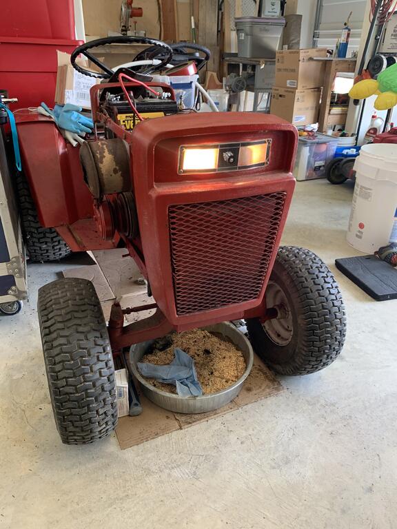

Jhensley87
Up and running!! Thanks to all who chimed in. The points conversion was quite simple. After draining the old gas and cycling some new in, the old horse is running smooth!! Thanks again. Wish I could upload a video, but it seems they’re too large of a file.
Jhensley87
Also, even the lights are good to go! Anybody know where I could find the head light cover? Not thinking there’s any NOS, but possible someone with one that’s not cracked.
